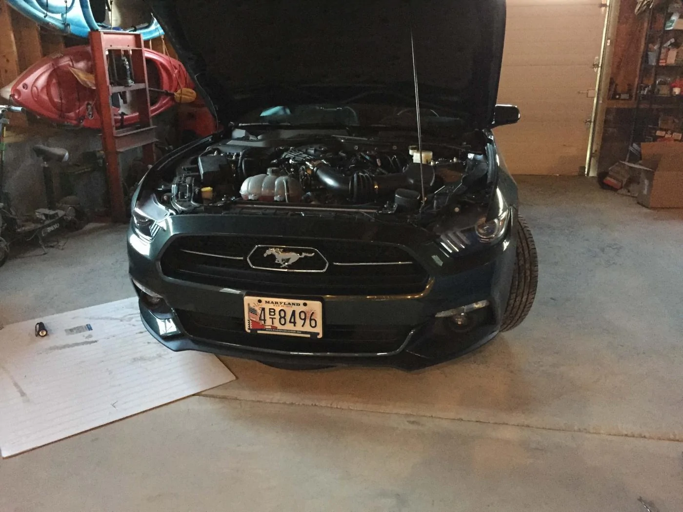

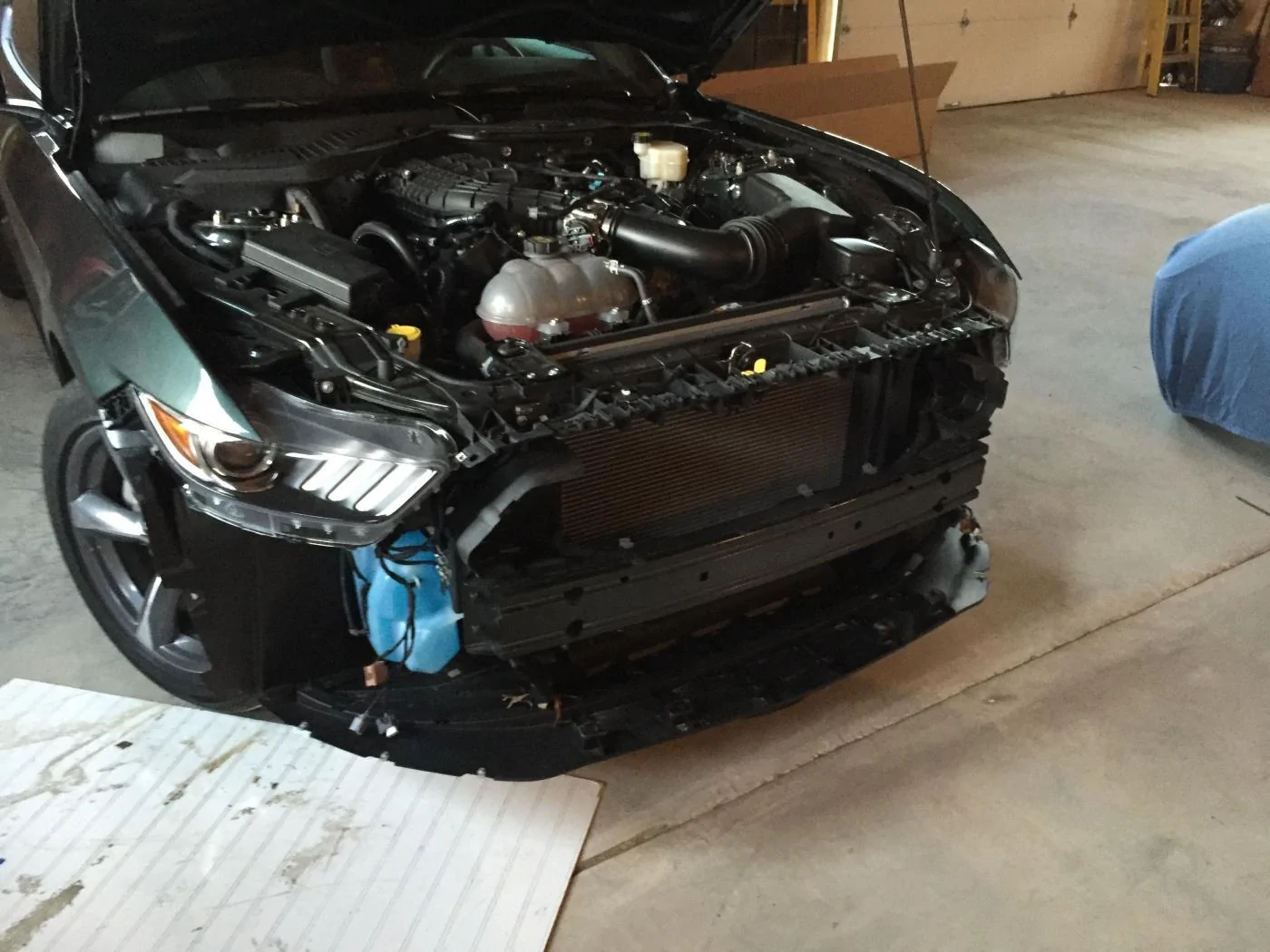

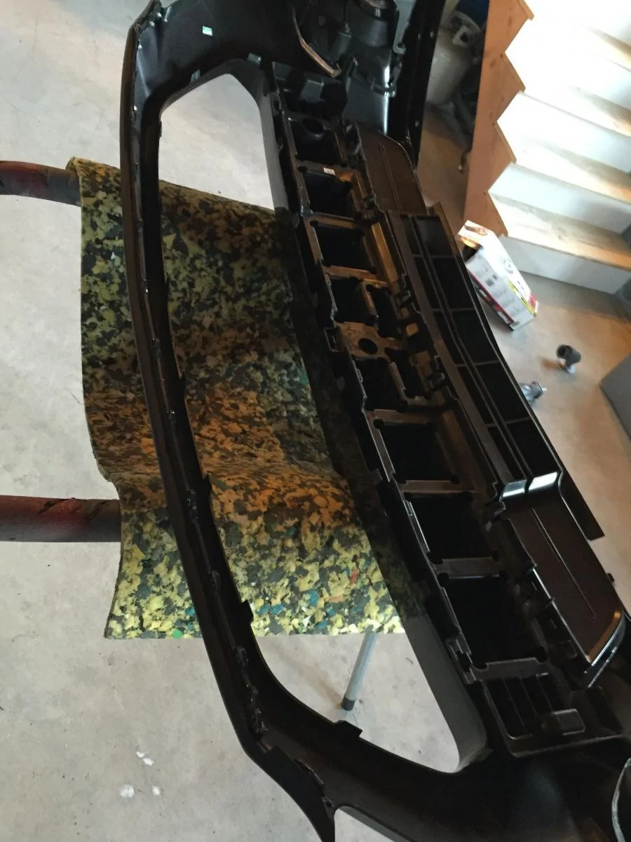

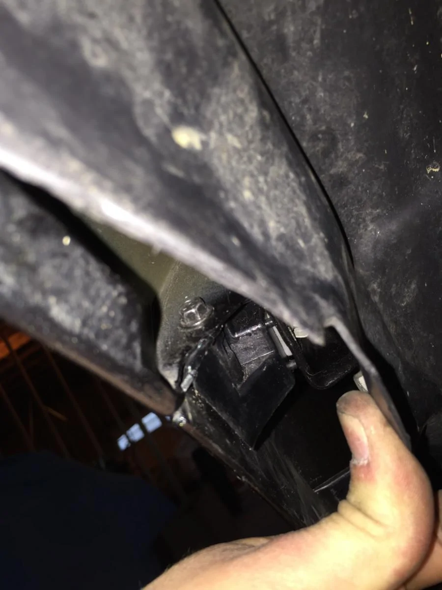

So this happened today! Bought the grille through my local dealership's parts department. Having friends there really helps! You must remove the bumper to install but the removal process is pretty straight forward. Follow Mishimoto's video to installing their oil cooler for bumper removal. There was one big omission from the video that you need to be aware of. On either side where the bumper meets the fender there is a 7mm bolt that must be removed in order to remove the bumper. This bolt is behind the splash shield which makes it a bit tricky to remove but not impossible. Other then that their video is pretty spot on. Pictures of the install below.

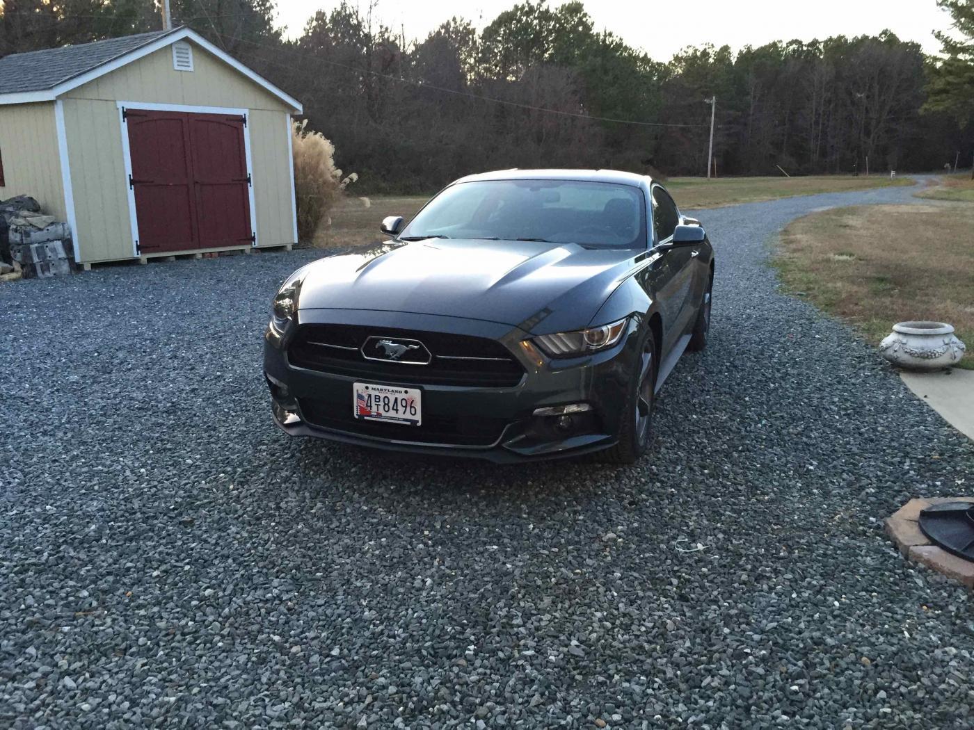

I can't say exactly how much it cost for obvious reasons.. What I can say is that it I did not pay list price for it. The full part number for the grille I ordered is below.
Full Part Number: FR3Z-8200-DA
It is amazing just how much this grille changes the front of the car. I was not expecting it to look THIS good. If anyone is considering this... It is well worth it!
