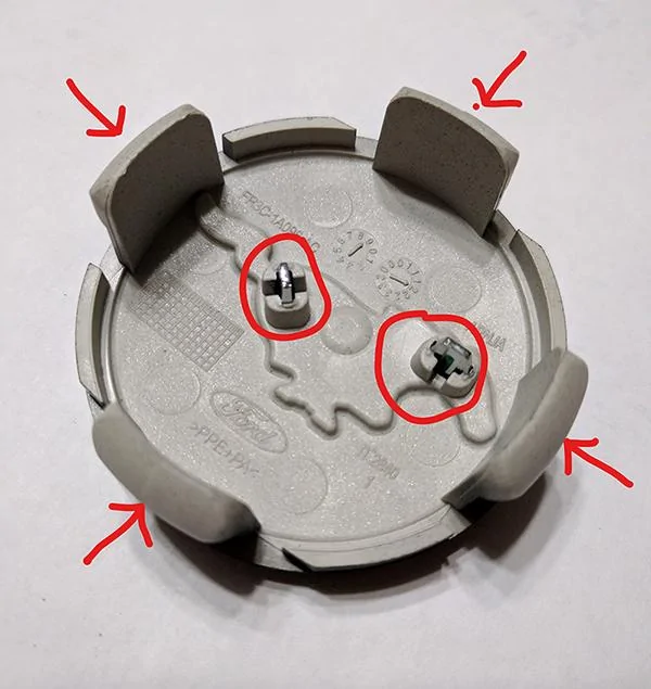

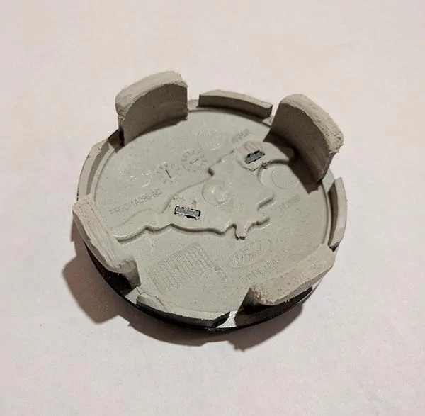

I was able to make the factory Pony center caps fit the front wheels with little modifications (GT w/ PP for reference). Cut the tabs off flush holding the Pony on; I glued it back on with super glue. Then shaved 1/16-1/8" off the clips. It sits flush now no problem.

I replied to your private message. But I'll answer here for the benefit of others.
No I didn't add any tape. They fit tight enough for me. In fact it was quite difficult getting them pushed into the hole. Had to use a plastic pry tool to push in one of some of the tabs. Once they were in, they didn't spin.

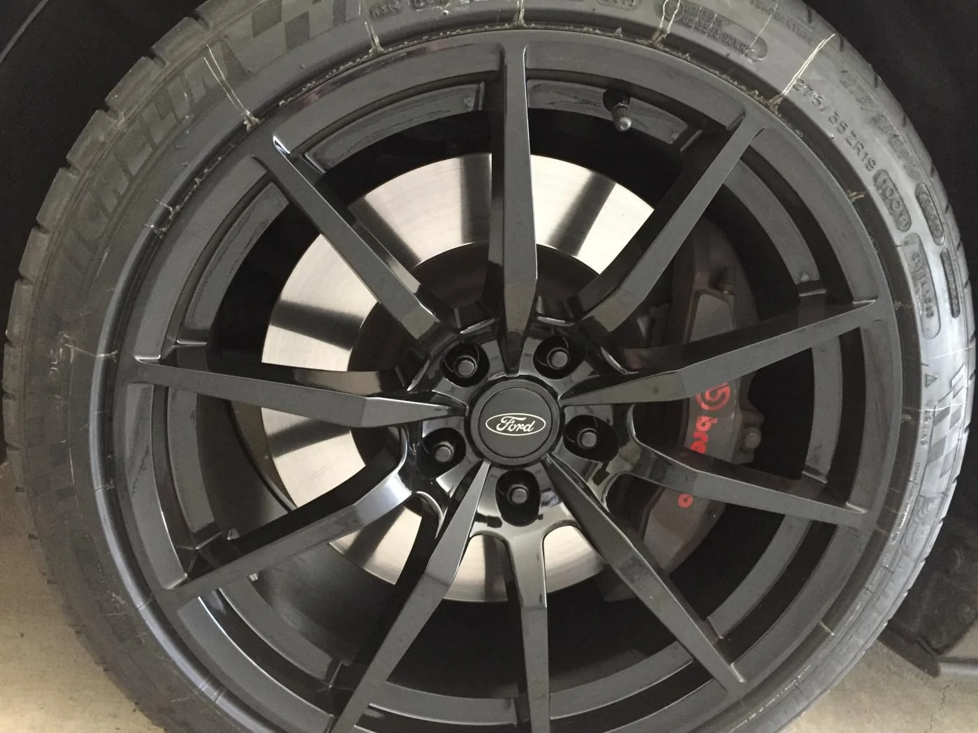

Or you could use the GT350 caps with no modification needed. Excuse the dirty tires and brake caliper. This was taken just after they were installed.
$12 a piece and free shipping. They are satin black and not gloss, but they blend very well and I would imagine a little shiny applicant of some type would do the trick if they bother you.
