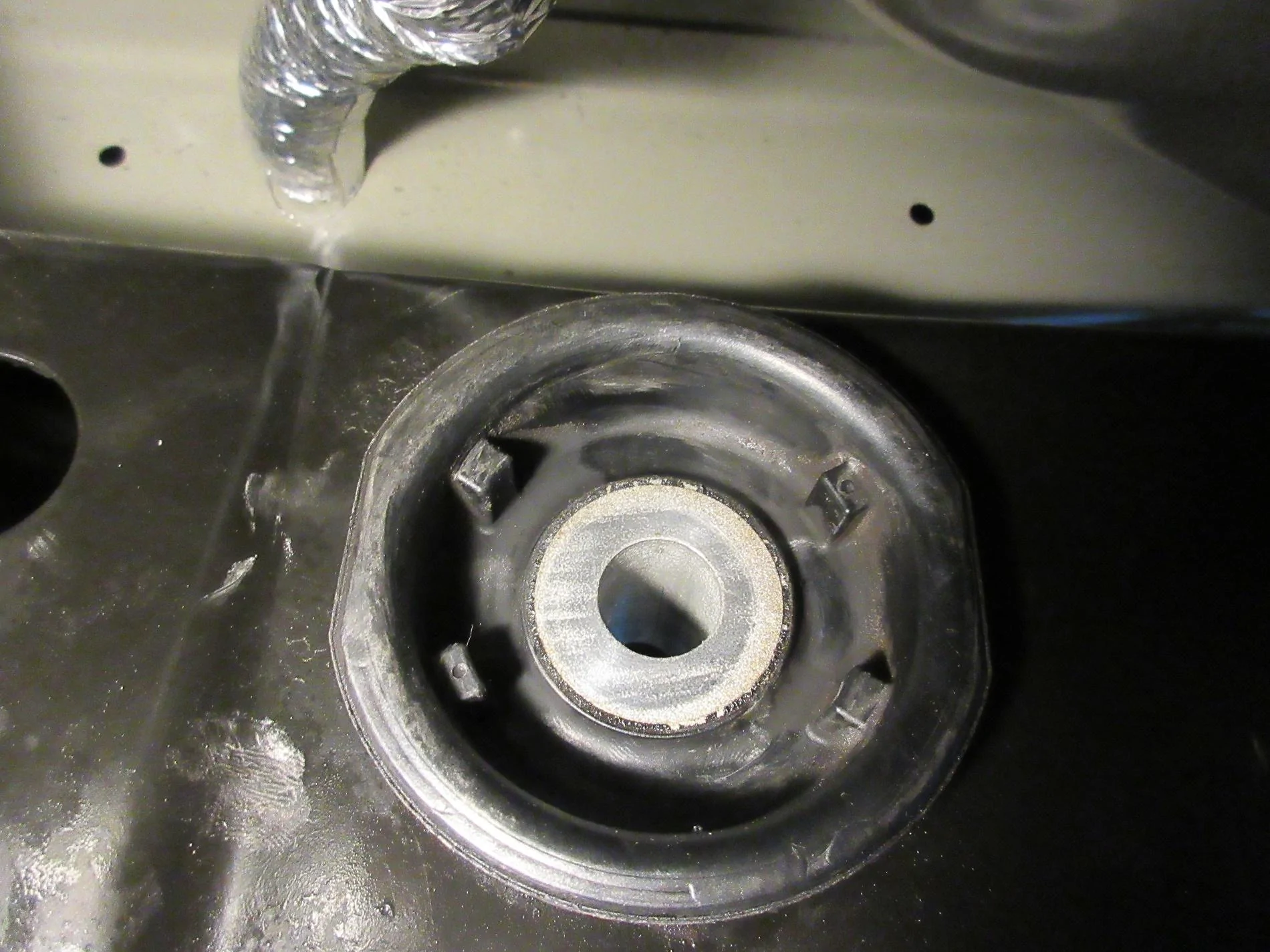

During the install, doing the bushing inserts, I first ran into a problem with the driver-side, front bushing. Following the instructions, the inserts slides in fine, but the cradle didn't lower far enough (for me) to even get the bolt in the hole. I had to disconnect the driveshaft from the differential (thanks American Muscle install video) in order for the cradle to drop all the way. Second hiccup was on the driver-side, rear bushing. For what ever reason, the stock bushing/bushing surround was smaller in diameter than the other 3... So the insert wouldn't just slide in. After multiple dremel sessions and test fits, about 1/16-3/32 of an inch off the diameter, the insert finally fit.

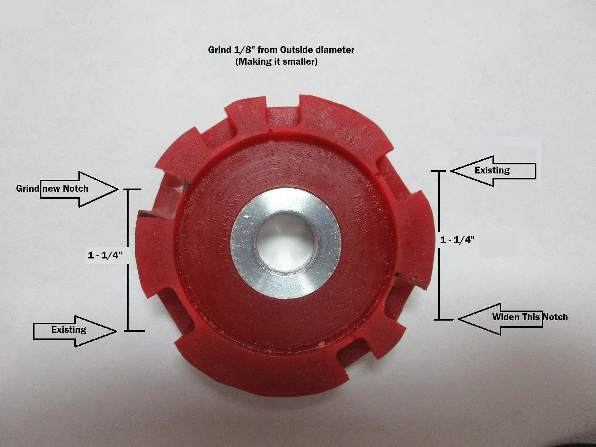

I too took advantage of lethal Performance sale. I purchased the BMR BK051 diff bushing lockout kit, and the Lethal Performance Extreme bolt kit: LP-550179. The Left Rear (Drivers Side) diff bushing on the GT350 is different. It is slightly smaller (-Where the poly bushing fits in) than the other three. And to best explain it, It has a different pattern for the 4 square nubs (Where the poly bushing fits in). The nubs are more like a (8 - 10 o'clock, and a 2 - 4 o'clock pattern) - Any pattern on the Poly bushings do not fit it.
I provided picture of what modifications were needed on one of the Red Poly Bushings to make it fit
