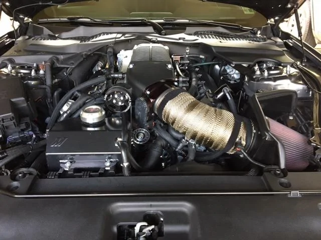

I have the Cervinis Ram Air hood and just installed their ram air duct. Before install my IAT1 stayed around 5-6 above ambient when cruising, after install they are staying around 2-3 above ambient when cruising.
I then wrapped my intake tube with carbon fiber heat wrap and that seems to help my IATs when not cruising. Not a real big difference but they do climb slower now and they haven't gotten as high since install. I have the open box so I did not insulate it.

Looks like we had the same idea:thumbsup:
