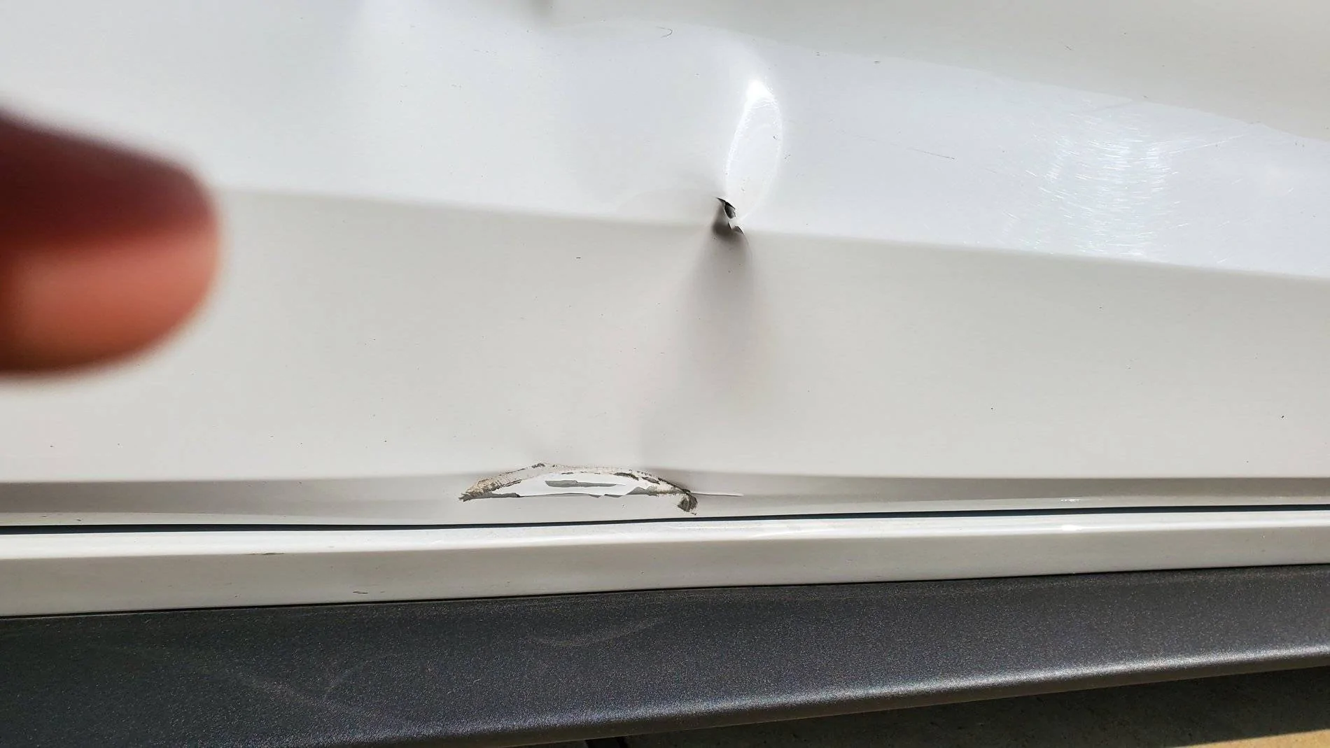

Can this stripe be removed ? Looks like from dealer or factor . Need a replacement door but I dont want this door stripe on it.

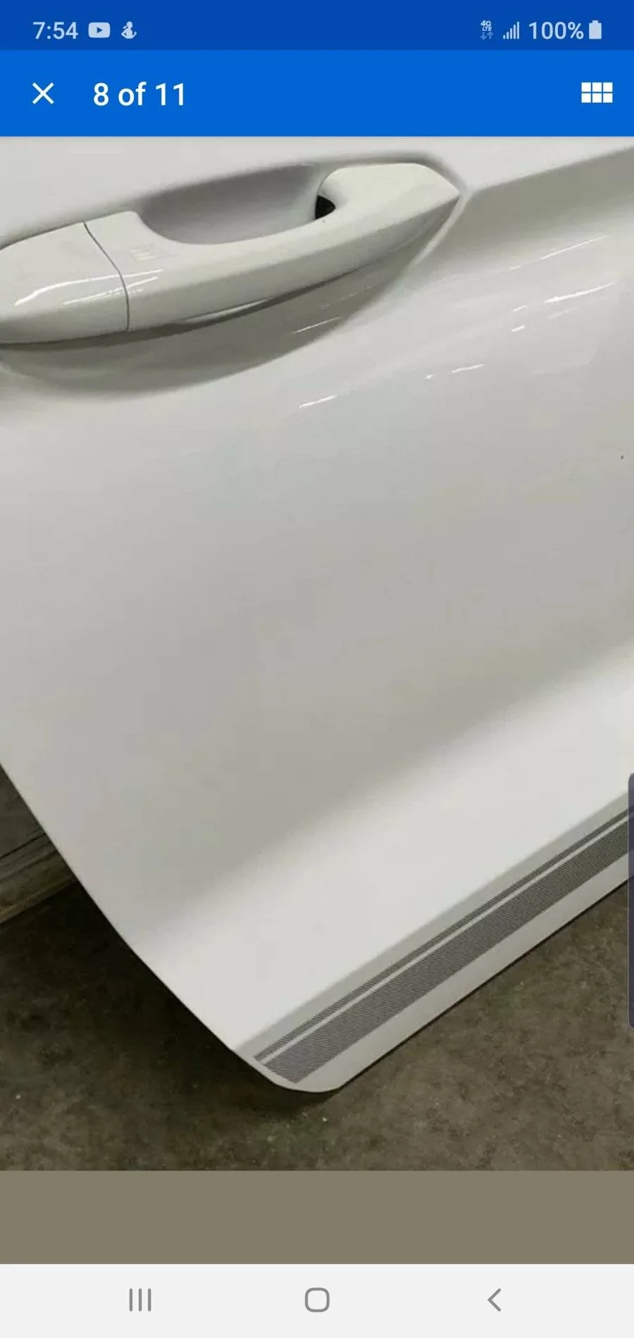

So are those door stripes removable or painted ?

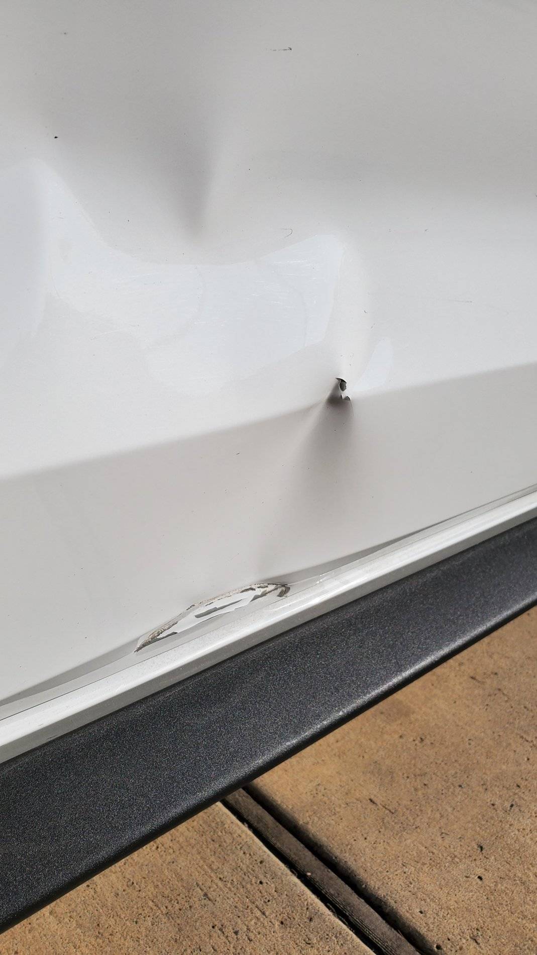

Ok thanks. Like I said . I need a new door has a little mishap in my garage.
Its actually cheaper to get a replacement door off Ebay lol.

I removed vinyl decals (huge decals) off of a 1993 Ranger STX I owned years ago more than a year after I got it. Used a hair dryer and took my time. Went over the vehicle with a paint cleaner product to remove any residual adhesive and buffed it out. Easy Peasy. Did it on a cold day with clear skies and direct sunlight. Just take your time. A hair dryer unlike a heat gun won't harm the paint if held in place too long.

I removed all the stripes on my car, little heat or sun and comes off.

Heat works great. But if your wife has a steamer, that really works awesome. Pulls glue off with stripe. If not heat.
