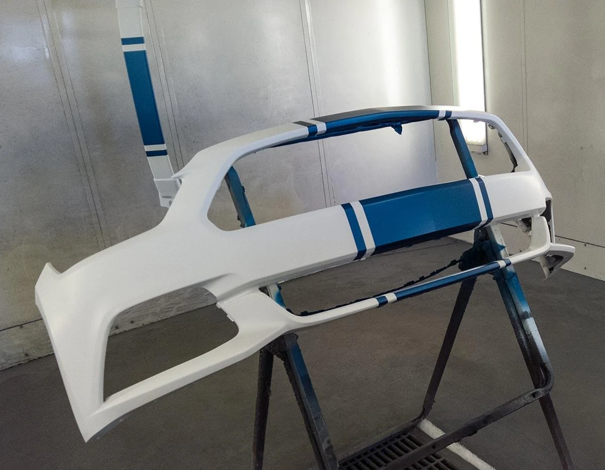

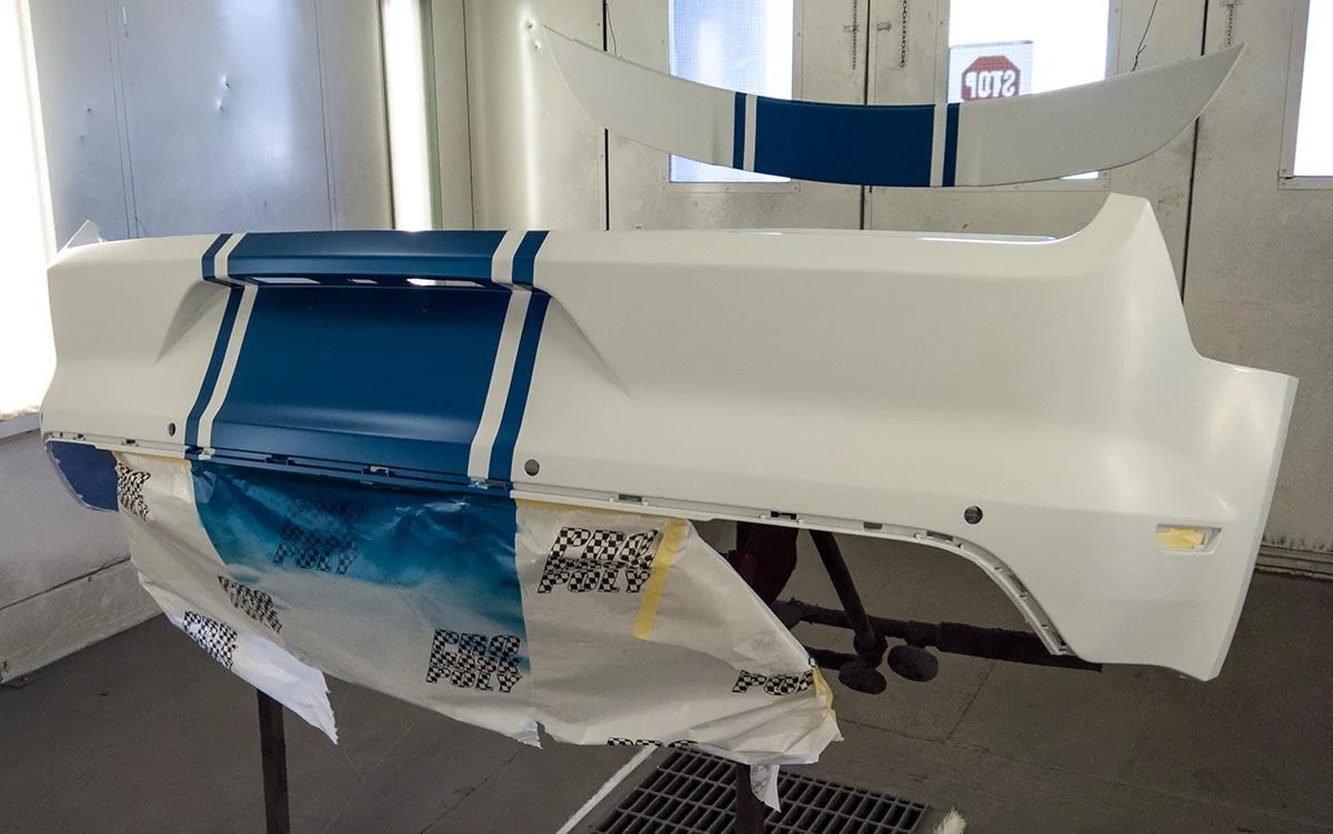

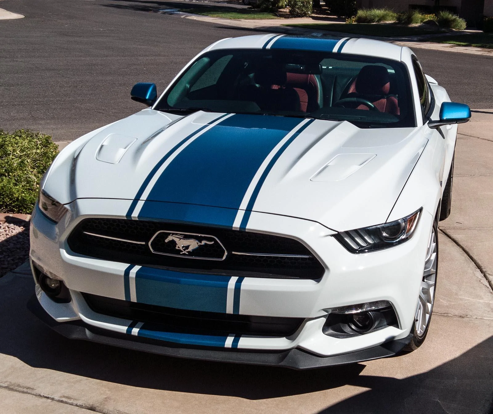

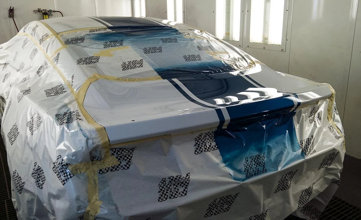

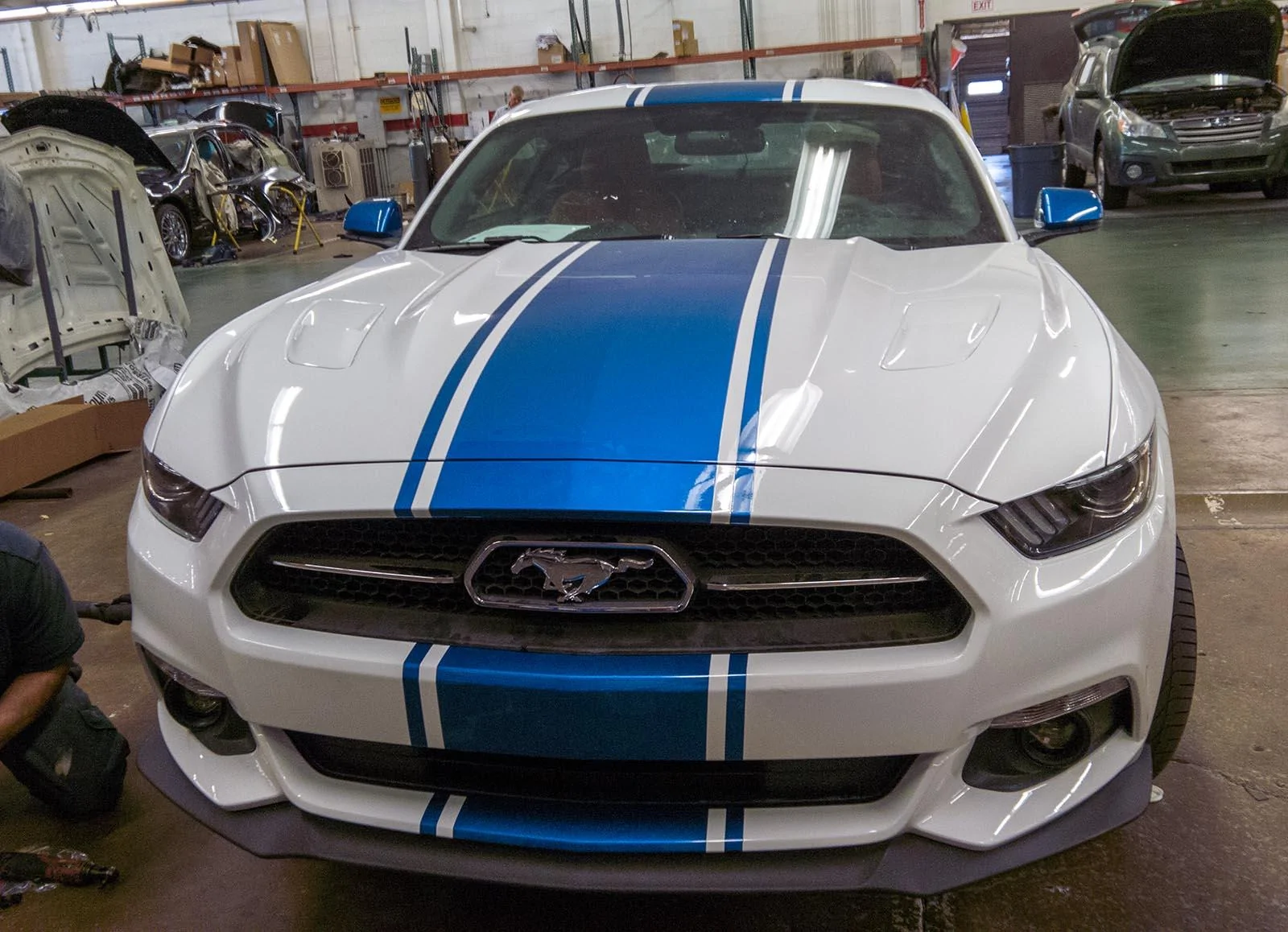

Simple. Order without stripes. Have stripes painted on. Infinite color choices. Infinite choices of widths and patterns. No special care. Won't peel. Won't stain. Other benefits such as 8 times thicker clear for chip resistance and mirror smooth paint on upper surfaces.
Bumpers, strut tower brace, spoiler (before clear):
Upper surfaces (after clear, before buffing):
Assembled (dirty, before buffing):
Finished:

Looks very nice. I would like to have done that. You can ceramic coat over them. Should be "indestructible", unless your child is Dennis the Menace.

~$2,000. There is a thread here by someone in CA (L.A?) that had it done for ~$1400. Could have been done for less but I went with someone I knew at a place in business since 1923 that guarantees the work for life and means it. There was some guy getting his AZ sun baked truck repainted for the 3rd time under the warranty on the original job over 40 years ago.
Its a bigger job than you might think. You need to isolate the panels that get stripes. That includes things like removing the roof antenna bump which in turn means dropping the headliner to remove the antenna etc, etc.. The factory clear on those entire panels have to be scuffed. After the stripes are laid, the entire panel has to be cleared. So everything but doors and fenders get cleared. Which is a good thing (other than the cost) because a human can't lay clear as thin as factory robots, so you end up with the thin factory clear PLUS the human applied clear on top of that.
The shop had never painted stripes before but their head painter had in a prior life. Management was a little reluctant to take the job and probably added a bit to the quote because the job didn't fit their business model (eg: most accident repair customers don't ask for a bunch of paint samples; I changed my mind on the color 5 times. LoL).
I told them they should update their sign more than once every 13 years (and counting) but I guess the word "over" technically means they never need to:
