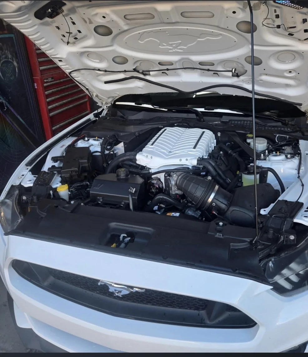

I have a 2015 Mustang GT premium with a Whipple supercharger stage one. The shop I take it to and the shop that installed it has not found an issue and we are all scratching our heads to what it is. I decided not to go with the cooling fans and went with the large intercooler on the Whipple and I have a Mishimoto radiator and expansion tank. I have talked to Whipple and to MishiMoto. They told me maybe because increased pressure it’s coming out the cap and bleeding off and I need to find the proper level when I fill the expansion tank. I filled it to the line that it says it needs to be filled, but every now and then when I open up the hood, I can smell a little bit of coolant. The level is not dropping significantly very very small and I’ve been going back-and-forth on this for about a year. Has anyone else had this problem? Whipple says because of the increased pressure maybe the level on the expansion tank needs to be a little below what they’re recommending.
And I need to find that sweet spot. MishiMoto is concurring with this but again I’m trying to find out if anyone’s had this problem. I don’t want go back to the stock expansion tank. Whipple doesn’t recommend adding a different cap. The stock cap for Mustang should be enough. Conflicting information back-and-forth one is telling me to go to a different radiator cap. Then Whipple keeps saying no. Like I said it’s not very much. I think the most I’ve ever had to put in just under a cup. I know thats not much but I’ve been around cars since the mid 70s and nine in my late 50s. I haven’t had any real spikes in temperature, but the smell of coolant when I open up the hood after I run it for a little while, always gets me a little paranoid.
One group is saying don’t worry make sure you find the right level it might take a while. One group is saying It might be a bubble still stuck in there and both are saying, don’t worry we see no evidence of any issues. I do see evidence of small venting from the radiator cap. Just to make sure I went to ford and bought a brand new one. Just so I can eliminate that issue. I was just hoping for some help here. This is my third mustang and my first S550.
