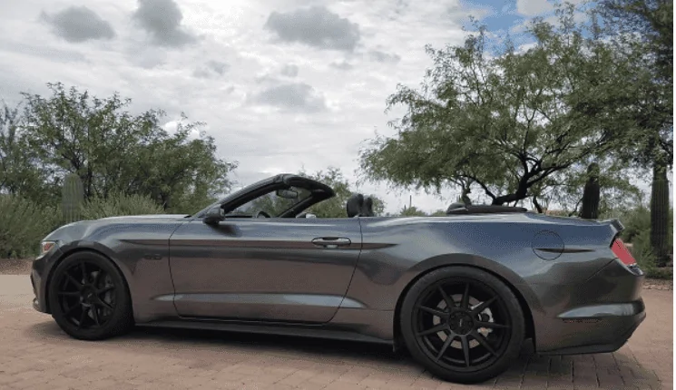

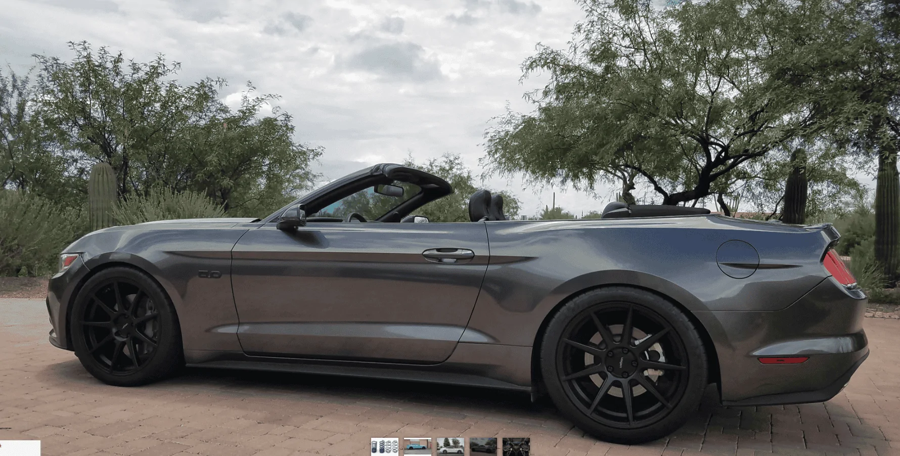

Keith, the 1/4 spacer is the one we have as an option for the progressive springs - that is part of the dropdown.
I don't have the exact dims but here is a customer's car on the Progressive Springs:
