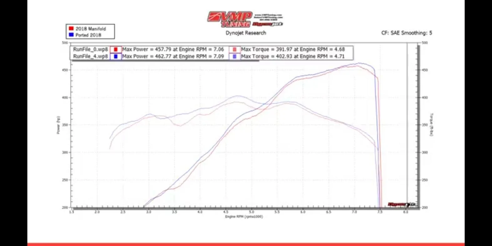

Happy new year to everyone reading this. I have been wondering if anyone with an actual 18+ GT have ported their stock IM and what results you got? I got a ported one that I got for my 15 but since now I got a 19, was thinking about swapping it when I get my PMAS intake. Wanted to see what gains I could expect and if is worth the swap.

From the VMP shootout.

The shootout was done with a 15-17 model. I'm looking for results on a 18+ car or can those results translate to a 18+ car?
The results should translate well. Maybe not identical but you can see where the improvement is. It's not so much peak but rather a smoother curve that is stronger in the midrange and doesn't fall off on the top as much.

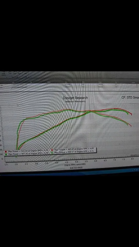

Air Flow Solutions does the CNC porting on the VMP intakes, From their site,
2018 GT Intake Porting-
We are very happy with the out come of the new 2018 GT intake manifold. With the stock intakes making the same, and in some cases more power than the GT350 intake, we have found more room for improvement. We gained an additional 12% in overall flow and achieved a better balance between cylinders. AFS can port your intake or we will be selling new intakes that have been ported and are ready to bolt on!
AFS porting on your intake, $200 shipped.
AFS porting on a new intake that we provide, $650 shipped.
I should've kept clicking he posted a FBO 2018 before/after graph, Had to see but he said it went from 497 to 512.
40581435_1943417042348101_1620564226764439552_n.jpg?_nc_cat=108&_nc_ht=scontent-lga3-1.webp
