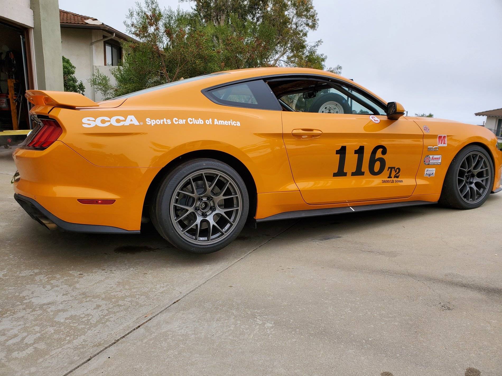

Yeah I have not noticed that before but lame! That's just how it is with the MCS coil overs. It could be partly related to the shortened bodies for lowered cars? I still have not had a chance to get the new setup on track. I'm hoping for transformational change but skeptical...that's for a post to the other suspension thread.Not much droop...
yeah I guess the pic is an illusion because measured on flat ground there is plenty of droop. The picture is initially worrisome.Generally a good idea to have ~2" of droop so that you maintain substantial load on the inside tire. If you have a shortened shock, you may need to run lower to get it.
My understanding for drop is 1"-1"1/4 higher than the tire that's the optimal setup basically two fingers between the fender and the tire for optimal high for the track with no rubbing.Generally a good idea to have ~2" of droop so that you maintain substantial load on the inside tire. If you have a shortened shock, you may need to run lower to get it.
You're probably getting something like a quarter of a degree of chassis twist as shown. You'll never see it with your unaided eyes.I don't have too many complementary comments for the s550 but I am happy to report the chassis is rigid. I have had many wet noodle cars and thankfully this isn't one of them.
How did you measure it?You're probably getting something like a quarter of a degree of chassis twist as shown. You'll never see it with your unaided eyes.
I actually made a series of measurements jacking up one corner of my S197, just to get an idea. If anything, I'd expect the S550 to be slightly stiffer.
