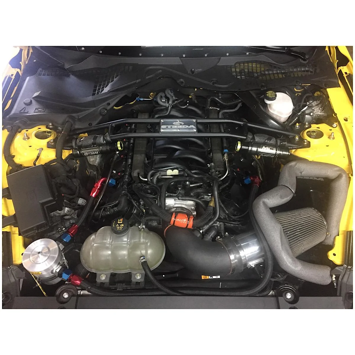

New breather and return system
Hi everyone, just wanted to show our new crankcase breather return system.

Did the extra foam help with IAT temps. Since installing my Steeda CAI, my IAT temps have increased over ambient compared to the stock air box.
At Cruise speed it should be within a couple of degrees of ambient. Check to make sure the lower box to grill opening is properly attached.

I'll double check. The stock air box would return 3-4 degrees from ambient at a steady speed (usually checked on interstate 70+ MPH)
So far I'm seeing that it will get down to about 5 degrees over ambient, then slowly climb over a duration of 20-30 minutes again checking on the interstate at 70+ mph
