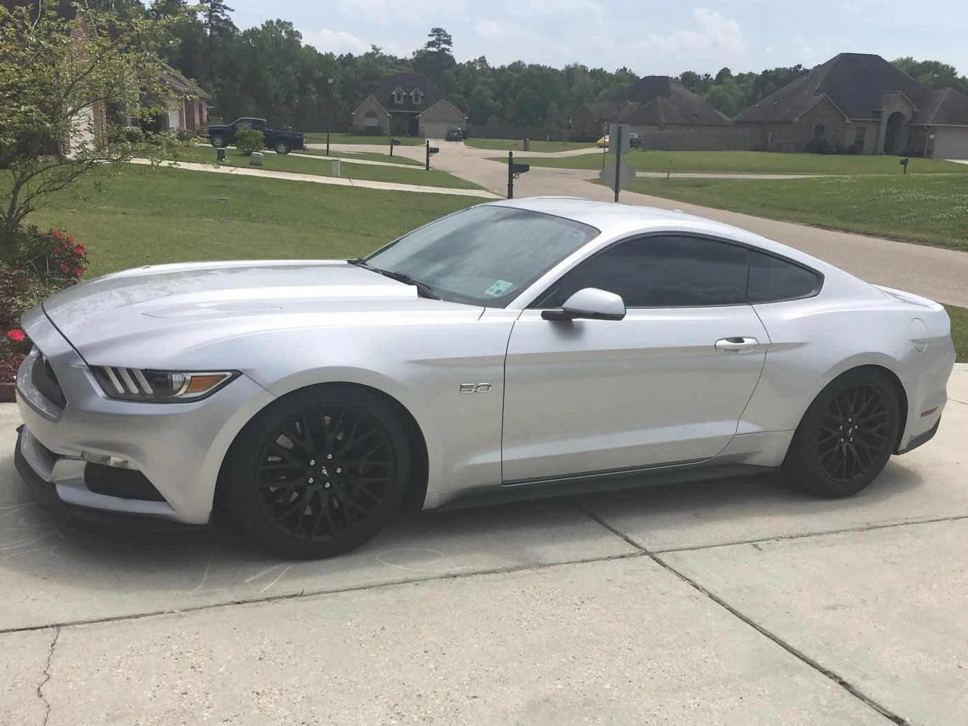

I like the drop. The ultralites with FRPP shocks and struts ride far better imo than the stock PP setup.

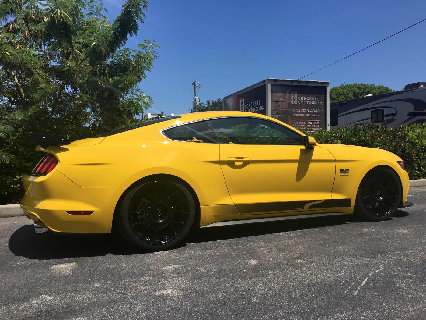

Can I be honest, I feel like the Steeda Ultralites (at least in the photos I've seen on this forum) lower the rear too much OR don't lower the front enough. I understand actual height is different between F and R fender, but I want the wheel gap to be much closer (to the same) front and rear. With these, I am seeing more gap up front than the rear. Can this just be the tire selection of folks? I'd be doing 275-35 and 305-35 tires.
Going with those two tire sizes seems like an odd choice in my book. If you research the tire diameter difference between the two, it's almost an inch. So if you would do that you'd have an extra half inch of tire filling up the rear wheel well over the fronts so you're going to have the problem of unequal wheel gap no matter what springs you use. However, that tire size combo will give you a more raked stance because of the extra tire height in the rear over the front.
For an equal tire height staggered combo, I'd look into a 275/40-315/35 combo or 275/35-315/30 combo. Or 265/40-305/35 or 265/35-305/30. I'm not quite familiar with the tire sizing combos just yet for these chassis cars, but I do know tire sizing and these numbers work out with my calculator as almost exact height sizing so you don't have to worry about abs system going nuts and you don't have off looking sizing front to rear.
