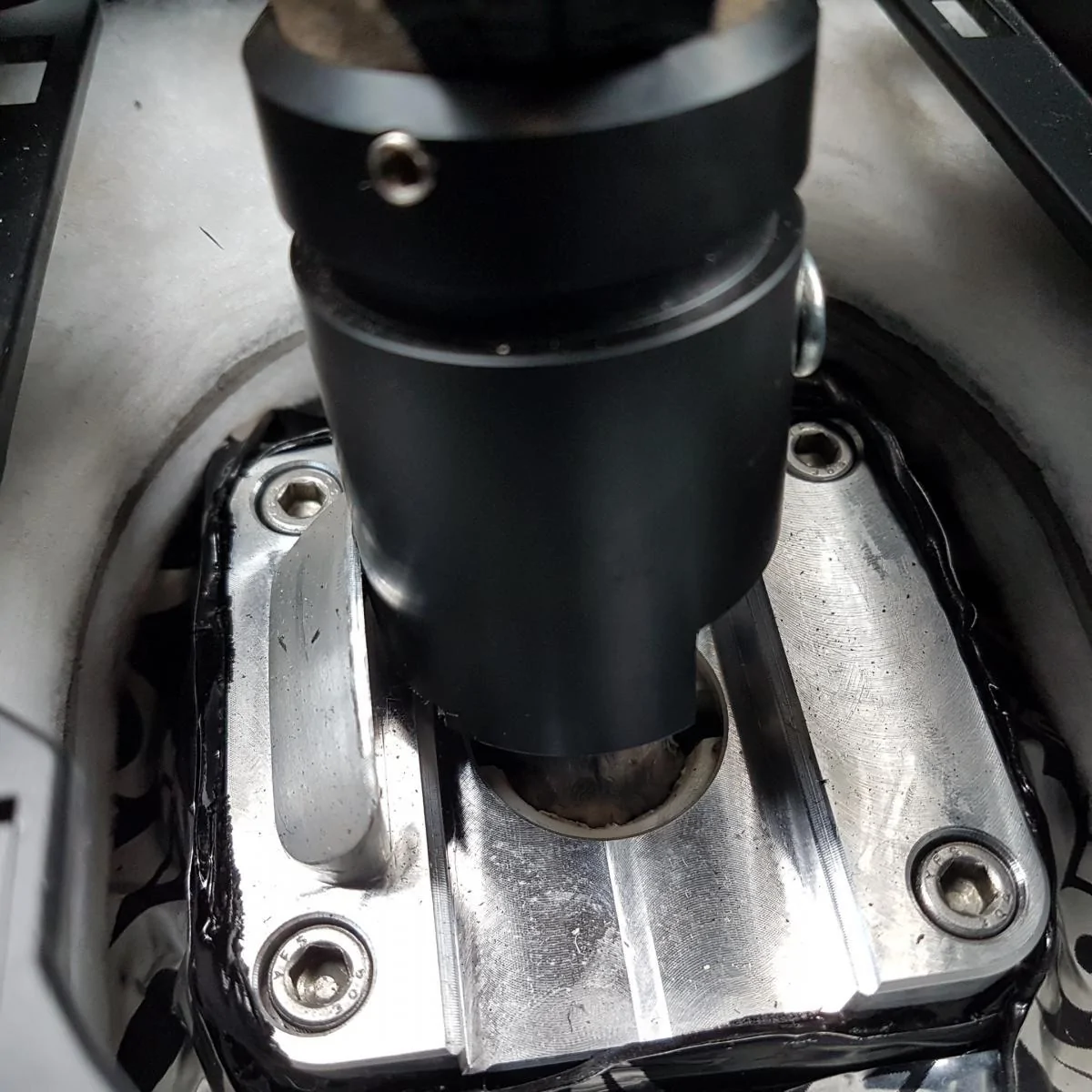

i opened the shift boot and found that black thing makes contact with the metal on the driver side whenever i try to put it in 1st or 2nd.

installer told me because of the the metal shield on driver side, shifter cannot go any further to left compare to right which is for 5th and 6th.

Remove the tension springs all together, that should help 1st and second gear shifts. That's how I run mine for road racing.

as Tech mentioned I removed the springs completely.
it is now much easier to get 1st and 2nd, but, it still makes contact.
My buddy recommend me to shovel the back thingy little bit so it will not touch anything anymore.

Was yours touching the metal shield as well? I know eventually it will bet better once that black thing has enough scar and I may call it 'break-in'.
But my question is that why I have to remove it.. tried couple times with spring re-install, removal, different springs, etc. But, nothing really helped with contact..
