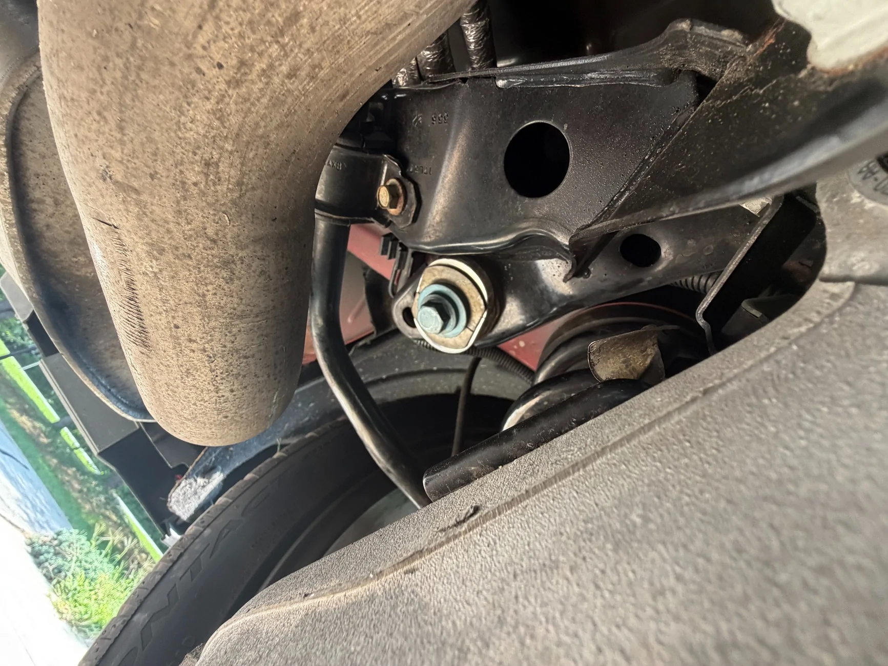

Other than that, pretty easy install. This pic is of the rear subframe collar (2 piece one) and you can see how close it is to the frame.

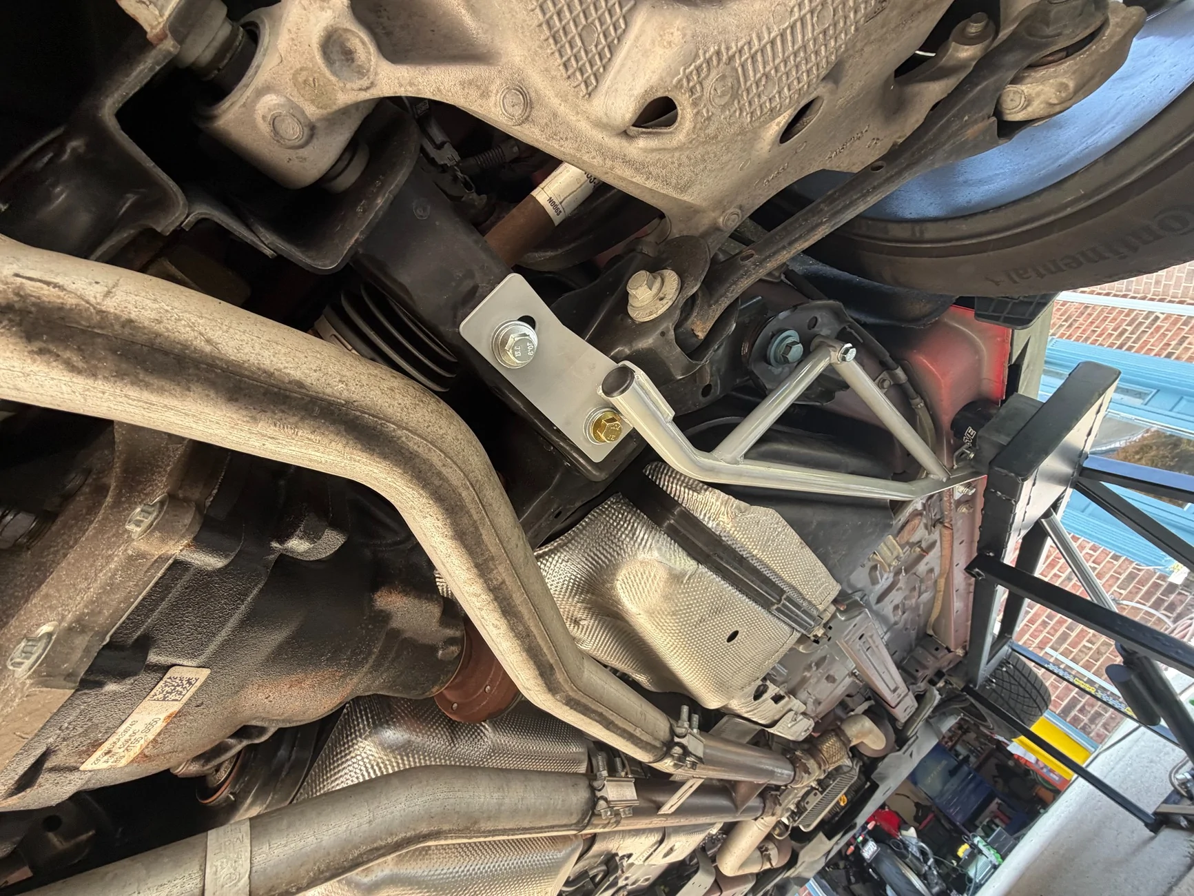

Subframe bar mounts. If you zoom in and look at the front, you can see how tight that space is, especially if you have pucks mounted! Doubling up the blocks on the quick jacks would solve that issue. Would be a non-issue on a 2 or 4 post lift.
