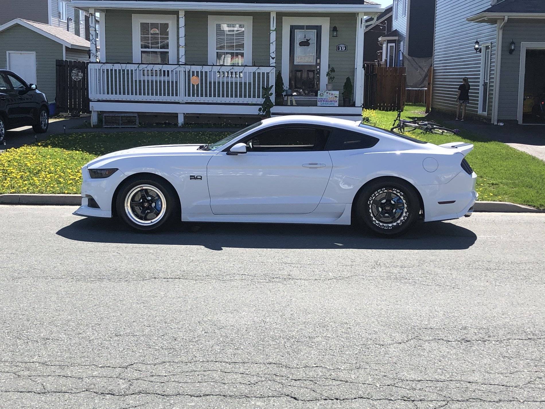

Hi All,
I am running BMR SP088R drag springs / Viking Crusaders in the back of the car with stock springs and struts up front. The car is currently raked slightly in the back even with a Steeda 3/8” spacer. I have a Steeda 1/2” spacer on the way for replacement to bring up the back of the car. Do you think the 1/2” spacer will bring the car up enough or should I get a local machine shop to fabricate a 3/4” aluminum spacer?
The car is too low in the rear for my liking.
Please see attached photo.
All comments and input are greatly appreciated.

Whatever you choose, remember that the spacer will raise the car approximately double the thickness of the spacer.
Why not lower the front to match? The springs dropped the rear 0.5".
Hi Brian,
With the condition of some of our roads, I need to raise the car higher. Even back to stock height. I DD the car in the summer and also haul around my wife and 2 small children.
From the ground to the bottom of my wheel arch in the fender is about 27 1/2” if my memory serves me correctly. Front is about 28” or so.

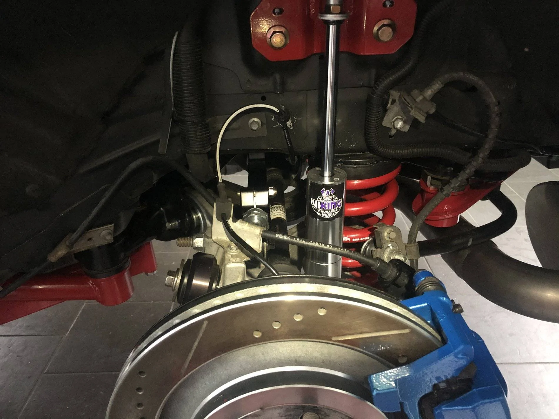

Also I would strongly recommend that you run bumpstops if you value your shock mounting.
Hi Brian,
I have the OEM bump stops and sleeves on now and trimmed to spec as per BMR. This photo was taken over the winter when I finished all the suspension upgrades. The car never had the bump stops with the original / previous setup.
