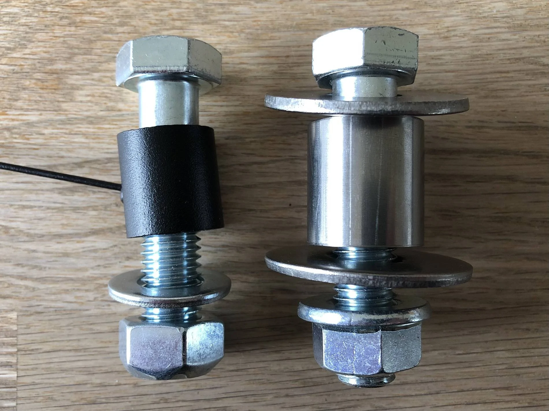

I actually needed bigger spacers than what Steeda supplied - I guess Ford must have refurbished their tooling giving less of a burr than what had grown over time :
WD :like:
