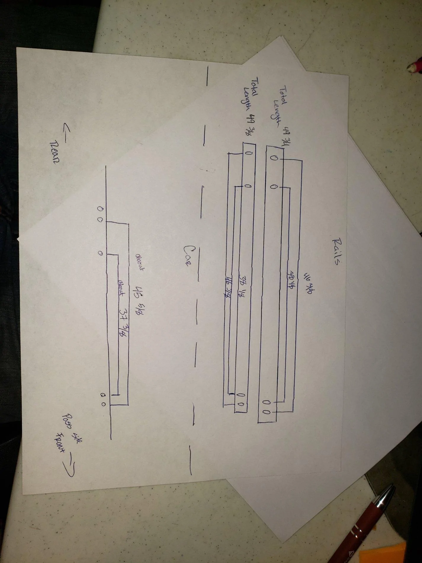

I've already emailed steeda waiting on a response but if anyone is interested here is a crude drawing of my problem of the passenger side The driver side measures out fine but I have not put it on until I get a response in case I need to send them back.

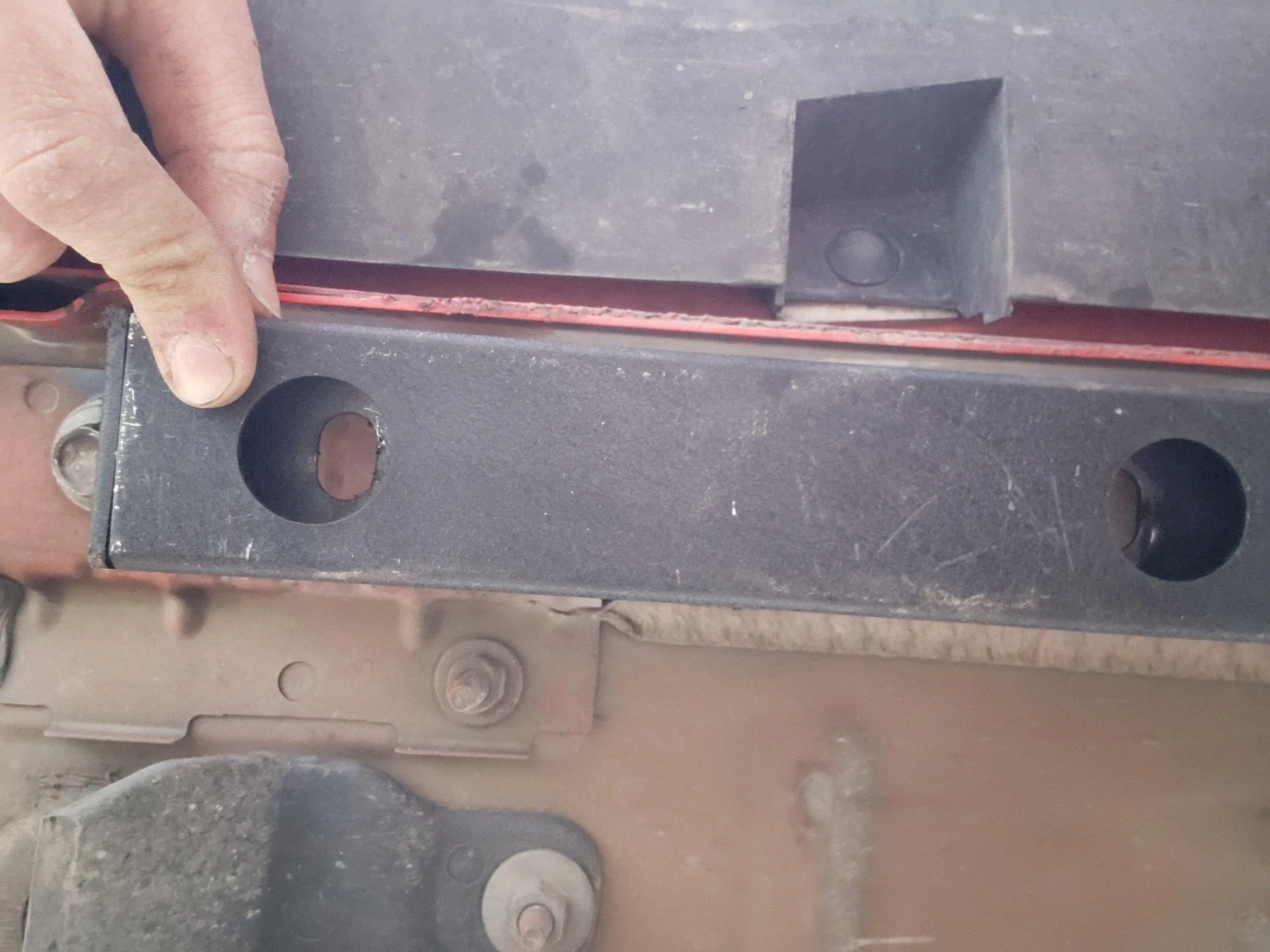

With front bolts in and yes this is the shorter rail

Hmmmm...
Is there possibly a Ford design/manufacturing difference between the 2015-17’s vs 2018/19’s where those locations are on the unibody?
Not sure no one seems to know what the issue is.working with steeda to find a solution

Any updates?
Yeah they said I must have gotten two driver side rails they are sending me to new rails to try. Steeda was very helpful I thought I was going crazy or something was wrong on my car for a bit
FWIW if you had two driver side rails I wouldn't expect them to be different lengths:
one rail is about a quarter inch shorter

Yeah I don't know I guess I'll find out when I get the new ones tomorrow
The good thing is the problem will be solved, regardless.

We are going to inspect them when we receive them back - see what we can figure out ... but yes, in the end, we wanted to make sure we got the OP squared away.

It was a packaging error. We apologize for any inconvenience.
