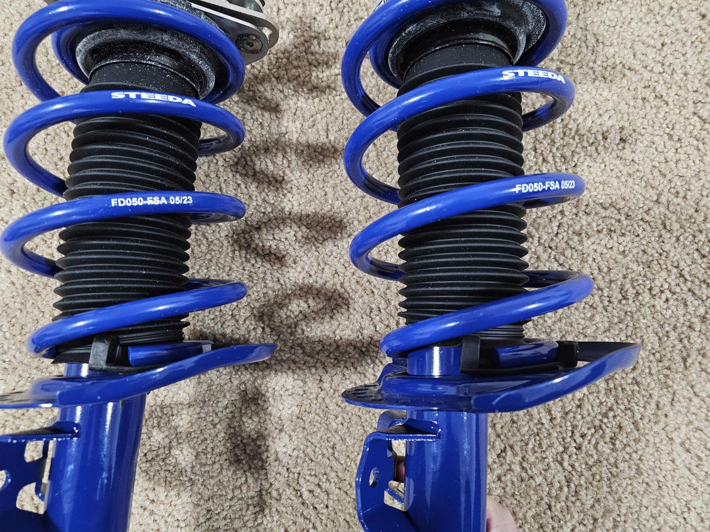

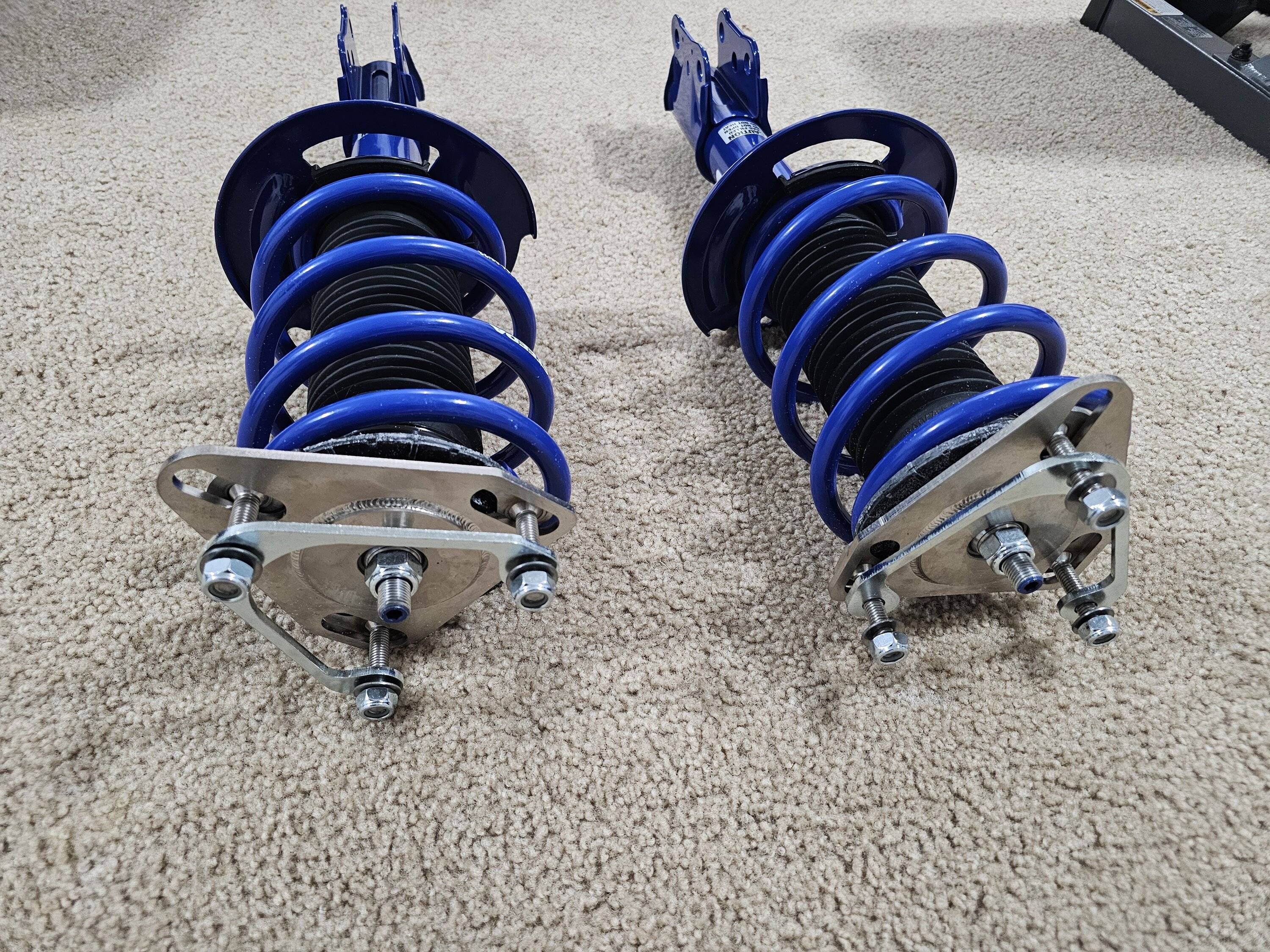

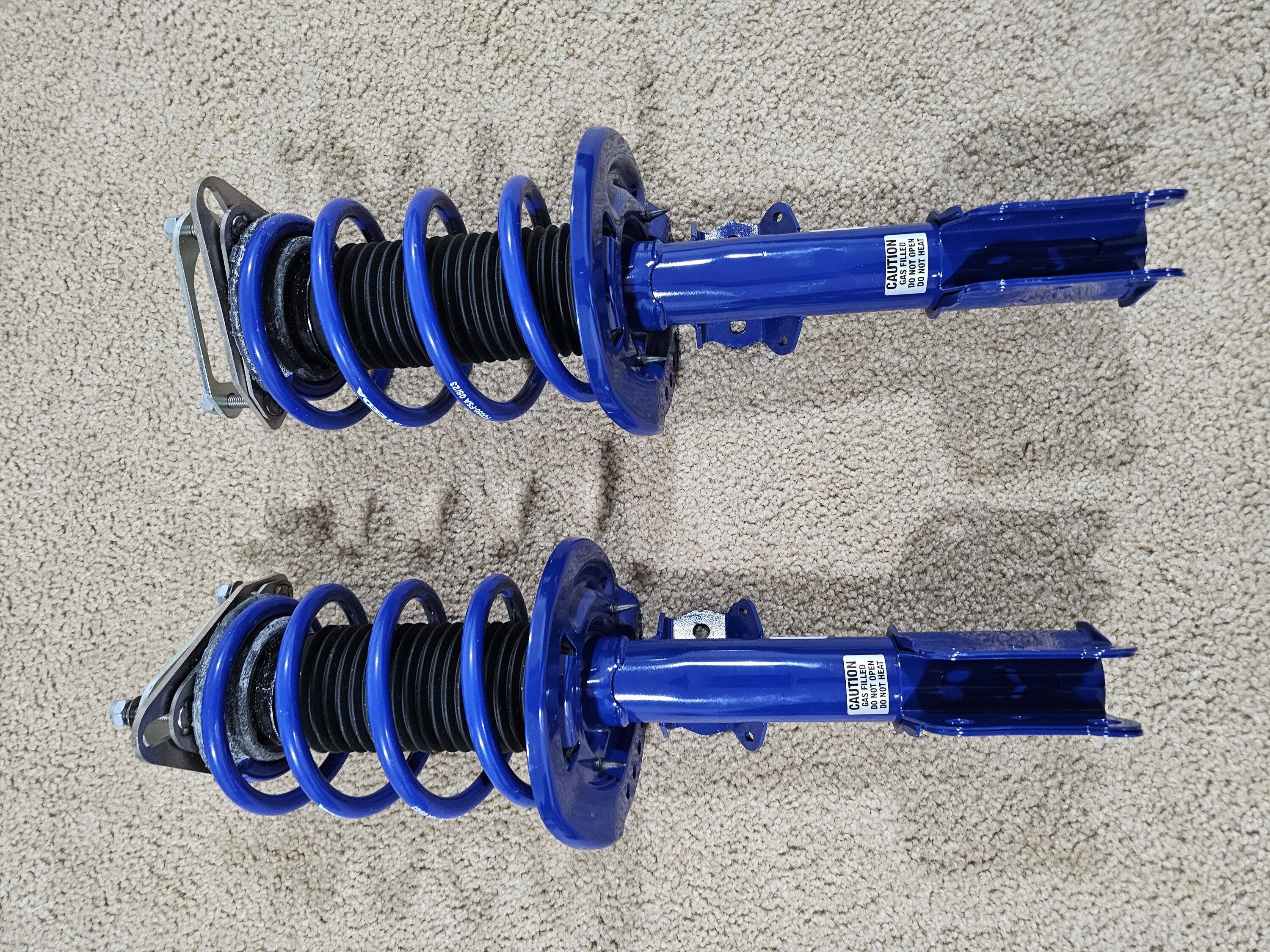

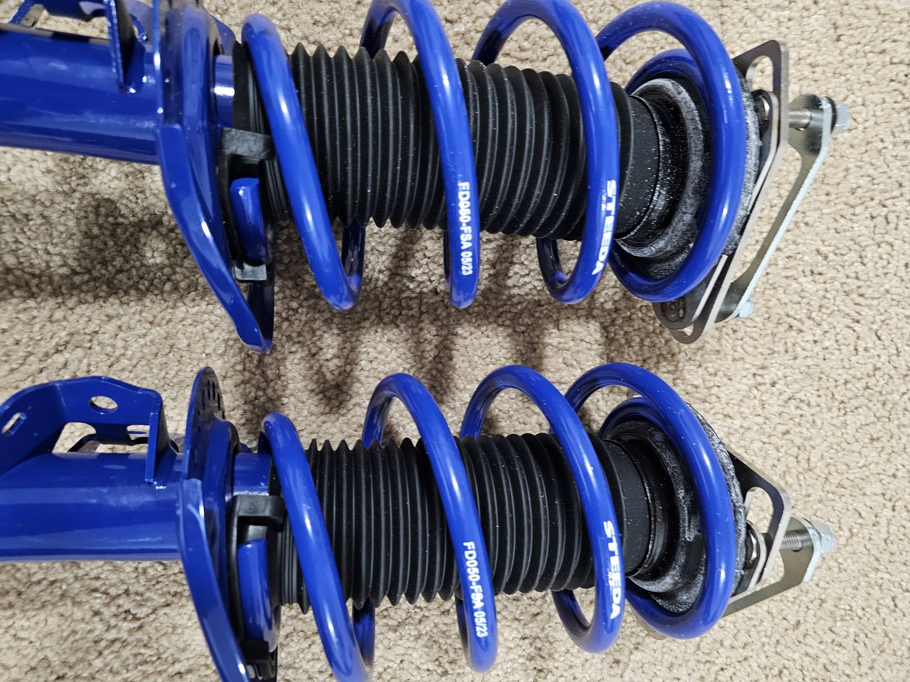

1) The way the caster camber plates are set up is one of these incorrectly installed?
2) the gap on the spring and rubber isolator pad should I have any concerns with weird my car sits crooked now?

The camber plates will rotate by hand to the proper orientation.
I don’t see anything wrong and would install with confidence.
Once a load is on the assemble, everything will be perfect!

Thank you! Lol last night I was messing with em more and realized the cc plates rotate 🤦‍♂️.
