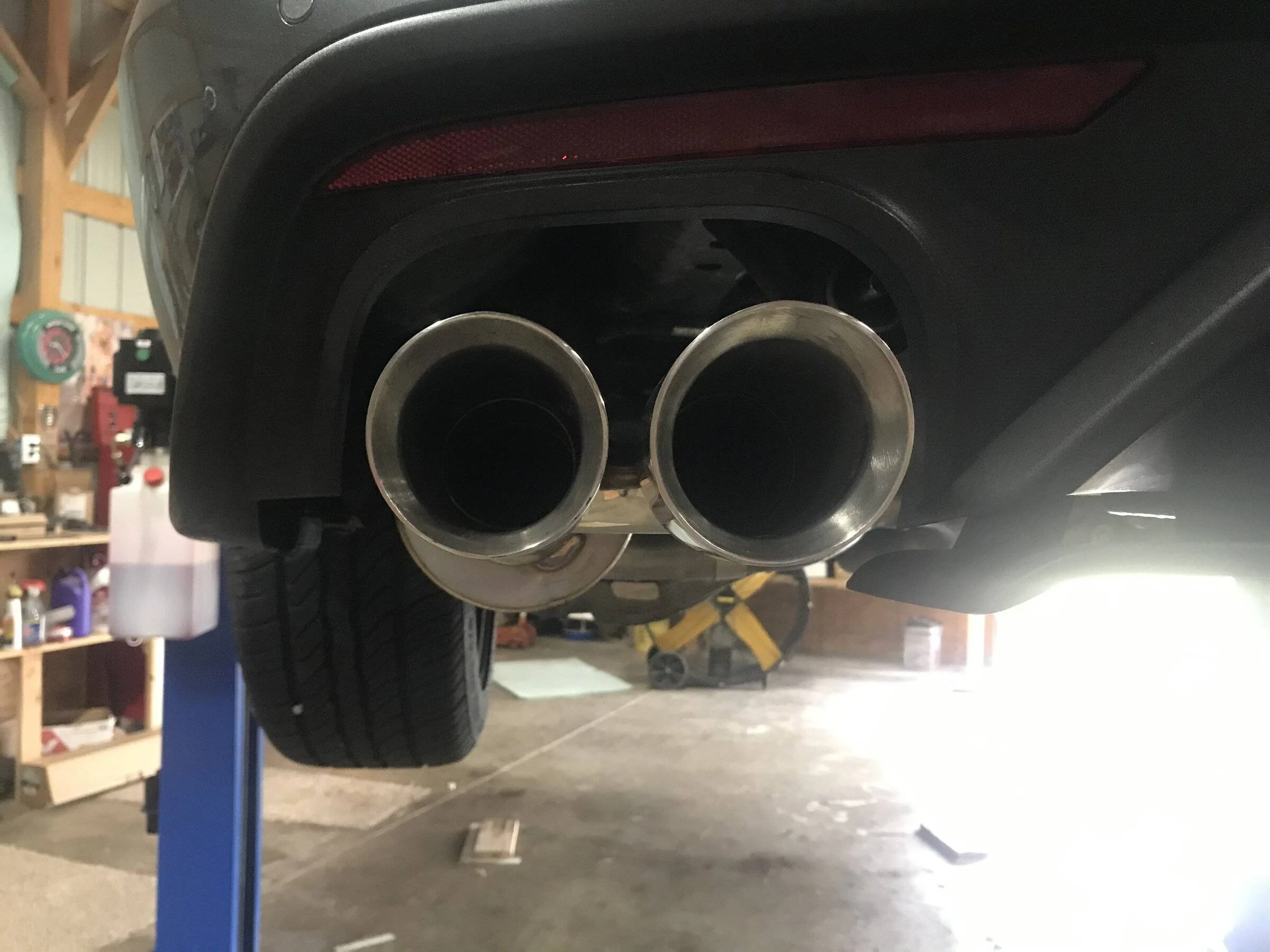

Did you have to bend or modified the hanger Bracelet to get the mufflers set right if so which way do you bend them mine are hang really low
I heated the hangers up with a torch and used a jack with wooden blocks to slowly jack up the tips until they were where I wanted them.
I used small pieces of wood wrapped in rags and placed them between the diffuser and tips to push them toward the middle. Didn’t take long.

Ok thanks I don’t have a torch so might take it somewhere... man they sound so good

I picked up a hand held torch from Home Depot. Lowes has them too for decently cheap.

I had the Steeda Aggressive mufflers. With the suitcase on the tone was nice and aggressive but not raspy. I went with the Borla Switchfire and man I hated it. I wanted to keep the Borla as it saved weight and ended up with the Ford Racing by Borla Sport and very happy with this. Also, the Steedas hung to low and I hated that only one side of the tips got dirty. You could see on start up only mist coming from just one of the 2 pipes. Also not to mention the tips are to small.

Were did you heat up the hanger
Thanks for your help
In the rear by the tips. That’s the one for the adjustment.
