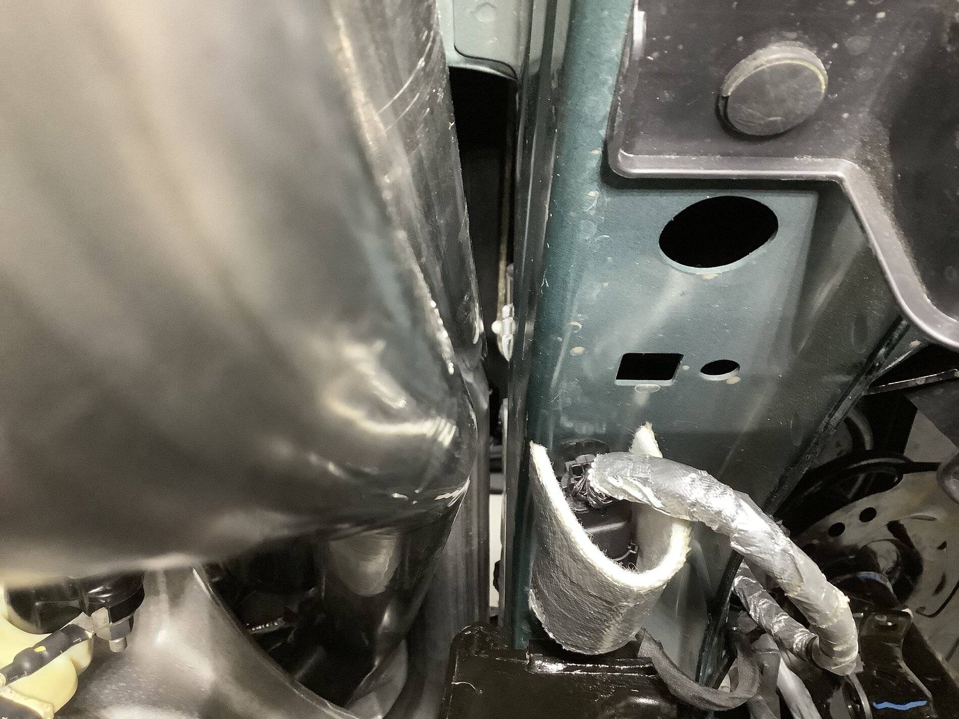

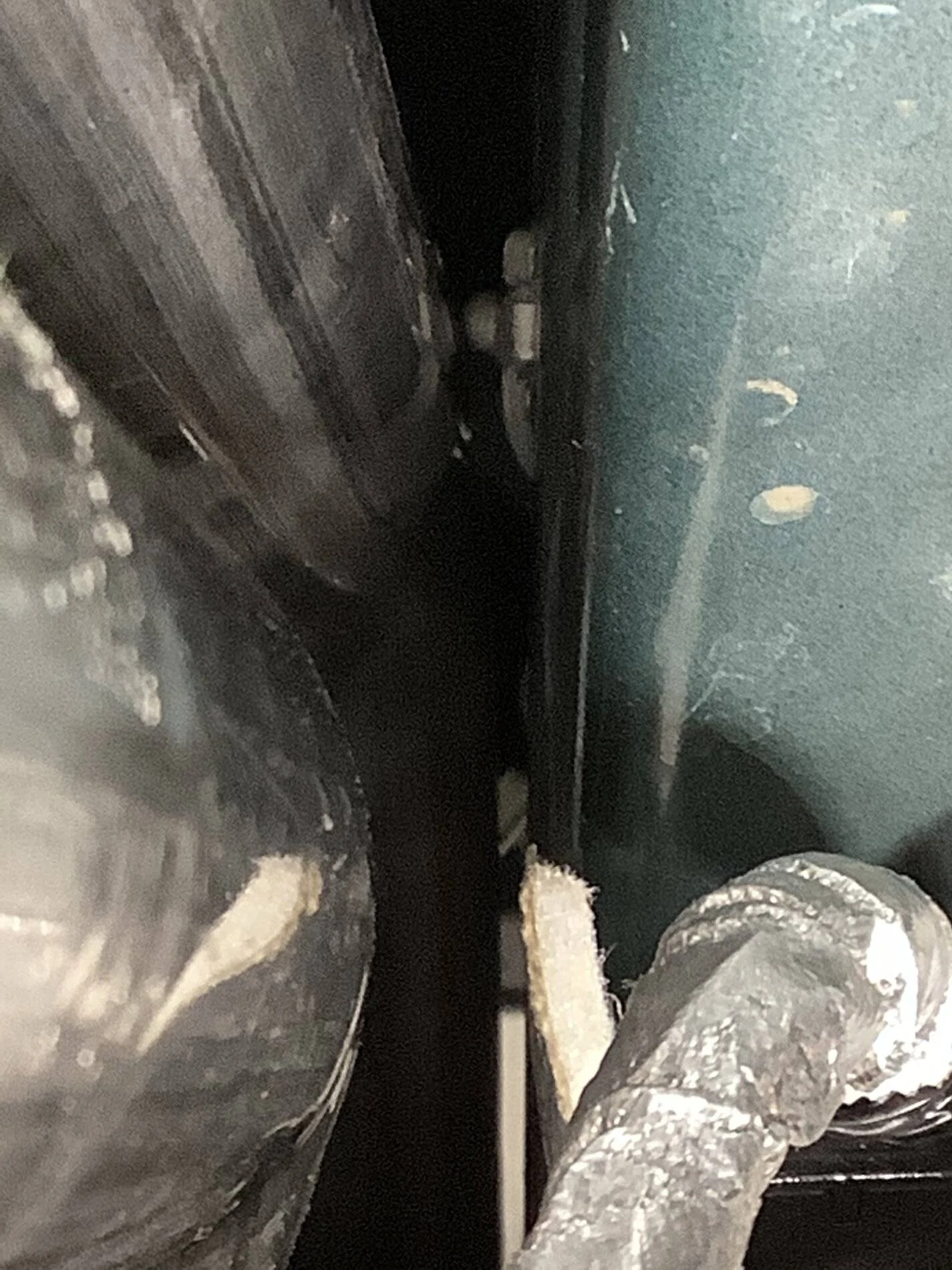

My car just got the Stainless Power headers installed (part number SM15H3CATLG) and the shop said that the fitment is very bad, there is only a couple of millimeters space between the headers and the frame of the car, is this normal?

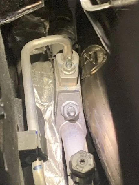

Stainless Power headers usually known to fit well. If you loosen both motor mounts, you can shift the engine from side to side slightly. Not sure how the Euro spec cars are, but it's commonplace to have to remove the passenger side A/C line bracket and stud.

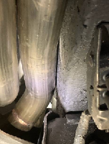

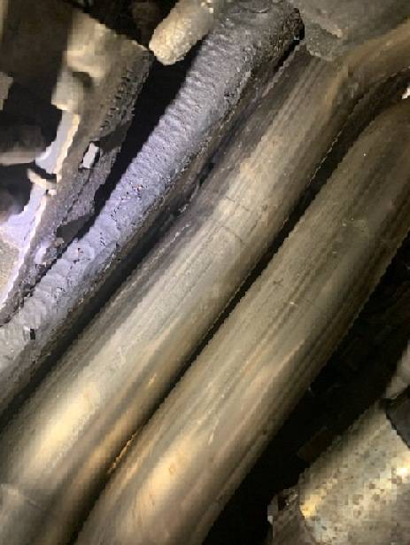

The shop is not having any success in moving them.. Any expert who knows if that is normal to have it so close to the frame or is it dangerous / possible fire hazard?

They will hit the frame from time to time and you will get false knock i would take them off it doesnt seem safe and i would try to get my money back. Maybe Euro cars are different.

Are they actually hitting the frame rail? All these aftermarket headers sit real close on the passenger side. Mine are probably 1/4”-3/8” away from the frame and it’s never hit or caused knock.

I dont know.. I havent driven the car yet since the install, its still in the shop.. I have reached out to Stainless Works for a comment but they have not responded yet.. :headbang:

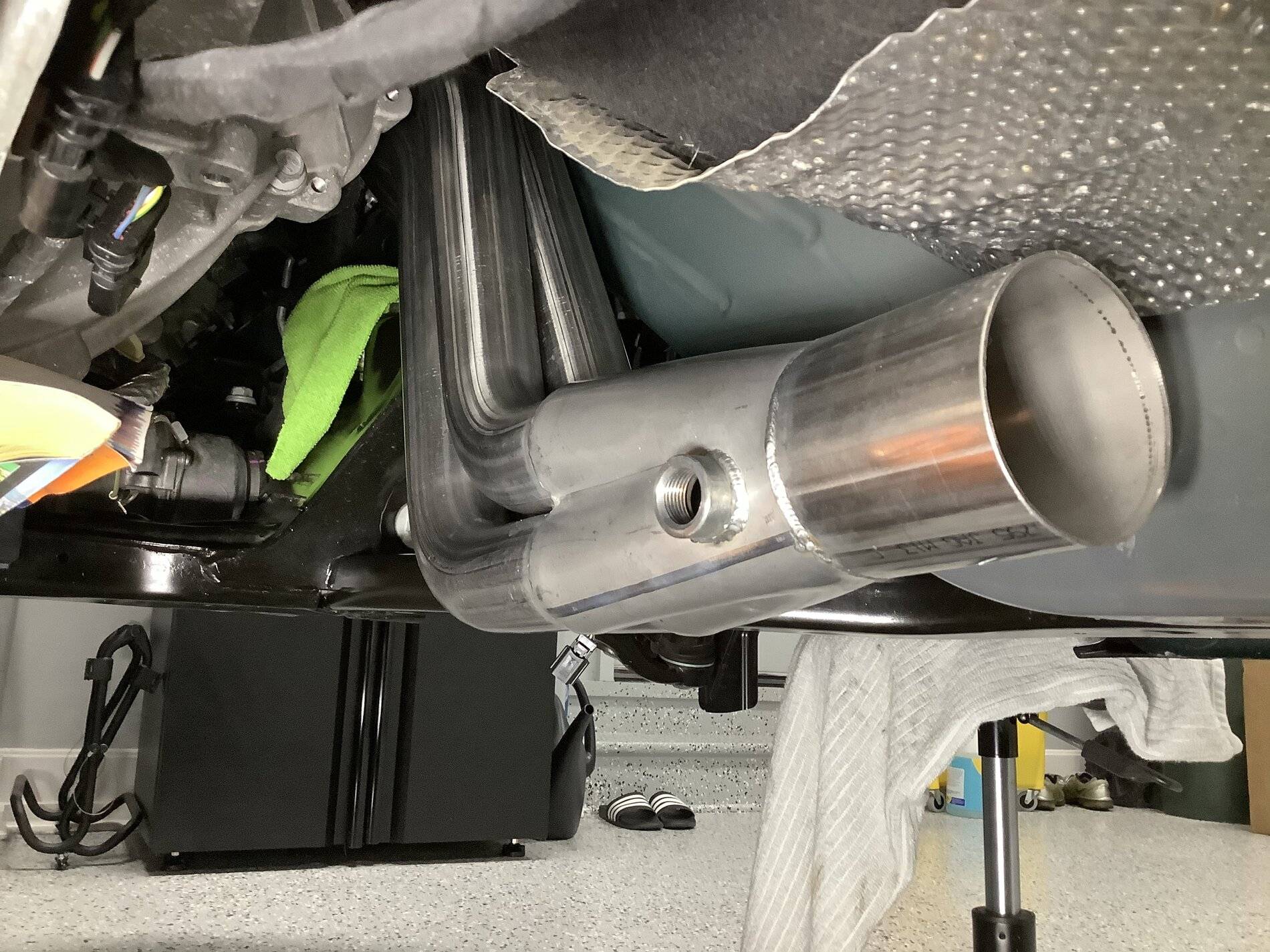

That’s too close and the header primary will definitely hit the frame during engine torque-over. I suggest having the shop mark off the area where it would make contact with your frame, remove them, heat them up until red hot and then lay a piece of flat 1/4” thick plate across the primary tube and put it in a large vice and tighten it down to crush/dimple the primary tube and get at least 1/4” - 5/16” clearance from the frame. Here is what good clearance should look like.
Thanks for the pictures.. Yes that looks like a bit more clearance..

With them being so close the inner frame rails is that you may experience a bit of noise/vibration when the engine is running. LT headers also get extremely hot and if anything is near them, you risk melting plastics/harnesses etc. and you also do not want any A/C lines being that close to a header. I recall seeing in other SW LT threads on here that folks had to tie up the A/C line away from the header.
The other issue is as said above, under load the engine wants to “twist” and with barely any space between the primaries and frame as seen in your images, there’s definitley going to be contact under load.
