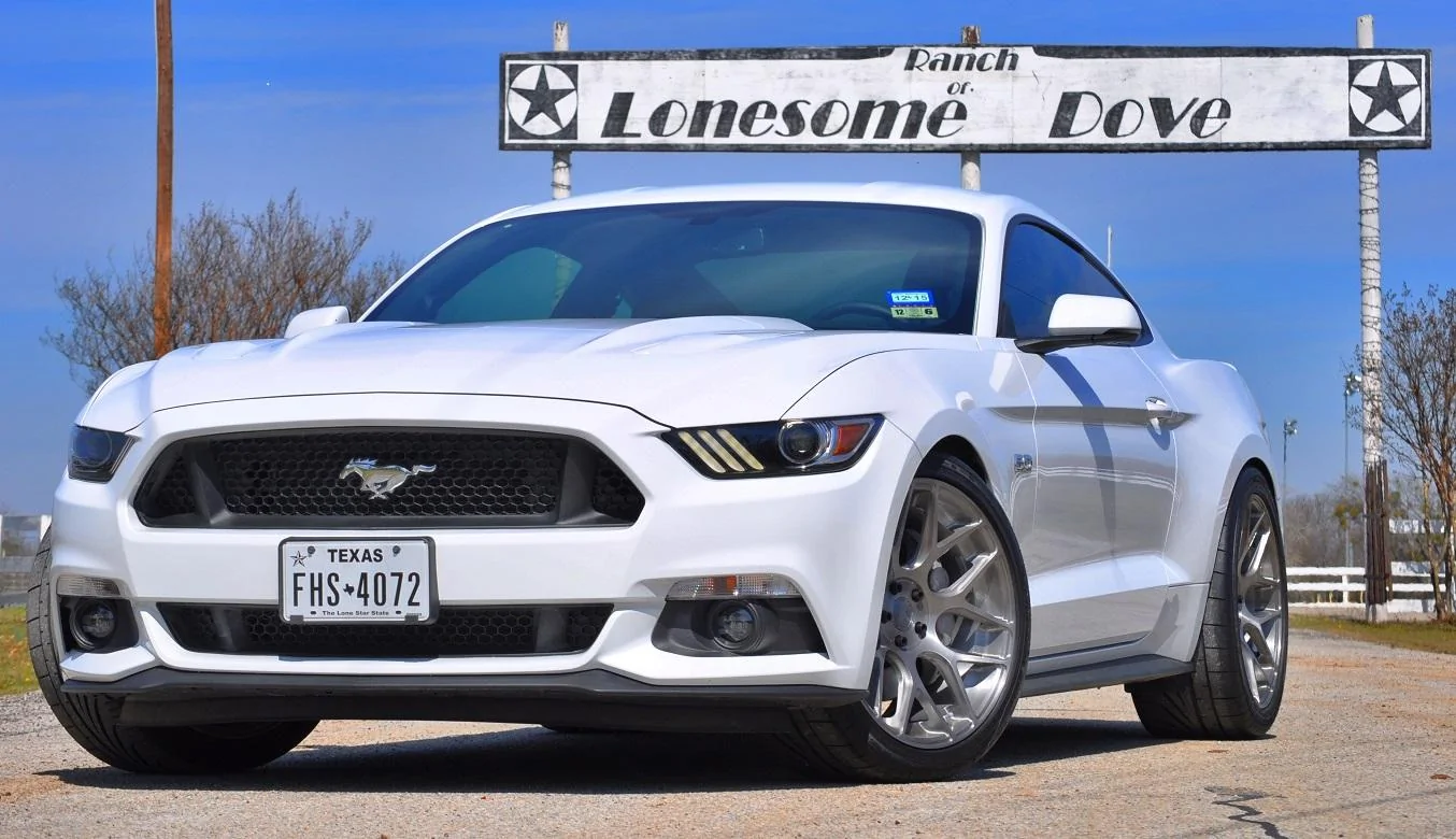

Based on the design the wheel has a nice drop center curve to it which should allow for a nice proper caliper to wheel clearance ( x factor)
So for the front you can do the following
20x9.5 ET 25 or 20x10 ET 24
Rear I would do
20x11 ET 49 ( but my concern is the depth being so deep it can hit the caliper) So this is something I would say you want to check if you can get the x factor for the wheel I can check with my spreads and see what they have.

Ive done a 20x10 ET 25 with a 285 R compound tire on a stang with a 1" drop it fits fine.
Is there any chance in the world you have a photo of this?

Of course, we were the first to do this setup 20x10 ET 25 front and 20x10 Et 35 rear

I dont know what coulor that disk is in the first photo but thats the colour i want i know it's the stepped lip one in the photo as well but im after non stepped lip which is the size chart i put up in OP

SSR definitely has proper brake clearance in mind for just this type of car, the rear would be the least of my concerns in "x factor" clearance.
Personally, fitting a few SSR wheel type setups in my day I would do this for my own ride -
front:
concave 20x10 78mm NR +31 offset
rear:
super concave 20x11 78mm SL offset +49
You can't just look across one line on the chart and pick the offset you need, you also need to look at the disk type to make sure it stays uniform front to rear. This should keep the high-end uniform look between front and rear, while giving you the clearance and not too much poke for your po-po to write a ticket.
If you are lowered and adjust some negative camber it will keep them from poking at the noticeable top of the fender as well for the front.
