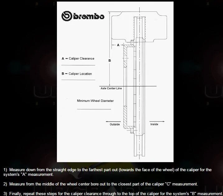

"if you can get the x factor for the wheel"
how would i get this information??? i thought that maybe the disk information in the corner of the pic was speaking of caliper clearance? or am i off on that
cheers heaps again for your help i am also open to suggestions from anything you have on offer thats similar.... like i mentioned i will be in the country on holiday in May/June and will visit your brick and motor location for a chat and a look around at whats on offer
No worries, so the x factor is the clearance that the wheel provides ( wheel face to caliper) They should have that info themselves.

Ok Paul im hoping you can help out on this and sorry to ask so much of you
i emailed a few places selling SSR's and they wont give me wheels measurements but said if i can find out the below measurements they can match them up for me. you dont happoen to have this information handy do you???
