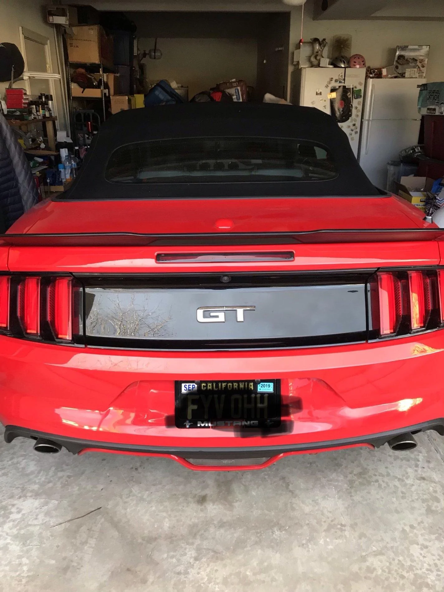

Here is a rear shot. I’ll try one lower in the morning.

my understanding is the spoiler is hollow(blow molded abs plastic) does it flex if you press on it? is the texture smooth and do you think it could be painted?
It’s hollow but does not flex when you press on it. It’s smooth texture. I’m not sure if it can be painted.

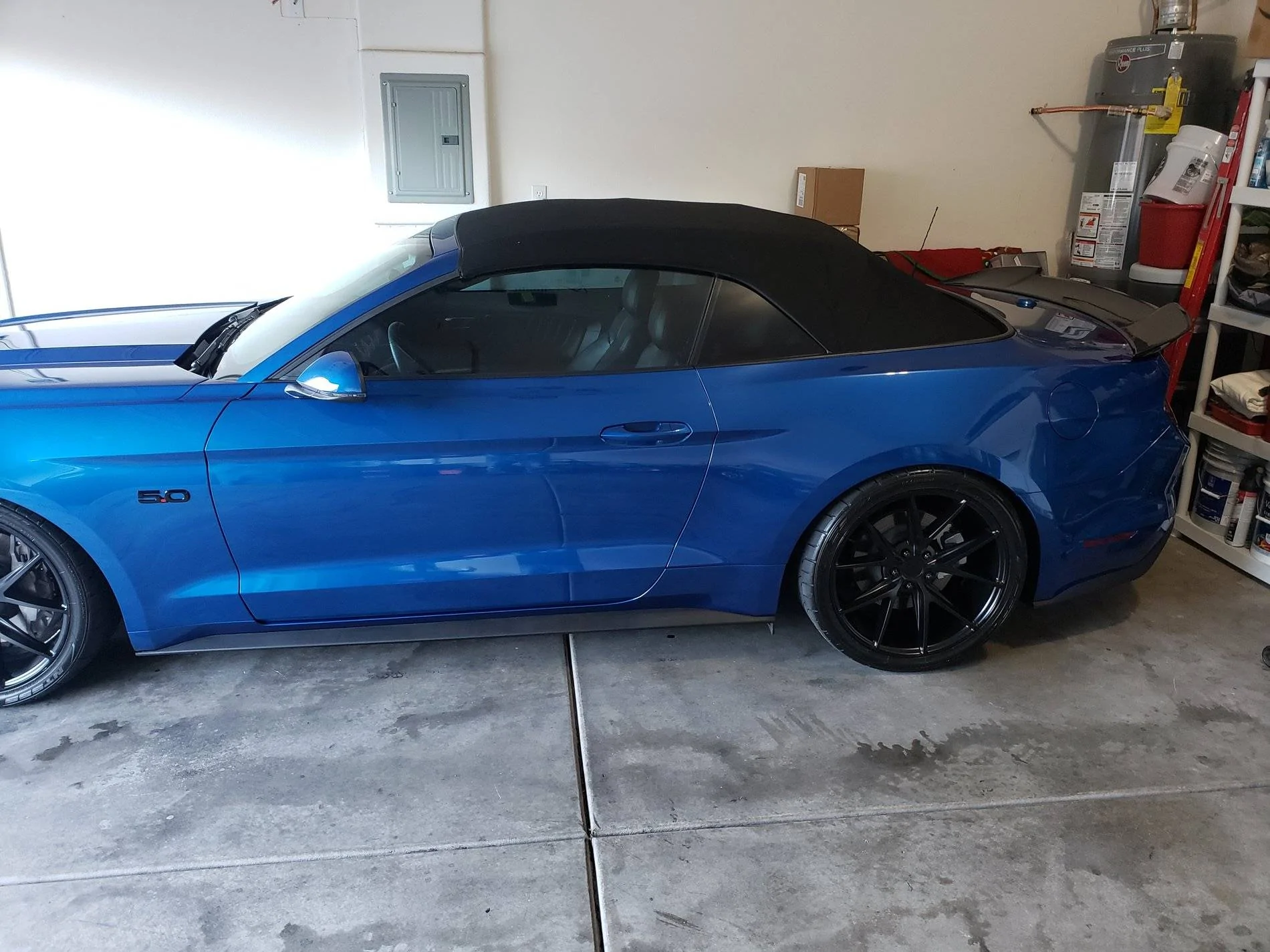

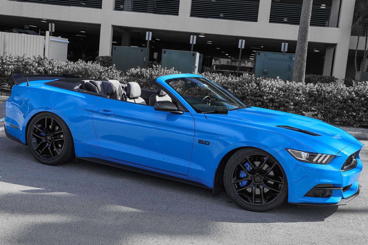

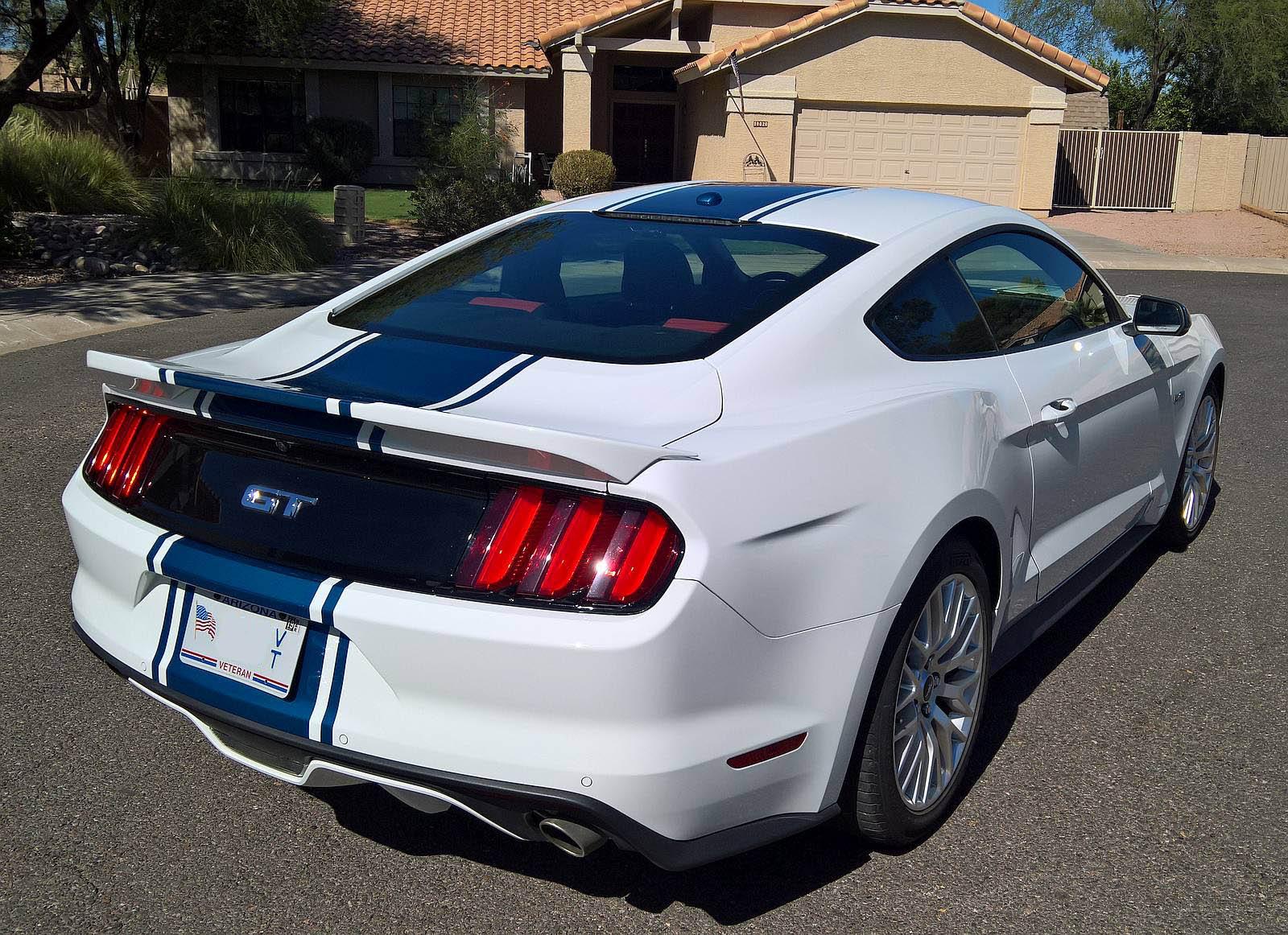

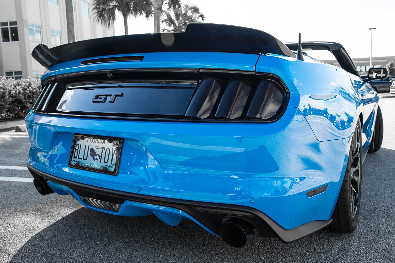

Should be okay to paint. The CDC Outlaw is made that way and even a greater distance between the top and bottom (taller air space). You can flex it a little but you have to really lean into it. CDC says to paint it the same as a bumper cover (which are far more flexible than the spoiler) with the appropriate flex agents.

Thanks for info. . BTW, love the blue strip on the white

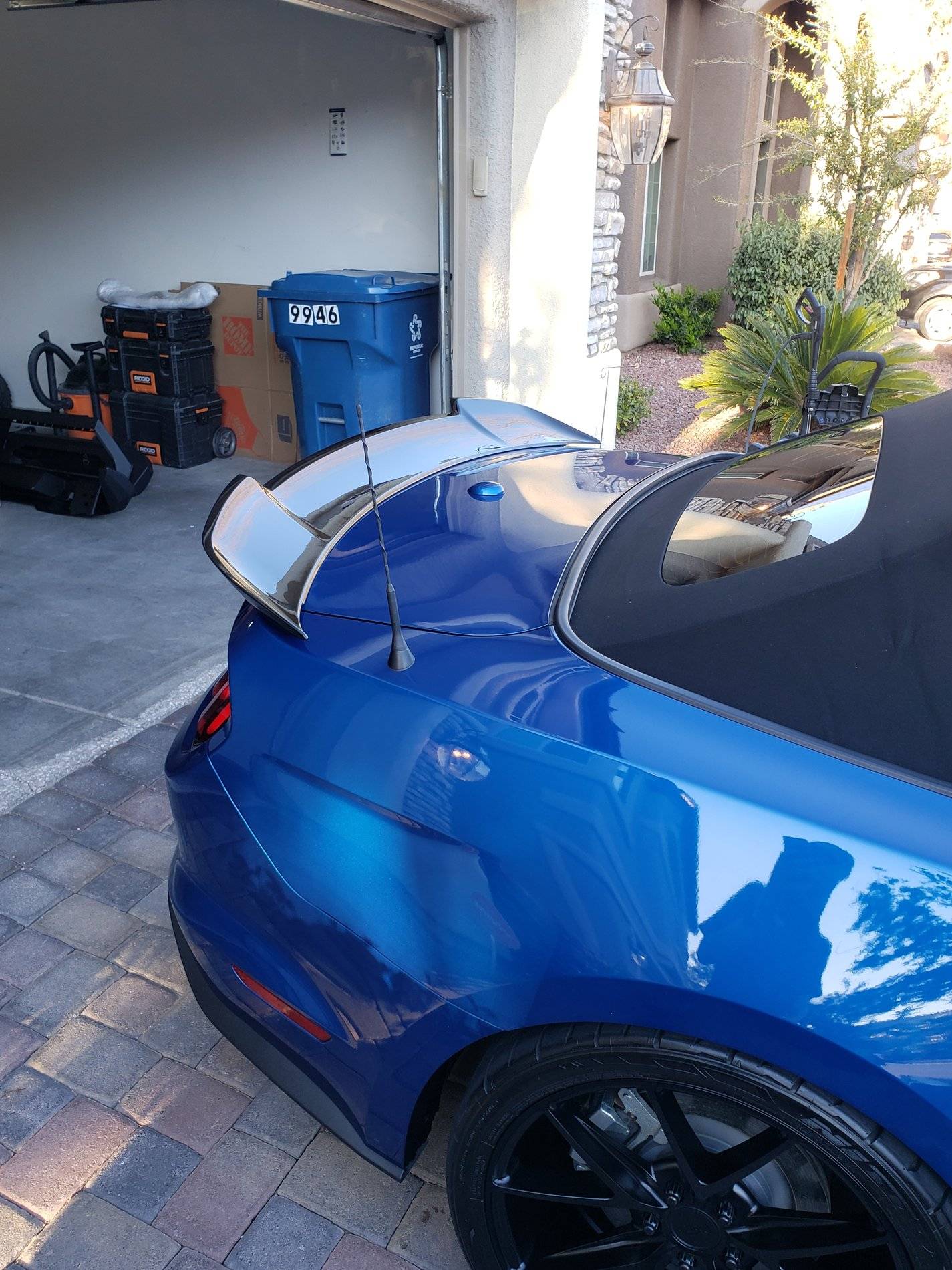

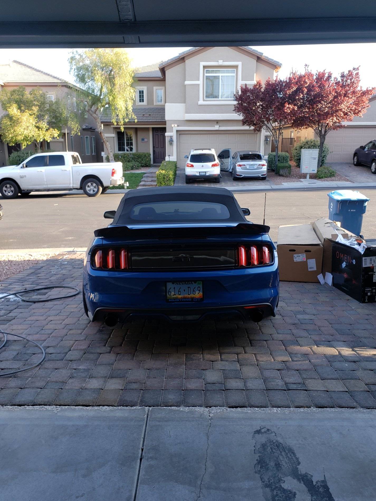

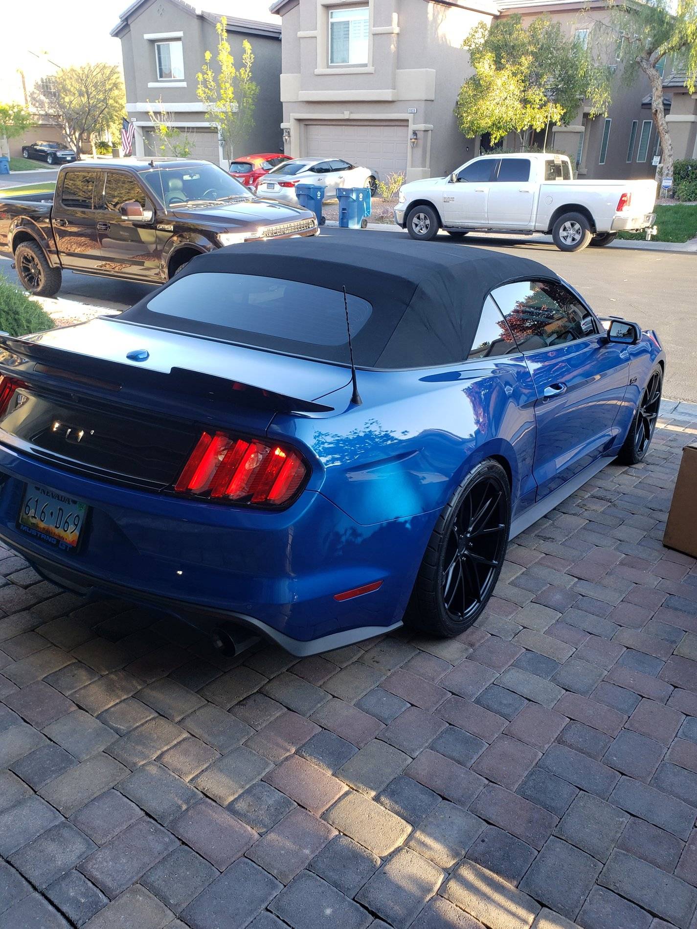

Yesterday I took of the OEM blade and put on the MMD V-Series.. not gonna lie, it was harder than expected with drilling and making sure the screws don't fall into the trunk lid... overall, I like it a lot... your thoughts?

Looks good.
I lost one screw then stopped until I got some magnetic sockets. My spoiler (CDC Outlaw) came with a procedure to mark the hole locations (none from factory) but it was a little off which meant I had to extend them a bit with a rat-tail file; no harm since the bolts and 3M tape keeps it in place.

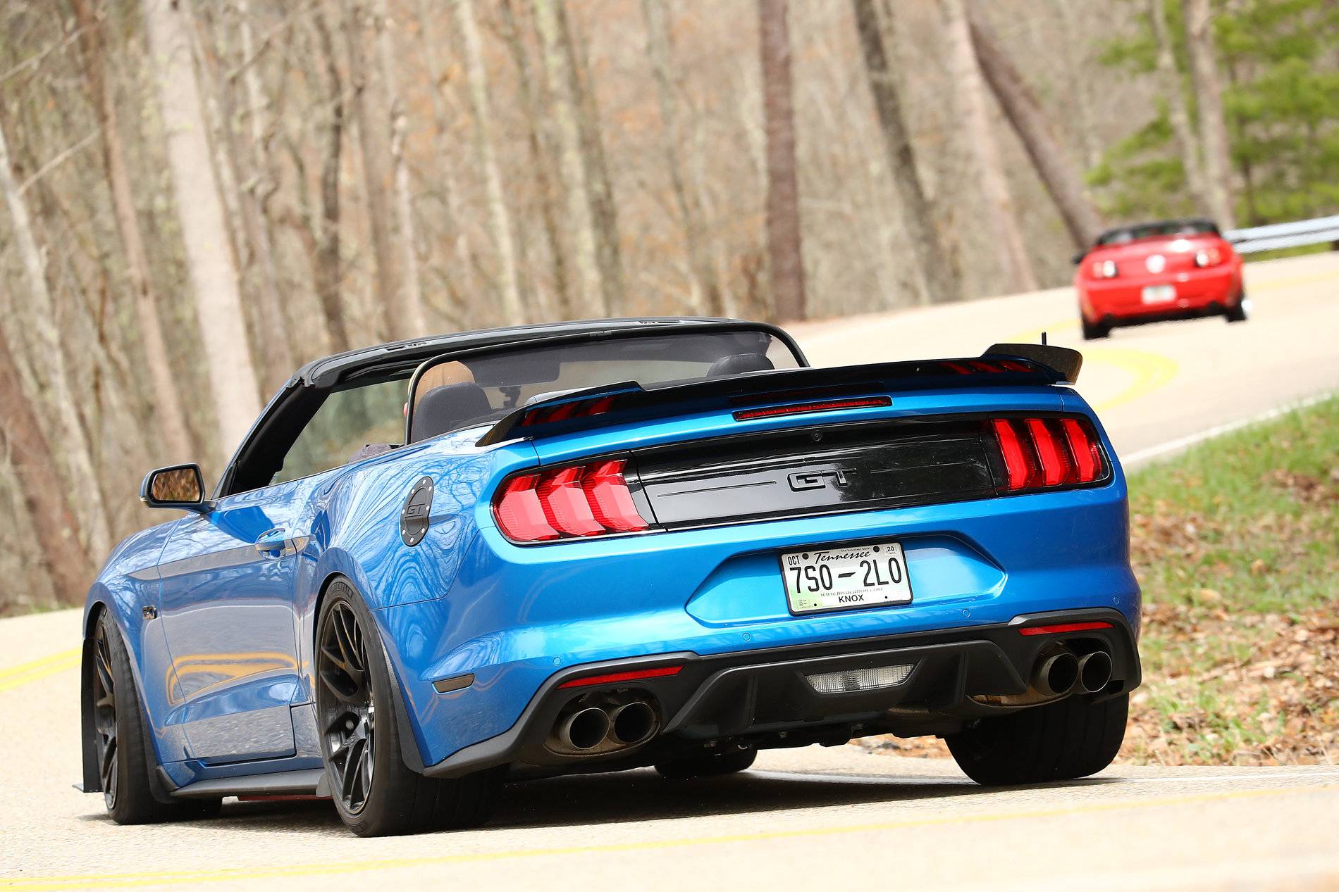

Also, does anyone who has a spoiler NOT made for verts, seeing any stress cracking in the spoiler paint or any other signs, due to the contour of the decklid?
I haven't had any trouble with my MMD-V. I am very happy with it, but the ebay "swing" knockoff from this thread https://www.mustang6g.com/forums/threads/gt350-gt500-2019-spoiler-ebay-150-pre-painted.134086/page-9
...painted for a third of the price is the way I would go if I had it to do over. Both look great, but saving $350 would have been tough to pass up over the Painted MMD-V.
