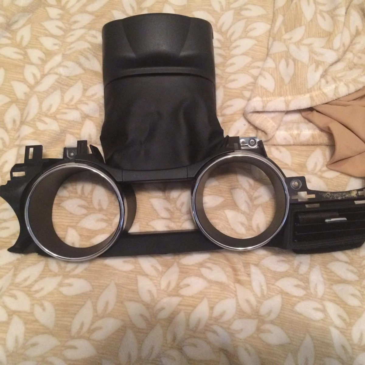

Here's what mine sounds like.

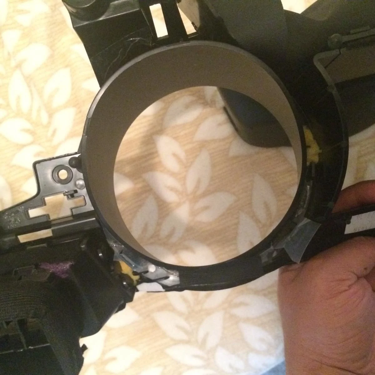

I think it's the gauge pod plastic chrome rings because they squeak when I touch them. Any feedback would be great!
That sounds brutal. I didnt have that much noise. It does seem to be coming from the speedometer area. You have to take it apart and investigate. Try to move things with your hands to see whats actually loose.

Thanks for the instructions. It was a lot of work but I was able to get it done. Though I still hear the popping noise. I noticed that my dash makes the noise when I put pressure on it. Here's a link: [ame]
So hopefully I can find a fix.
