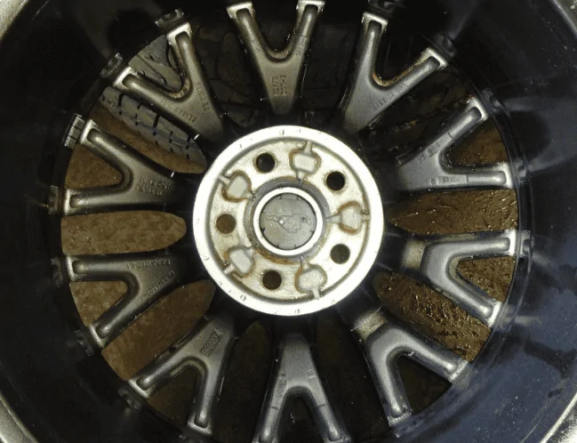

Anybody know if this is the case for the standard GT wheels?
Looks like it judging by this pic (taken of a 19x9.5 GT rear on eBay).
slowhand99
May 3, 2015
61
3,141
944
Surrey, England
Ben
Mustang GT Vert Race Red ord 26/03/15 del 24/03/16
Depends if those cast bits between the holes are level with the face of the wheel or not. Doesn't look too promising. I'll have to take one off.

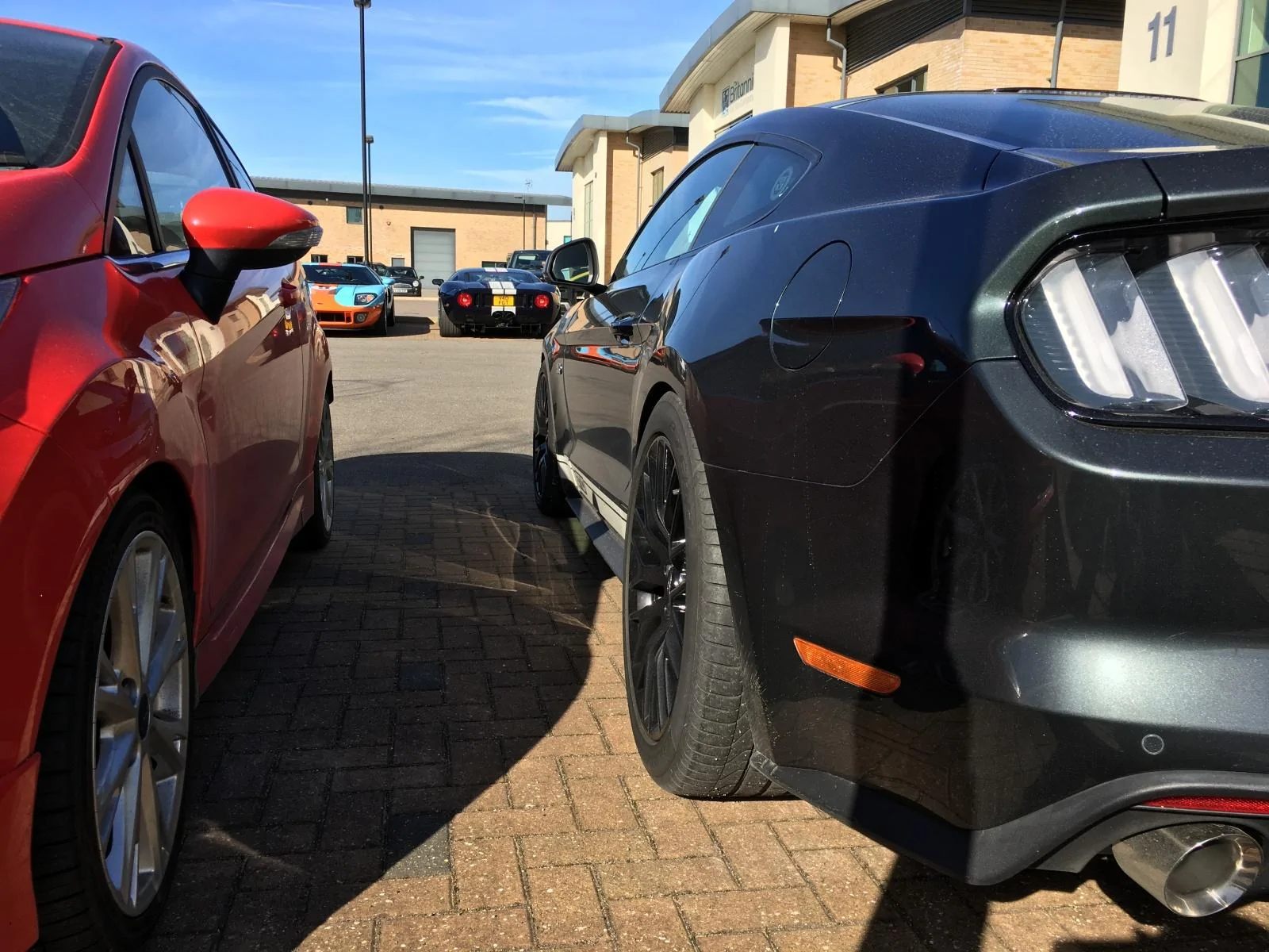

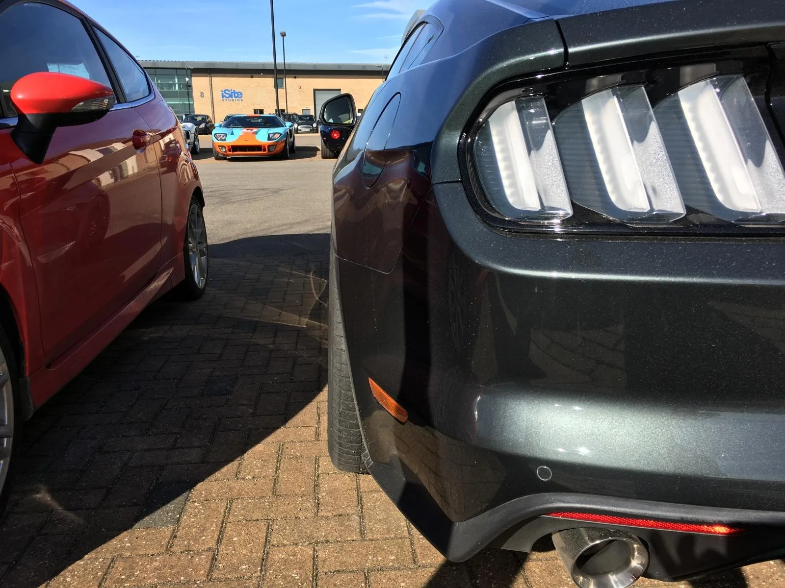

Gibbo makes a good point. As the ride height is lowered the resulting negative camber moves the top of the wheel inwards. Here are a couple of pictures of our car to show the ride height and position of wheel from the back. This is with 25mm spacers.

What is the drop on your car, Dave? (and did you add camber)?

That's lowered by 30mm when comparing it to a brand new standard car parked next to it.
By lowering the ride height the negative camber is natuarally increased by the geometry of the suspension system. There is also a limited amount of adjustment in the top arm joint. It is close to but still inside the OEM spec limits which are -1.2deg (+/- 0.8) deg.
