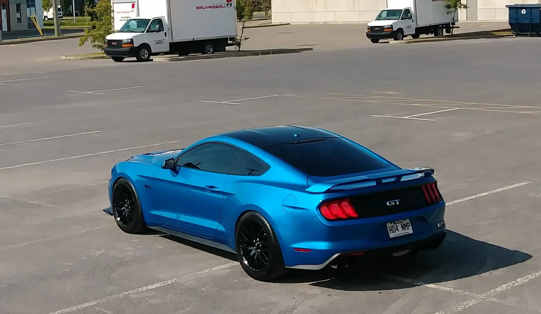

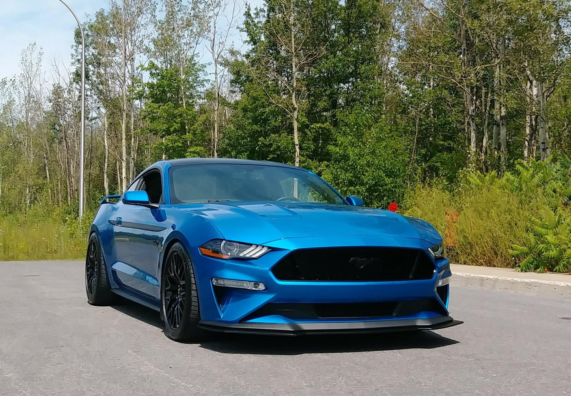

I have ppf in front of my rear fender and i put rock guards ont the front. 25mm front ans rear
