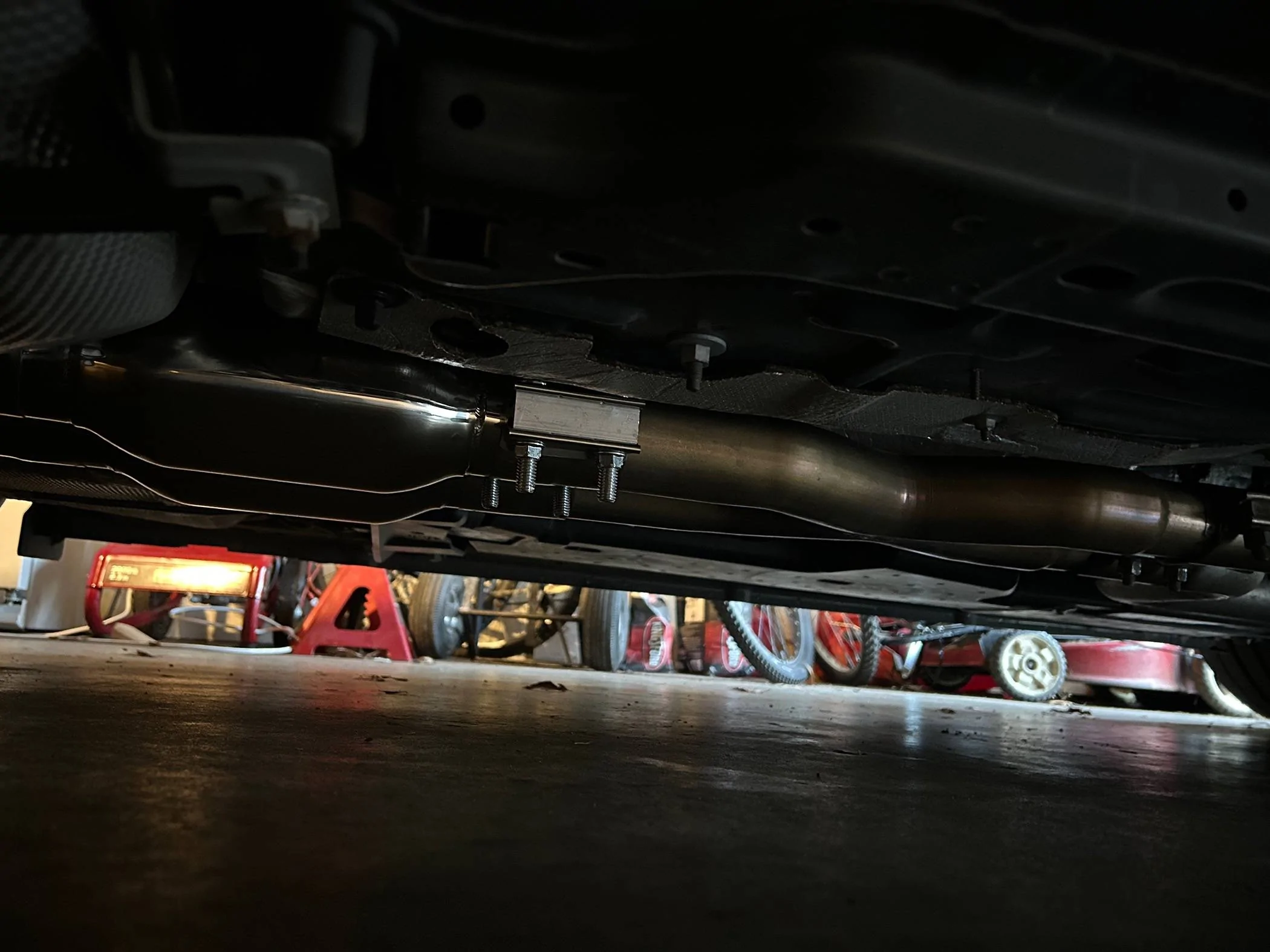

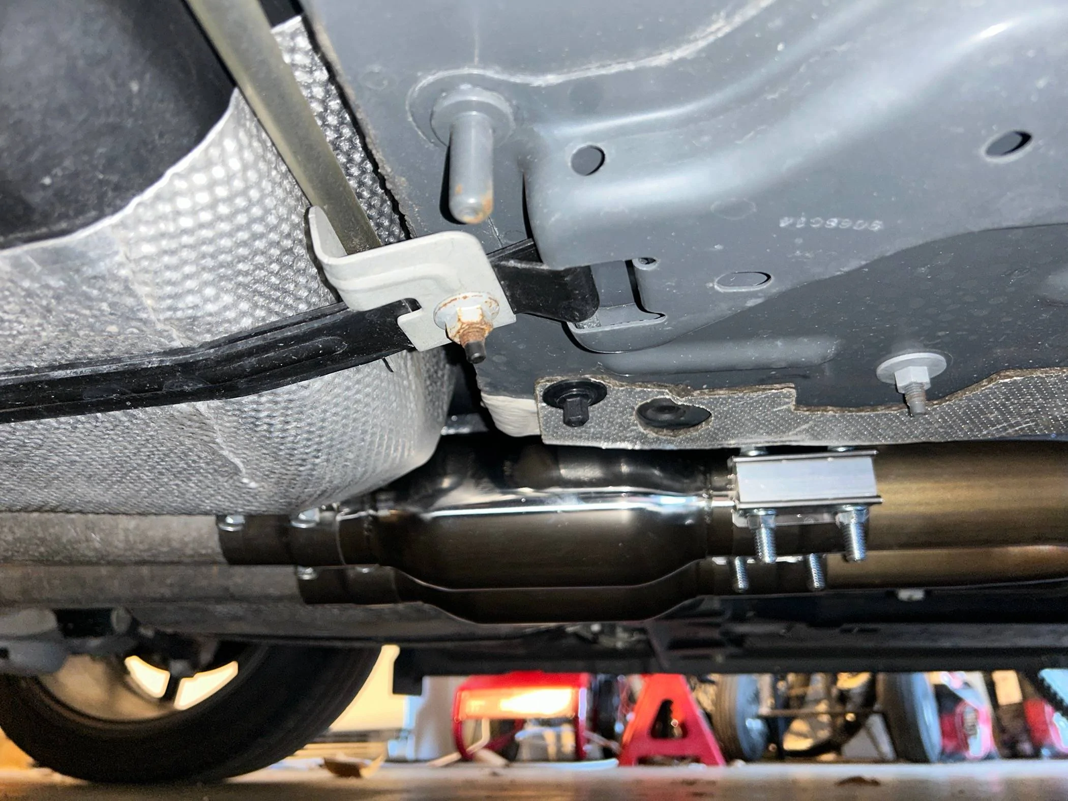

No pics. They tuck up real cleanly on the back of the x pipe. I had the ford performance x pipe butted right up against my exhaust so I just cut off the last 9” or so of the xpipe. The resonators are 12” and 2.5. They slide right over the xpipe and factory exhaust. I put the clamps on with an impact to form them to the pipes and the system is rock solid.
I’ll grab an exhaust vid when I leave lunch.

Got any pics and sound clips of the resonators installed?
Let’s see if I can make this work…
video is:
startup & idle: 1. normal high idle 2. quiet right when it settles into low idle 3. normal/sport/track (all the same).
Revs (quiet, normal, sport, track).
you can’t really hear the decibel difference on video but quiet mode drops the tone and the noise by a lot.
Edit: YouTube to video

Pics look good! Nice job on the install. Sending PM now.

Sounds throaty. Do you think the 14-16” resonators would fit? I’m thinking that’s probably what I’d need to get any type of reduction in sound. Might even need to wrap the mufflers too.

I think they would. Look at how much space I still have on the back end of the x pipe. That’s what I’d go with if I did it again. Just chop off more x pipe obviously.
