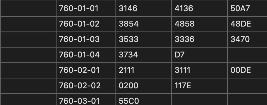

Problem thouth in abs module that I experienced a year ago was 760-02-01 and 760-02-02 is it will not let me make changes.
When I input my oem as built numbers, it says in incompatible config. I am hoping after I re flash my abs modules back to stock it let’s me input those 2 back to oem as built, but I googled and people are saying those 2 slots are for tire sizes and something else to do with linelock or performance pack, distinguishing pp from base cars

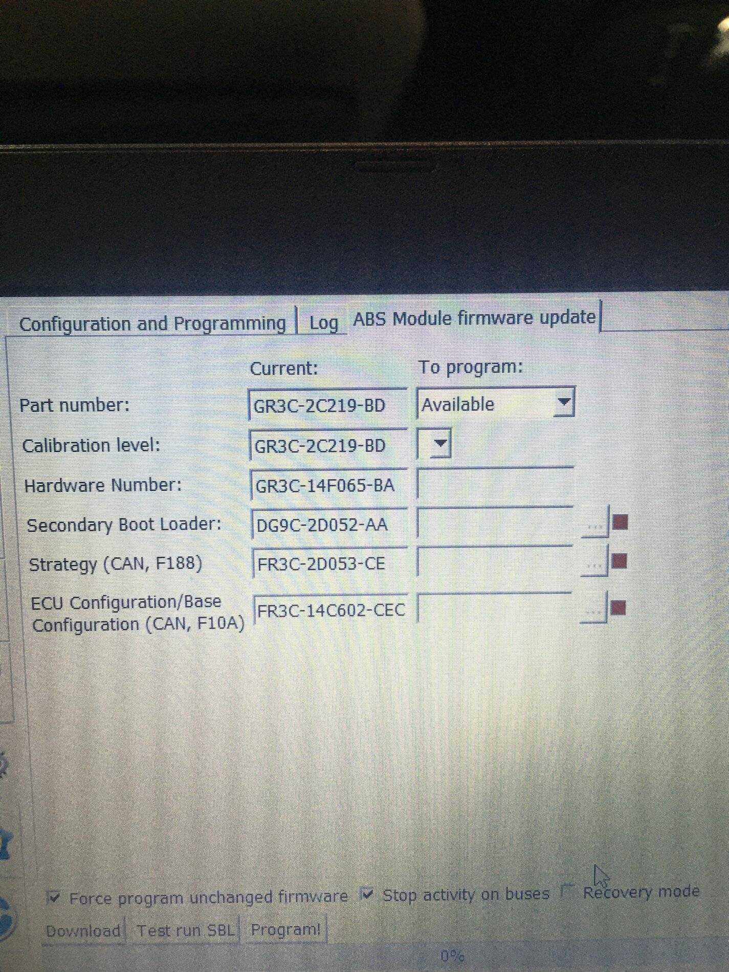

If it doesn’t let me change them back to stock but I have the stock firmwares loaded back, what should I be looking at? I read pcm relearn, abs relearn, etc..
Just want them to damn change. And all goes well tomorrow all my modules and firmware should be back to stock with no dtc’s or check engine lights.
I’m trying to get insight though on those two troubling lines of codes.
Picture shows what they are at the moment, they was changed to these from my as built when I loaded the gt firmware, it just hasn’t let me change them saying incompatible.
760-02-01
760-02-02
Pic has the current digits, and these are it as built. These are the only two codes I’ve been unable to change last year and tonight. But tomorrow I’m trying again after the reflash
The current files flashed to abs module

Only thing I can think of is doing a module reset. Then trying to reflash it.
Should be a reset function in forscan.
