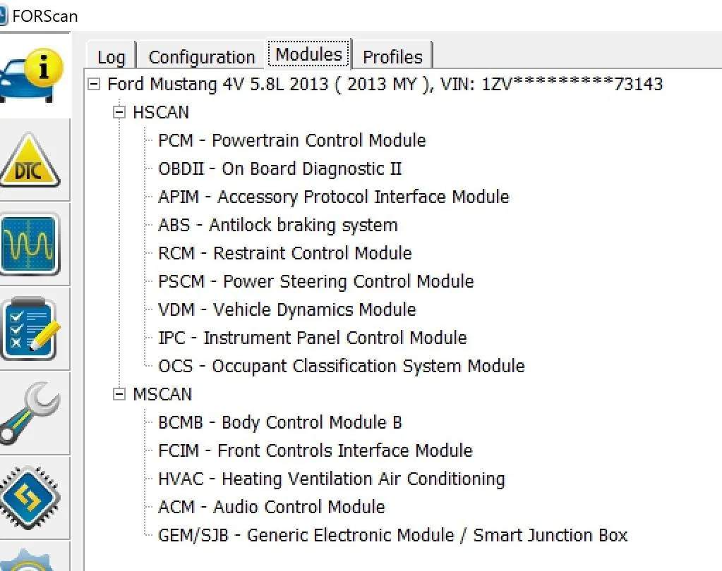

Hi,
I am trying to use Forescan to modify the as-built data on my 2013 GT500. Problem is that I cannot see the BCM module in the module list. Can anybody verify that they can see this in the application? Please see attached for the current list of modules.
I am trying to modify the fog light behavior and that memory address is not listed anywhere. This is what I am trying to modify:
Simultaneous High Beams and Fog Lights location
Code: 726-27-01: 0100 0001 0058 (Disabled)
Change to: 726-27-01: 0100 0000 0057 (Enabled)
Thanks,
Rob
