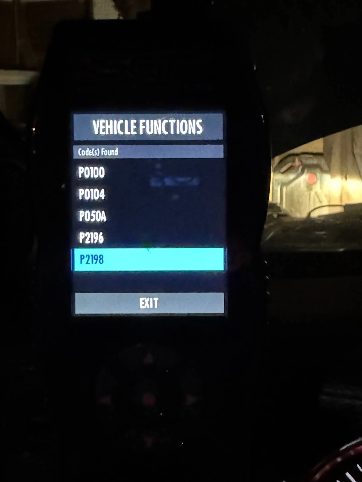

Unfortunately, now I have a new mix of error codes I’m completely unfamiliar with:
P0100 (Mass or volume air flow sensor circuit A)
P0104 (Mass or volume air flow sensor circuit Aintermittent)
P050A (Cold start idle control system performance)
P2196 (too much fuel in exhaust bank 1)
P2198 (too much fuel in exhaust bank 2)
when I first started the car after the install, it has a very rough idle. It almost behaved like it wasn’t getting enough fuel… but that was not the problem. I quickly started to smell and see fuel from the exhaust. It is running very rich. It also fails to idle or start without pumping the gas from time to time. It shuts off when the clutch is pushed all the way sometimes, and it currently not drivable.
The P0100 & P0104 cleared, but the others are persistent issues. P050A cleared, but it still won’t idle properly and shuts off at times.

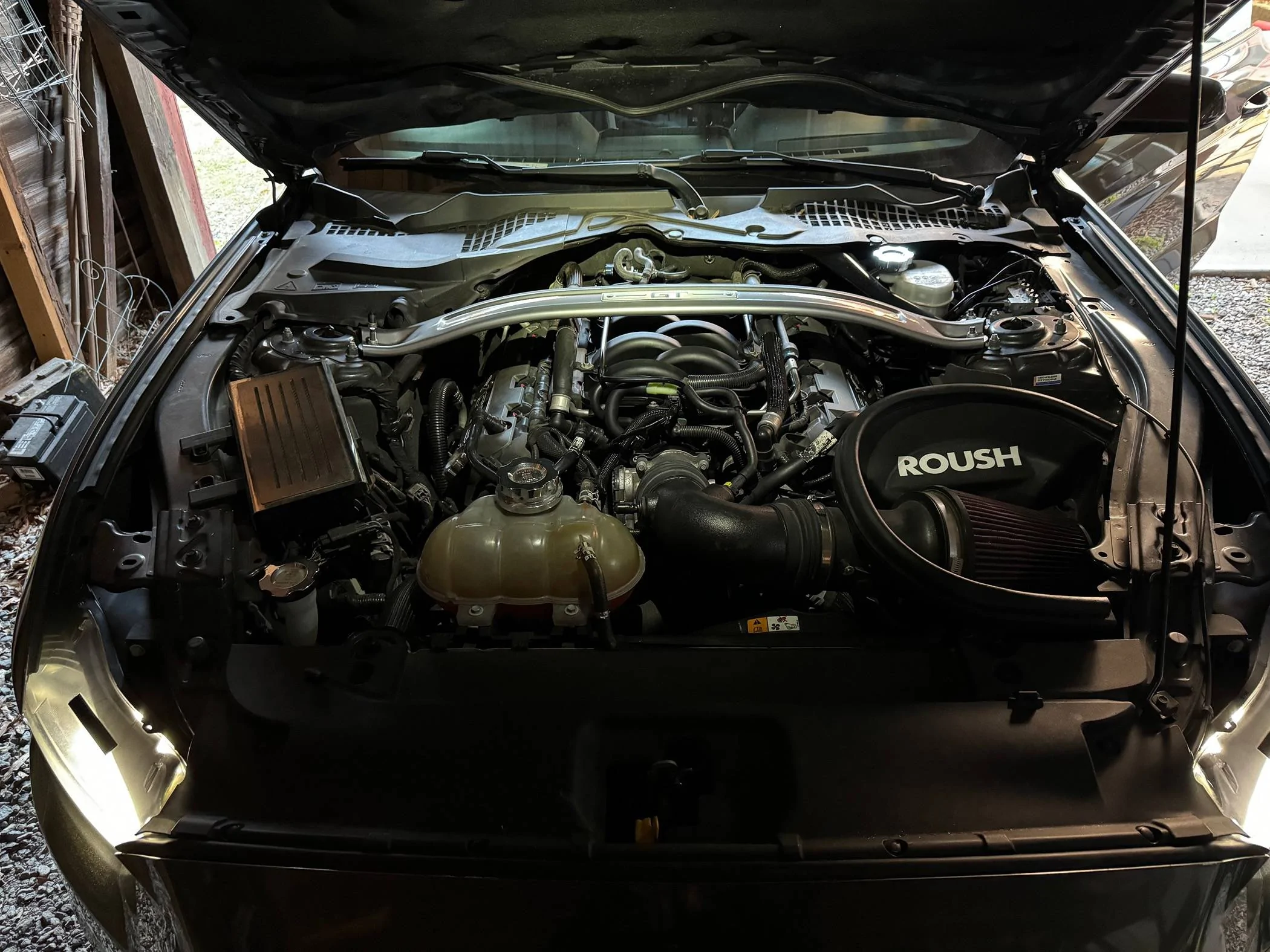

The battery is fine. The 350 intake manifold was brand new. I used an adapter for the throttle body so I could maintain the stock GT throttle body. The throttle body is opening and closing at the push of the throttle. The throttle body was cleaned. The MAF was cleaned. Spark plugs are in good condition. I have performance coils. I have stock injectors.

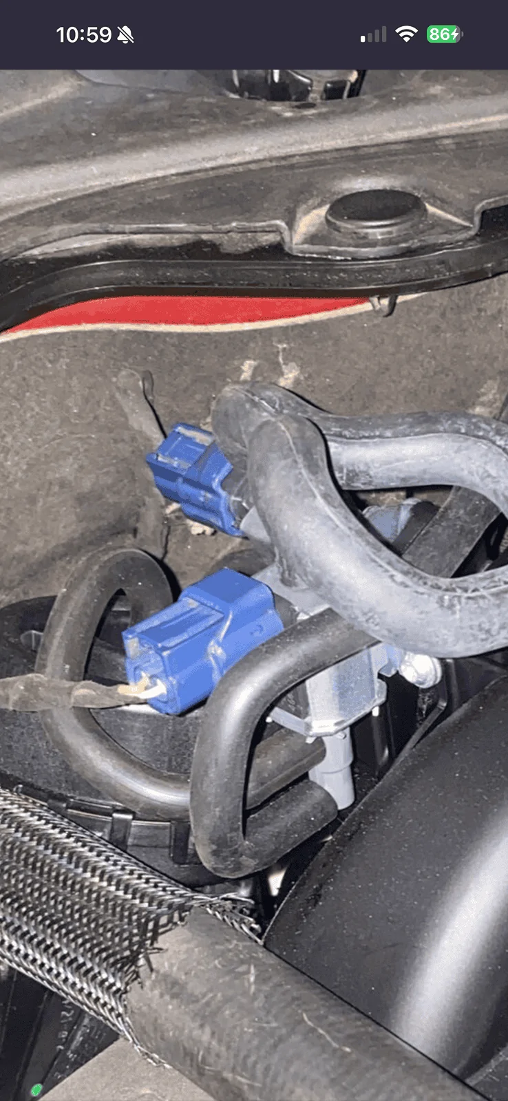

Perhaps when I extended my EVAP solenoid wiring I messed up the harness? I will check EVAP solenoid for proper function today after work with simple test.

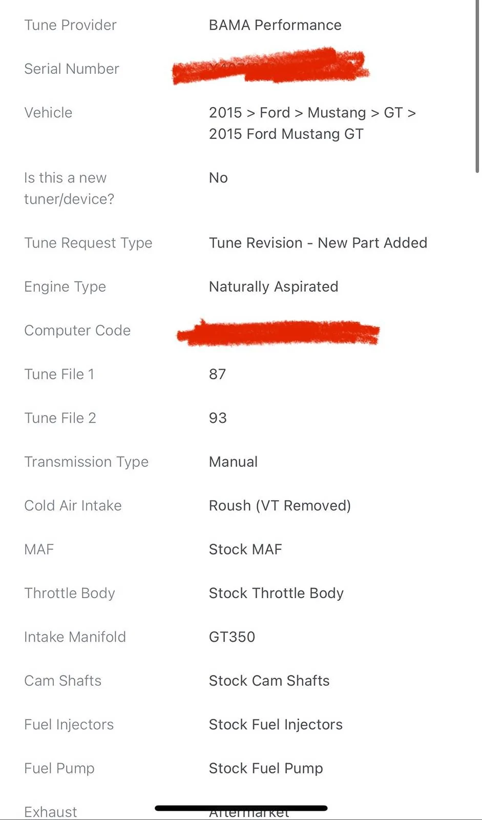

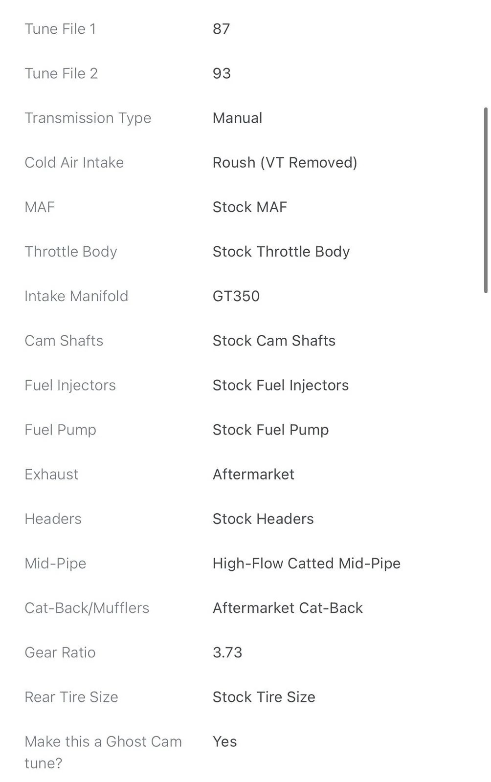

when I sent Bama the info for the tune, this is what I sent them:
I loaded the tune and did not change any of the spark degree settings or anything like that, just loaded it exactly as Bama sent the file.
as far as transfer functions, that’s something I am unaware of. I suppose that’s settings Bama would have adjusted in the tune they sent?

Is it possible my selection of “high flow catted mid-pipe” could be causing these issues? I wasn’t sure what to choose because the options were limited.
In reality I have a resonator delete x pipe with the stock cats ahead of the mid pipe.
not sure if that small option would have effected the tune that heavily. Thoughts?

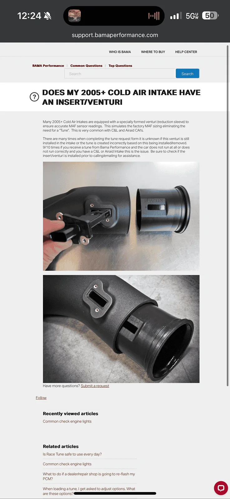

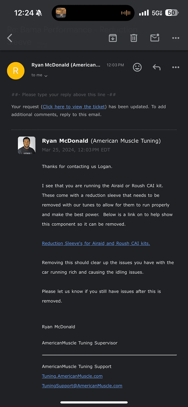

Just heard back from BAMA, potentially there is an insert inside my Roush intake that needs to be removed. I will test this after work and advise. Just sharing info, hoping to help others down the road.
The insert installed would be for OEM calibrated MAF transfer functions.
Off the cuff I’d guess BAMA tune has the transfer functions set for insert removed.

[SOLVED]

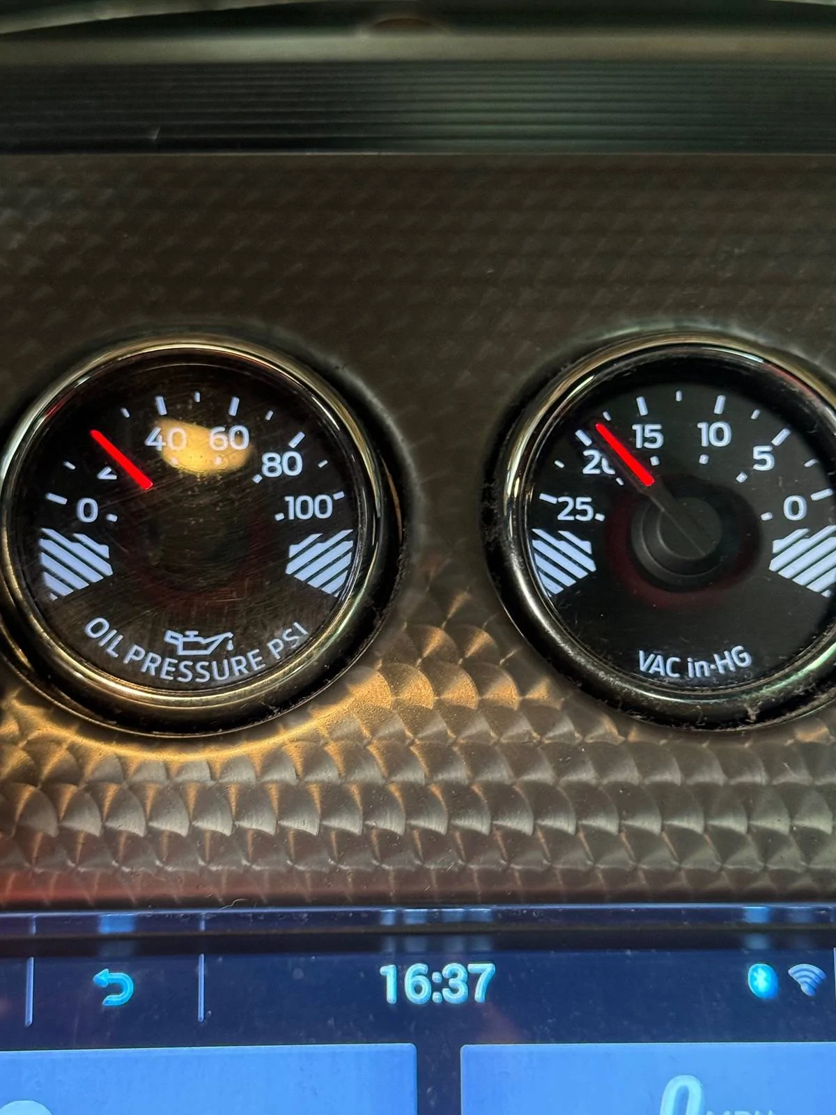

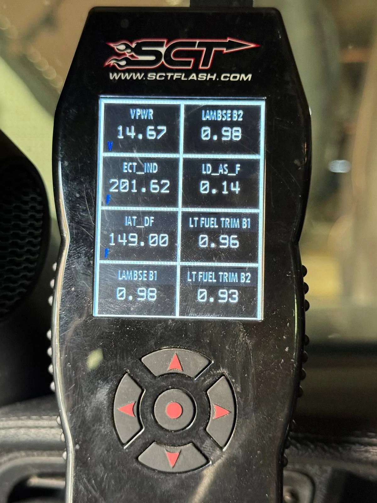

after removing the venturi (reduction sleeve) from the MAF housing the car is running excellently. All codes are cleared. Vehicle is idling as it should, starts right up and sounds mean! Vacuum gauge idling at about 18-20in-HG.
