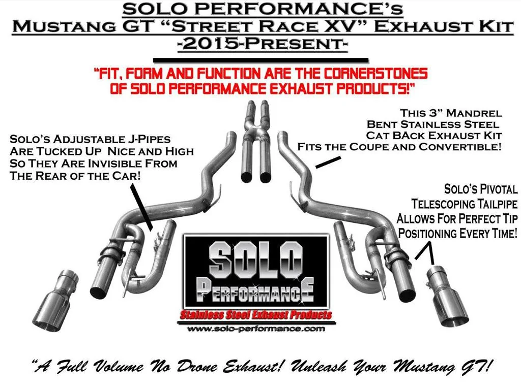

Lmao I'm not bitching about it.. If something is advertised a certain way, people will buy it for that reason.
There's a difference between bitching and providing honest feedback
I attached a picture for your reference

what is the purpose of the J pipes? i am not familiar with those

They eliminate the drone frequency as they're "tuned" by length such that the drone frequency sound enters the J-Pipe, bounces back at the end cap and effectively eliminates itself.
