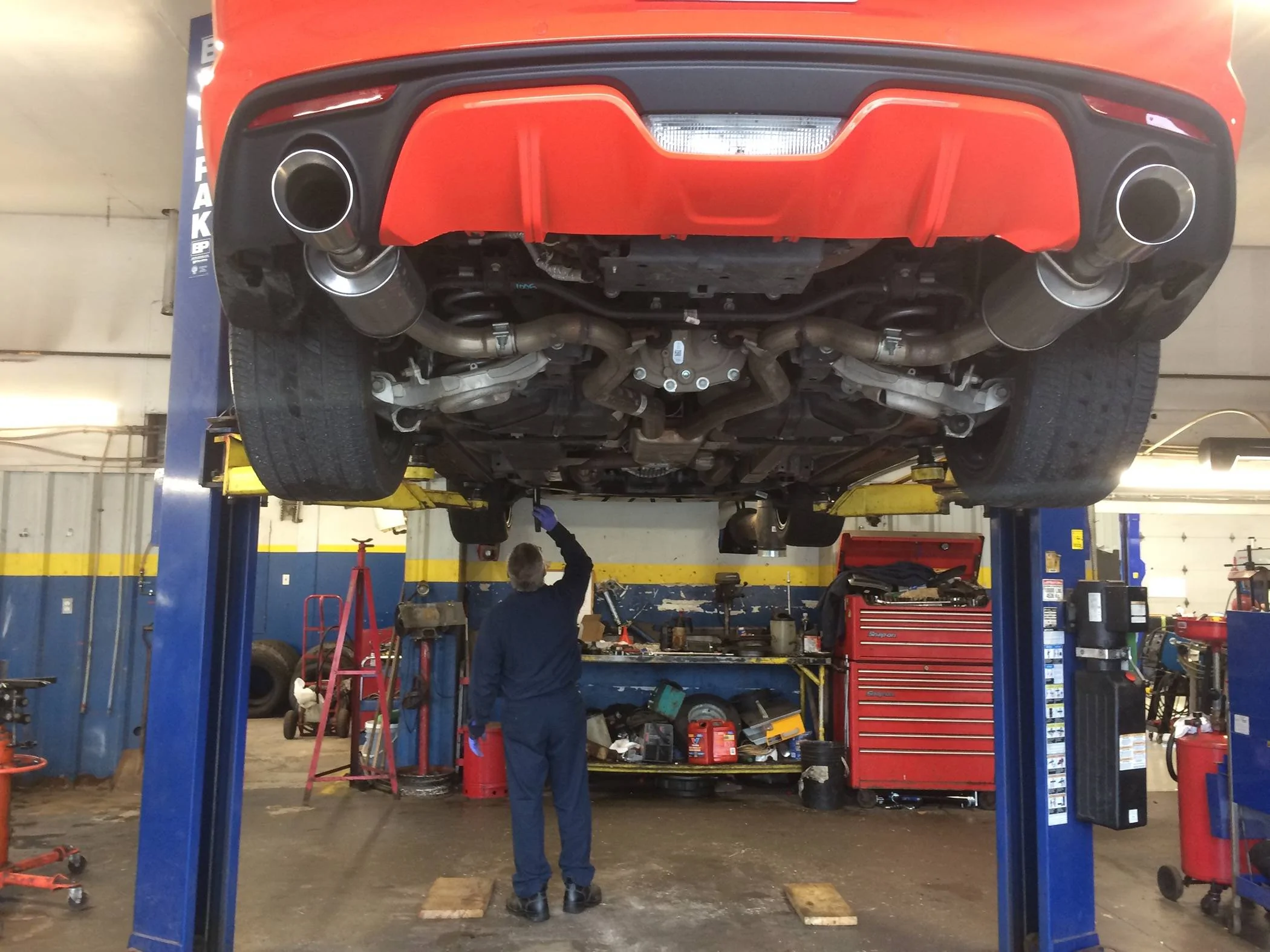

That’s my set up, everything else oem, really like it, no drone, a bit louder than stock.
louder than stock, no drone really like it
