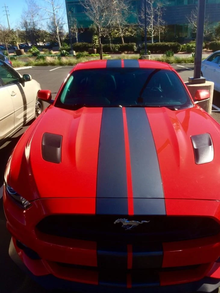

Very nice look. I'll also mention that I'm jealous of your weather...foot and a half of snow here, so mine's not seeing the light of day for a while...Just had the stripes put on, not the best quality picture but I couldn't be more happy with the results!
That's "winter" in San Diego for youVery nice look. I'll also mention that I'm jealous of your weather...foot and a half of snow here, so mine's not seeing the light of day for a while...
