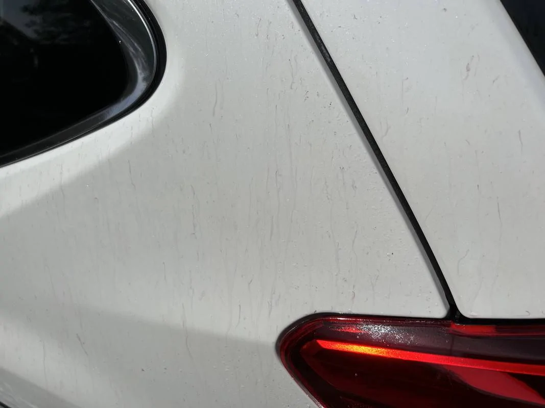

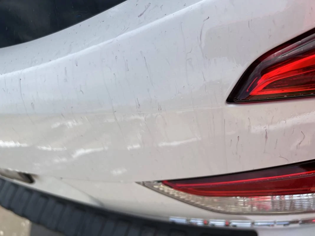

Question. I’m cleaning up my Tacoma pickup to sell. It’s white, so the iron fallout spots are quite visible. I usually use a clay bar to remove them, but the spray on stuff seems like it would be quicker and easier. Do they work as well, or do you still have to go over it afterwards with the clay bar anyway? Thanks.

Start with an iron remover, might need a light clay bar to follow up but the iron removers work well

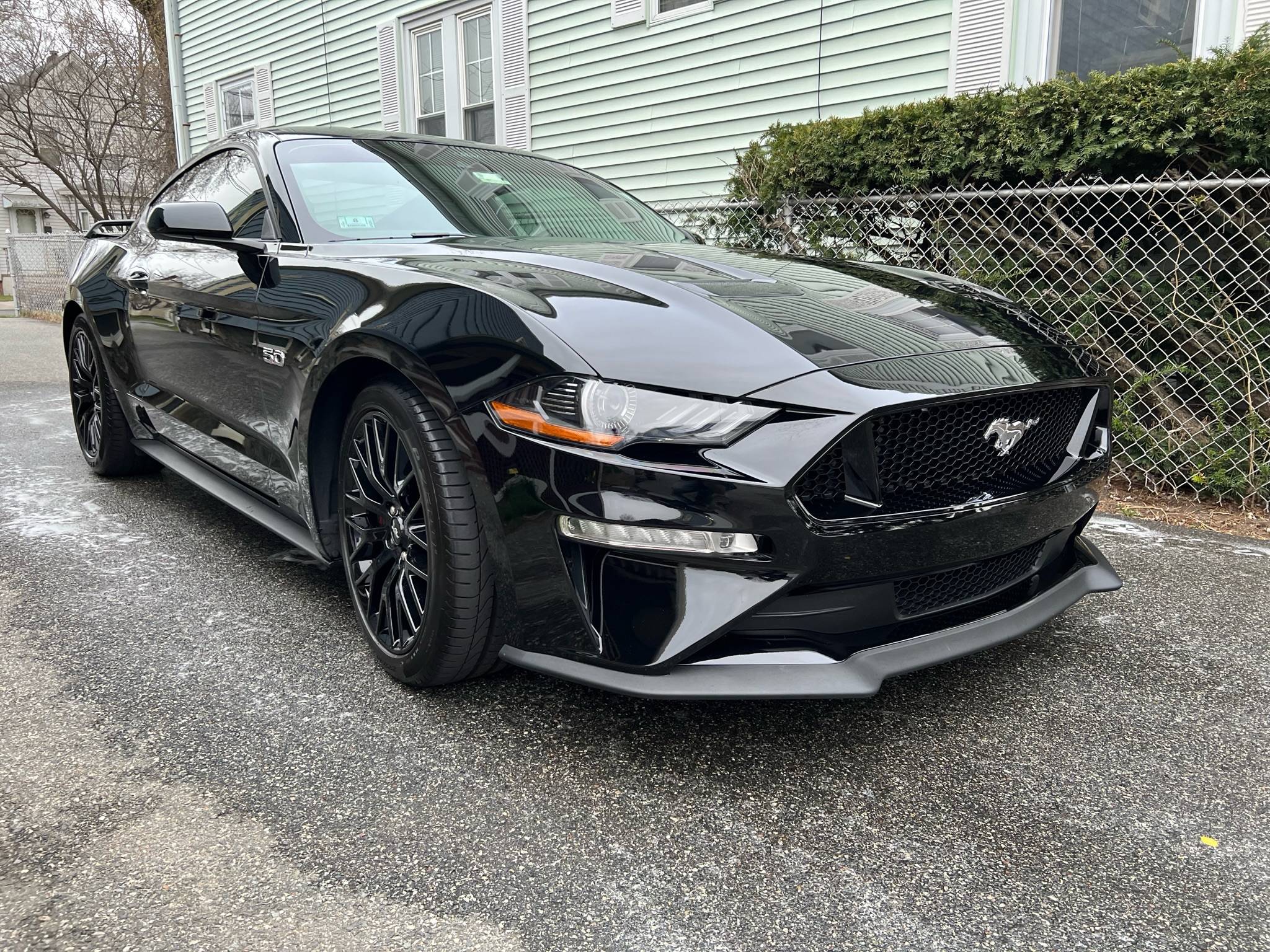

Picked it up from storage and gave it a quick bath.

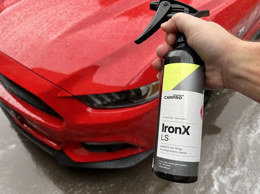

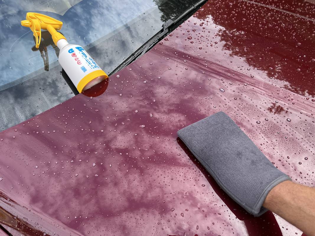

Iron removers are a valuable tool when dealing with paint contamination, helping remove embedded iron particles safely in a touchless fashion. When followed by a clay bar/towel/mitt, you remove anything not dissolved by the chemical.
I've never used the spray on iron remover, how much would you typically use when doing your average vehicle? I have three vehicles to do, so not sure how much I should get.
Is this the same product that you'd use as a wheel cleaner?
Starting with that last question, some iron removers can be used for wheels and paint, some are wheel only. For example, Carpro IronX, Gyeon Iron and P&S Iron Buster can be used in both roles. Something like Koch Chemie MWC and Sonax Full Effect should be reserved for wheels only.

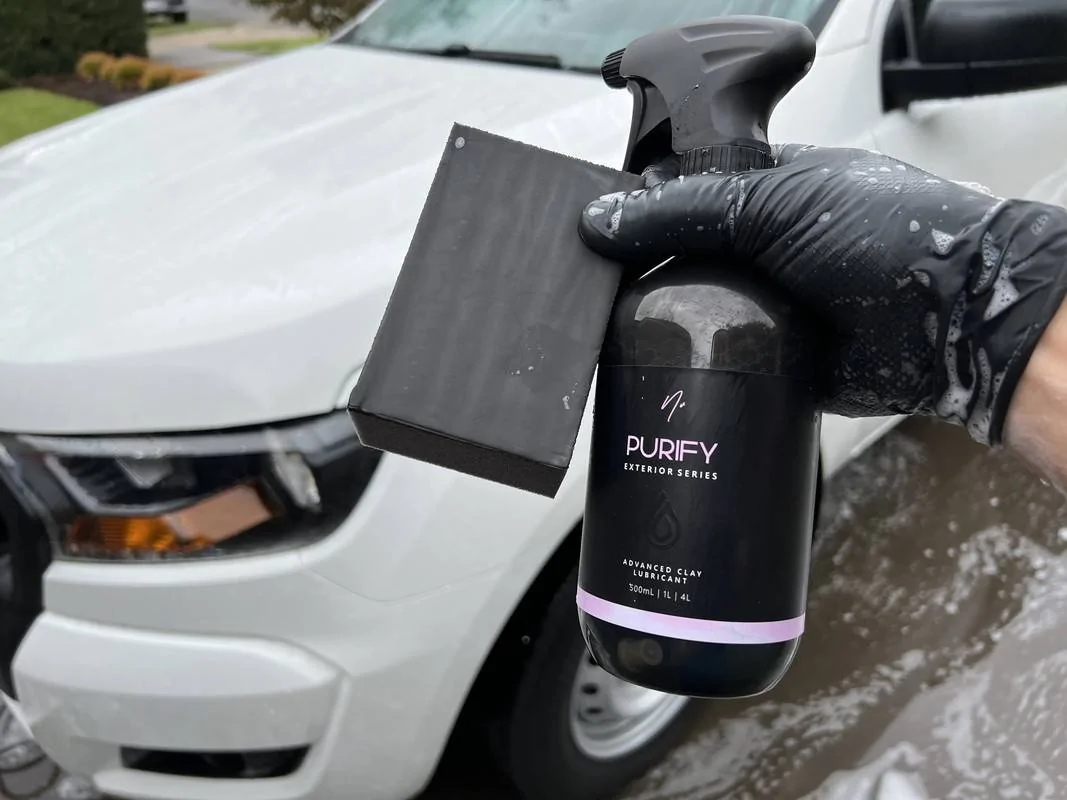

You can also get combination iron remover/clay lubricants, meaning you can clay and iron decon in one step. I have used Carpro IronX and NV Purify for this in the past.
Purify | Fallout Remover & Clay Lubricant – Nv Car Care USA

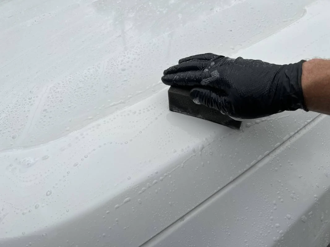

There are a few different ways of using iron removers. As mentioned above, you can apply the product and use it to lubricate a clay bar/pad. In this case, you would have washed the car already. This method is ideal for well-maintained vehicles with mild to moderate contamination.

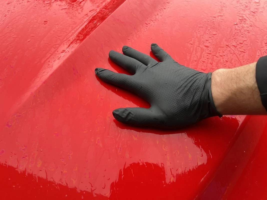

Another method would be to apply the iron remover from dry at the very beginning, prior to rinsing the car. This reduces the dilution of the product and increases the reaction. You would then rinse the car thoroughly after a dwell period, followed by the normal wash process and possibly a clay treatment.
For me, I typically wash and rinse the car as usual. While still wet, I then apply iron remover to the whole vehicle, allowing as long as possible to dwell. I then rinse the car clean, and while still wet, follow up with the clay process using a clay lubricant. I then rinse the car and start the drying process.

- I use about 350ml to 400ml of product for a Mustang sized vehicle.
-Be warned, these products stink to high heaven. Wear gloves.
- Apply in the shade or small sections at a time. Avoid having it dry on the paint. Avoid applying of hot surfaces.
- I tend to avoid applying the product on glass.
- Allow as long as possible for the product do its thing, without letting it dry.
- To increase the effectiveness, use your gloved hands to distribute product across the paint.

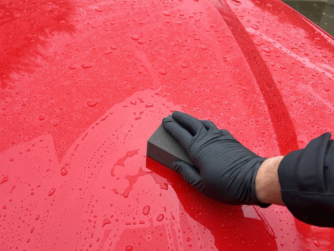

If you haven't already, look into getting a clay sponge, mitt or towel. These are much easier and quicker to use than old clay bars.
