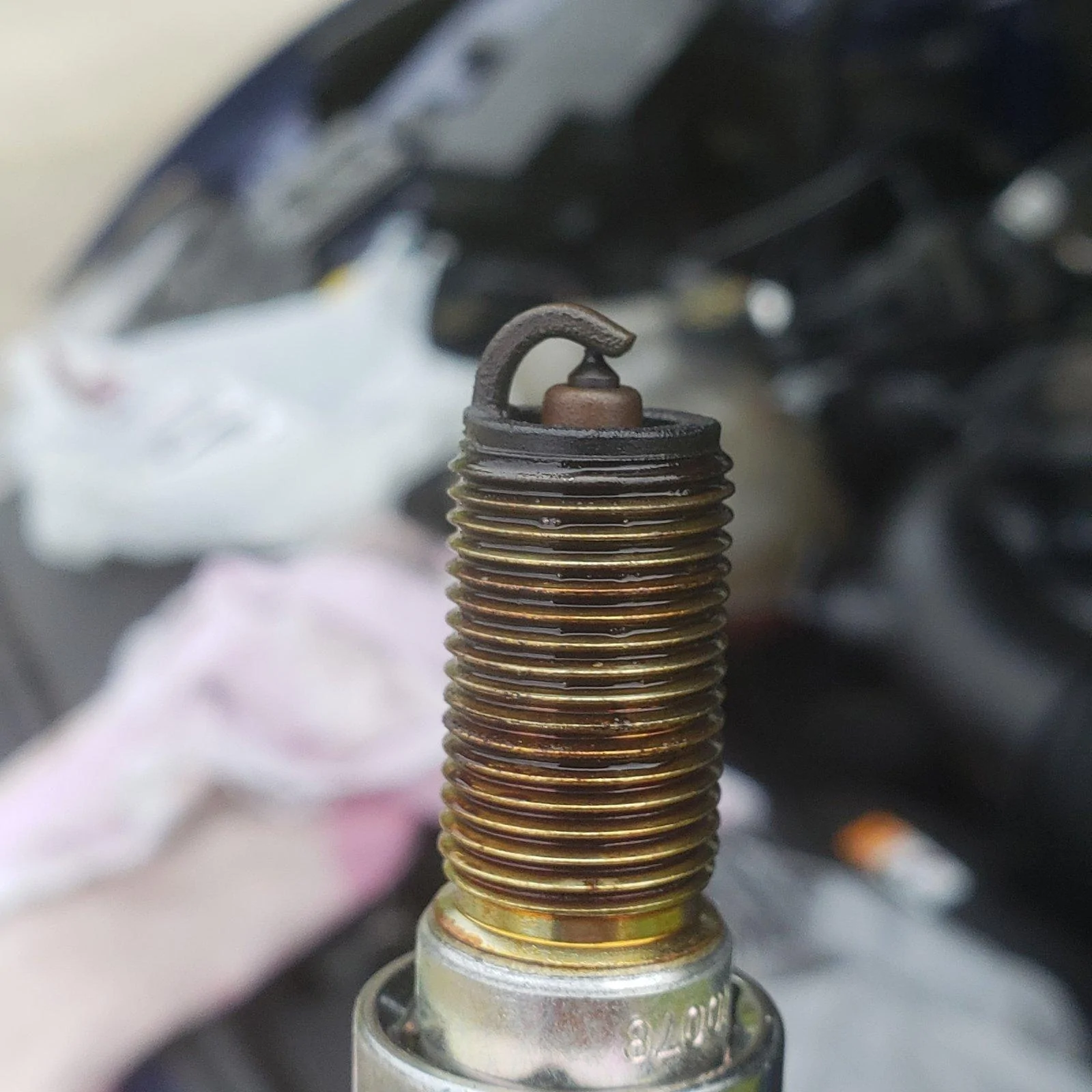

Did compression test. Then did leakdown test. Cylinder 6 had 100% leakdown and air escaped out throttle body.
What is weird is the #8 plug was completely bent (electrode).
What's even weirder? Not a single code or DTC.

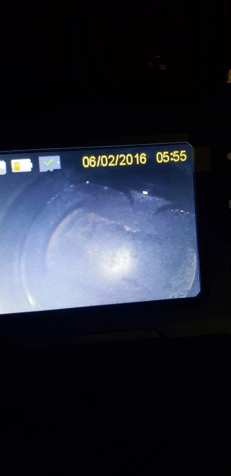

Boroscope of 6. Piston looks good.

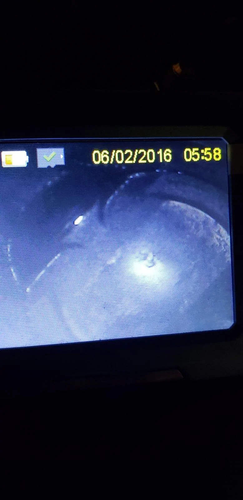

Another view3
