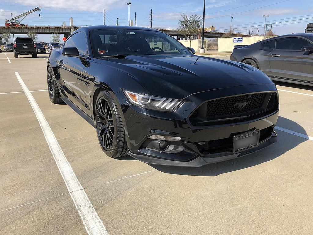

Eibach springs 1.5" lowered with 25mm spacers up front and 20 mm in back. Be advised the 20 mm in back interfered with the wheel studs so I had to drill out the stud wells in back of the wheels to 5 mm to accommodate the studs. You really need to watch that stud clearance when you purchase wheel spacers. It's not always plug and play.

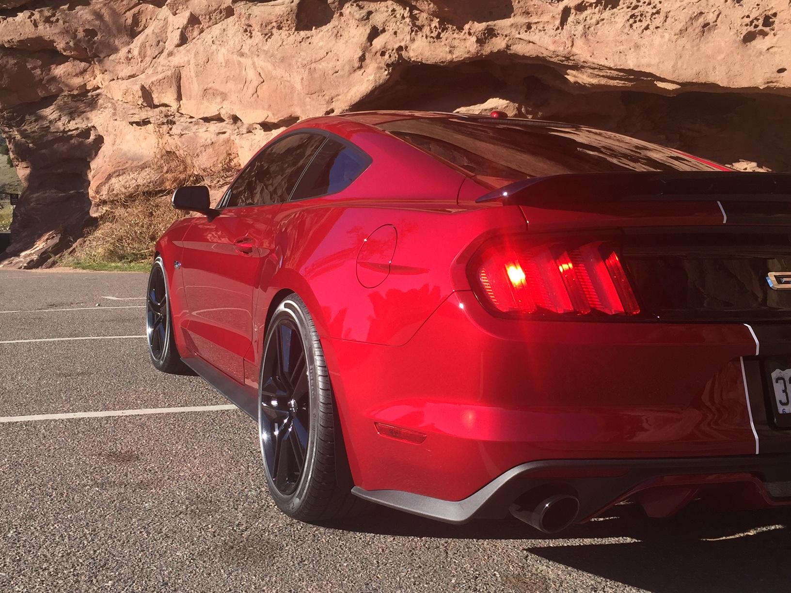

Coyote 25mm spacers front and back, EB PP wheels, 255/40/19 tires, Steeda progressive springs, no problems with ride or rub.

Thanks MUSTANG GUY...are those.wheels lighter than the GT PP wheels?

The EB PP wheels are 19x9. The GT PP wheels are 19 x 9 front and 19 x 9.5 rear. I would guess they are pretty close in weight.
