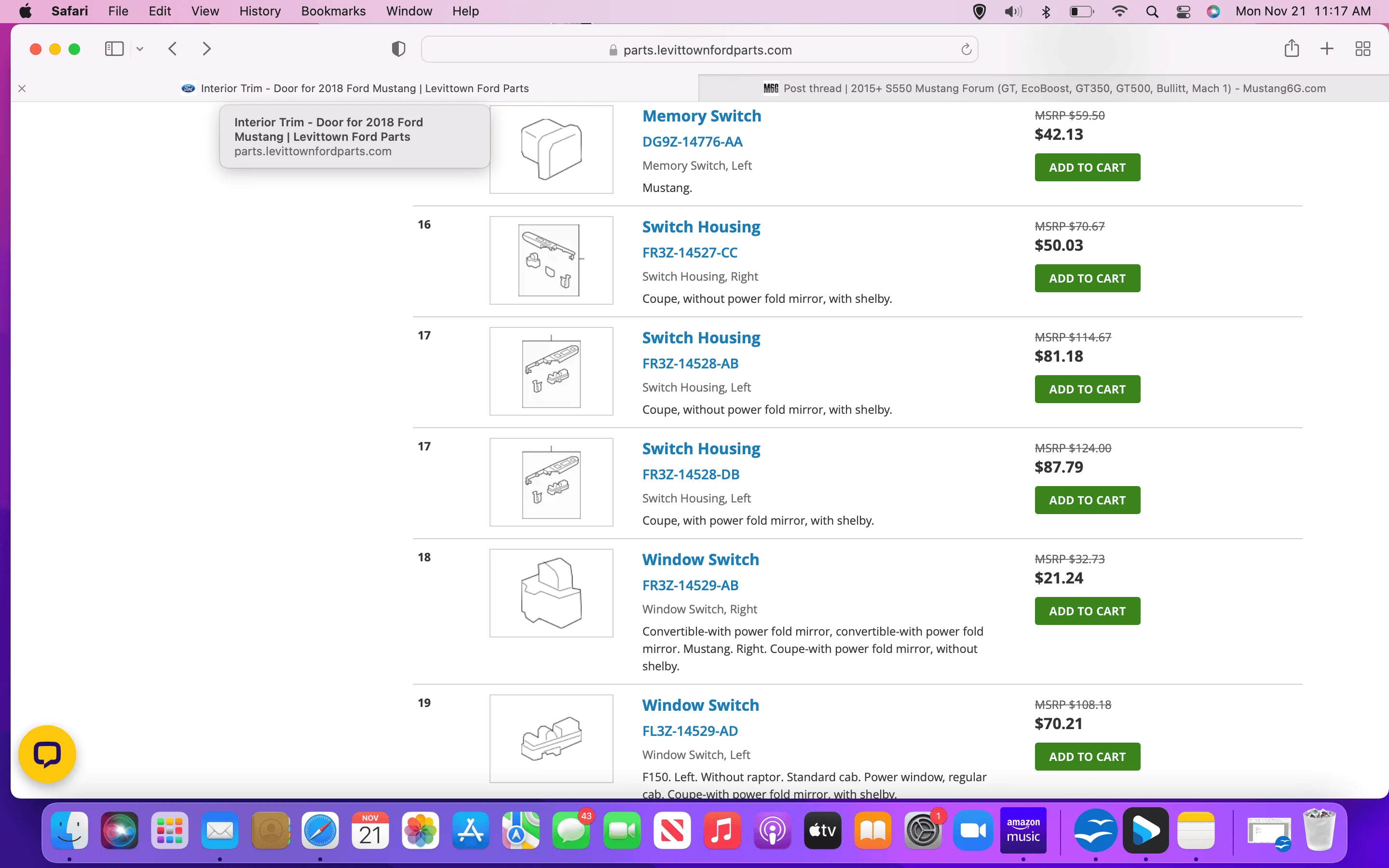

But I have a question that has never been mentioned to my knowledge. In replacing my door speakers, I broke the window switch housing where the window switches snap into. So basically every time I push down on the window switches, the whole unit pushes down into the arm rest panel. I tried glueing it but it didn't last long so I'm going to replace it at the same time.
My question is this... on the parts diagram it lists two switch housings (Part 17)
Switch Housing
FR3Z-14528-AB
Switch Housing, Left
Coupe, without power fold mirror, with shelby.
And
Switch Housing
FR3Z-14528-DB
Coupe, with power fold mirror, with shelby.
From what I can tell, the window switch comes with the housing as a unit. So if I'm buying new shelby mirrors, is there a chance the power folding option will work? I wasn't sure if the 19-20s had power folding but would love this feature if available.

Folding mirrors are a UK feature - the US spec mirrors are smaller and lack the internal hardware to fold. You would need the mirrors themselves, the switch, door wire harness, probably module programming, and maybe other things...not an easy swap-plus, I don't think they fold compltely flat, AND those mirrors are physically larger than US spec mirrors.

ok thanks. Appreciate the info, saves me a headache then and will order just the regular housing.
