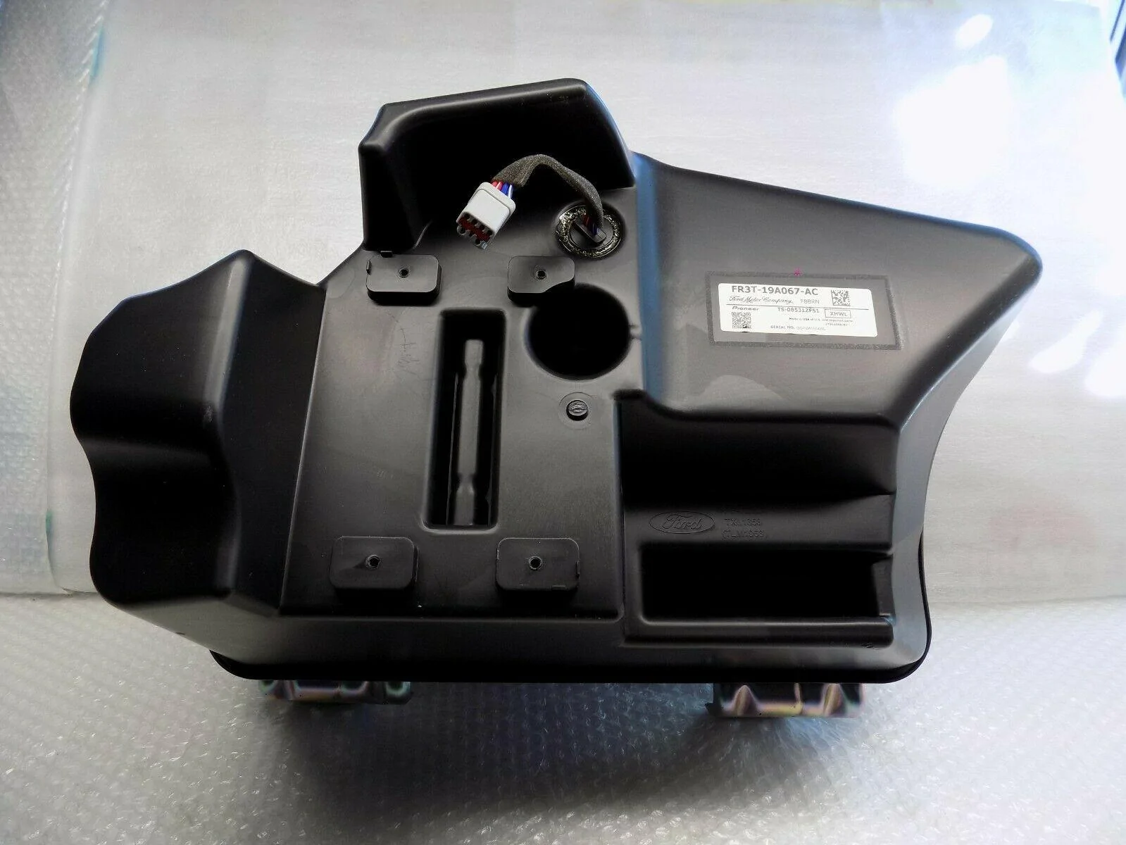

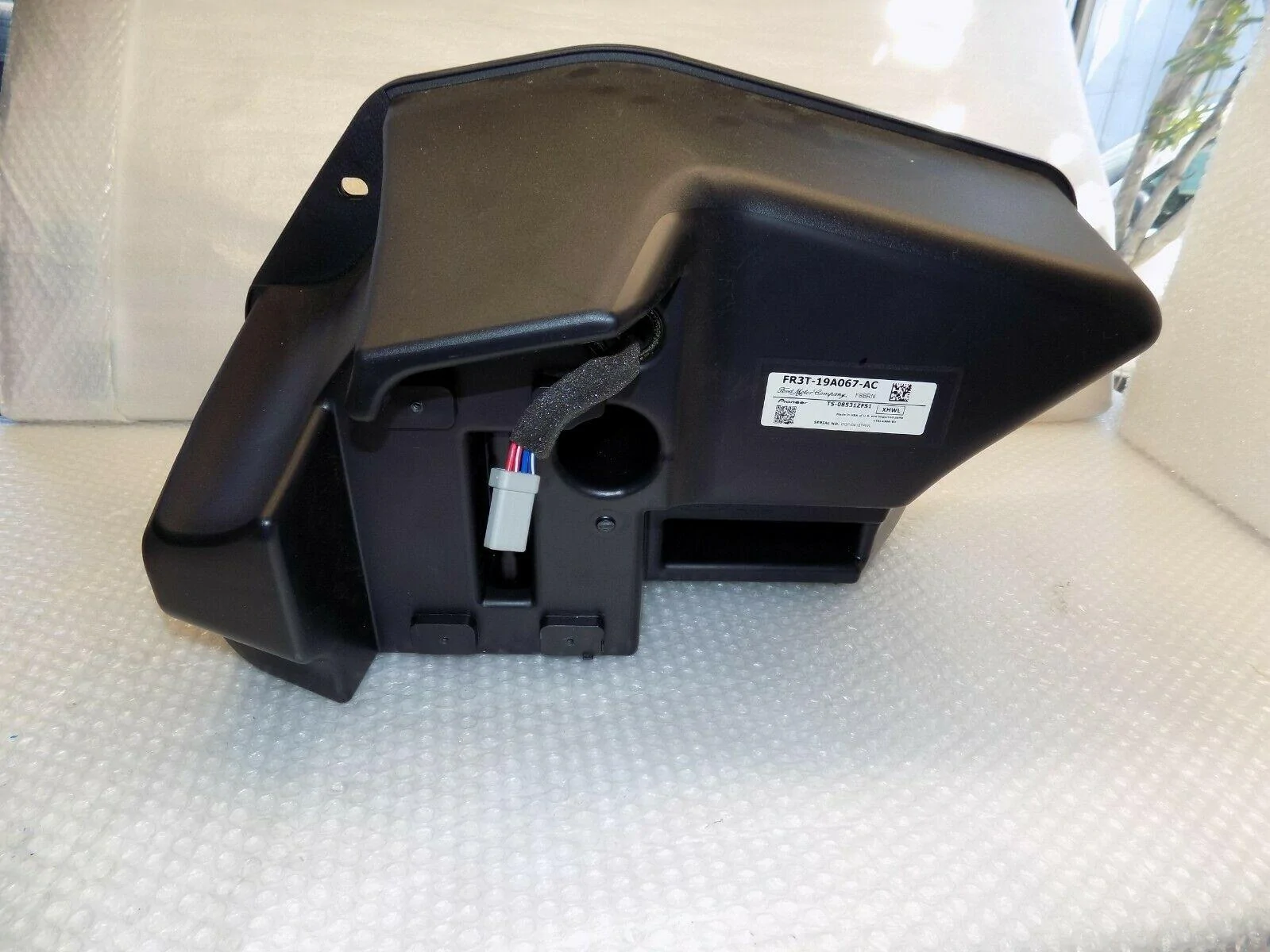

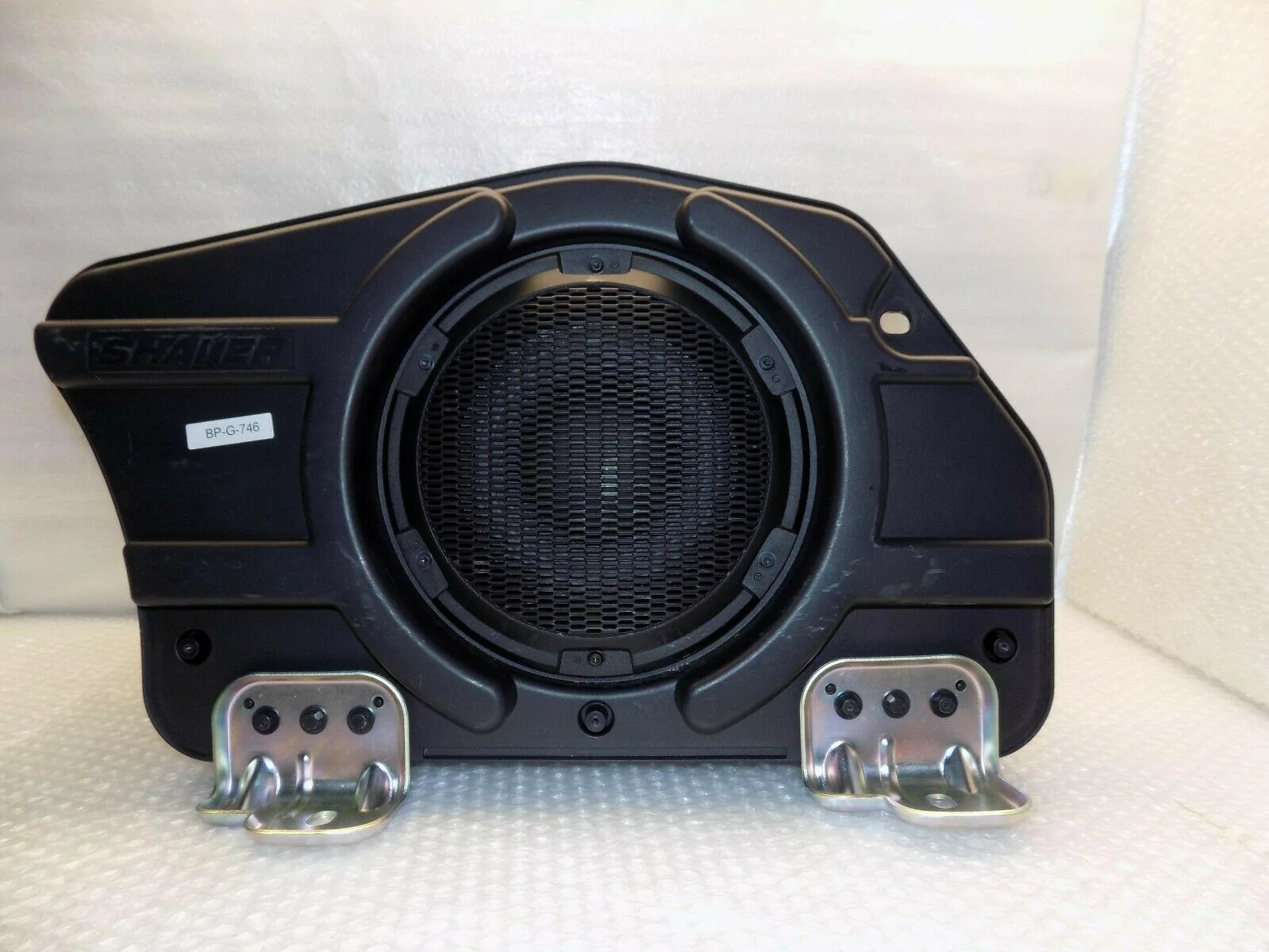

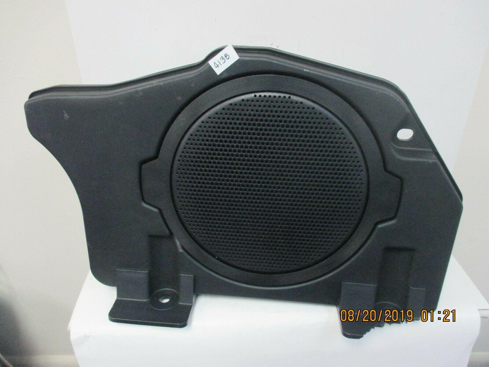

In case anyone is interested, the PN for BO sub enclosure is KR3Z-18808-A. I'm not sure if it would fit in the same bracket as a 2018 model. There appears to be some differences in the shape overall.
Here are some pics i found on eBay.

It's very unlikely you will be able to physically fit a 10" driver in a blow-molded enclosure designed for an 8". Even if you could, the airspace will likely be way too small and the driver won't perform even near it's design parameters. Not even worth trying IMO. It's not likely that you could purchase the just the B&O enclosure without the driver from the dealer. These types of things usually are sold as plug and play complete replacements.
The driver swaps that have been found to work well were discovered through a lot of trial and error. Every driver has different TS parameters. E.G. no two drivers will perform the same in the same sized box. I would suggest trying the Rockford driver that many others have found to be a great swap. That's the cheapest and easiest upgrade that could potentially make you happy.
If that isn't enough for you (it never is ;) ) then you're looking at something like a JL Audio Stealthbox or even a traditional 2x10 or 2x12 box with an outboard amp. Bass takes space; the more bass you want, the more space you have to give up.
