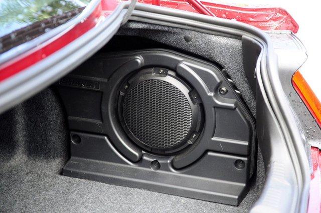

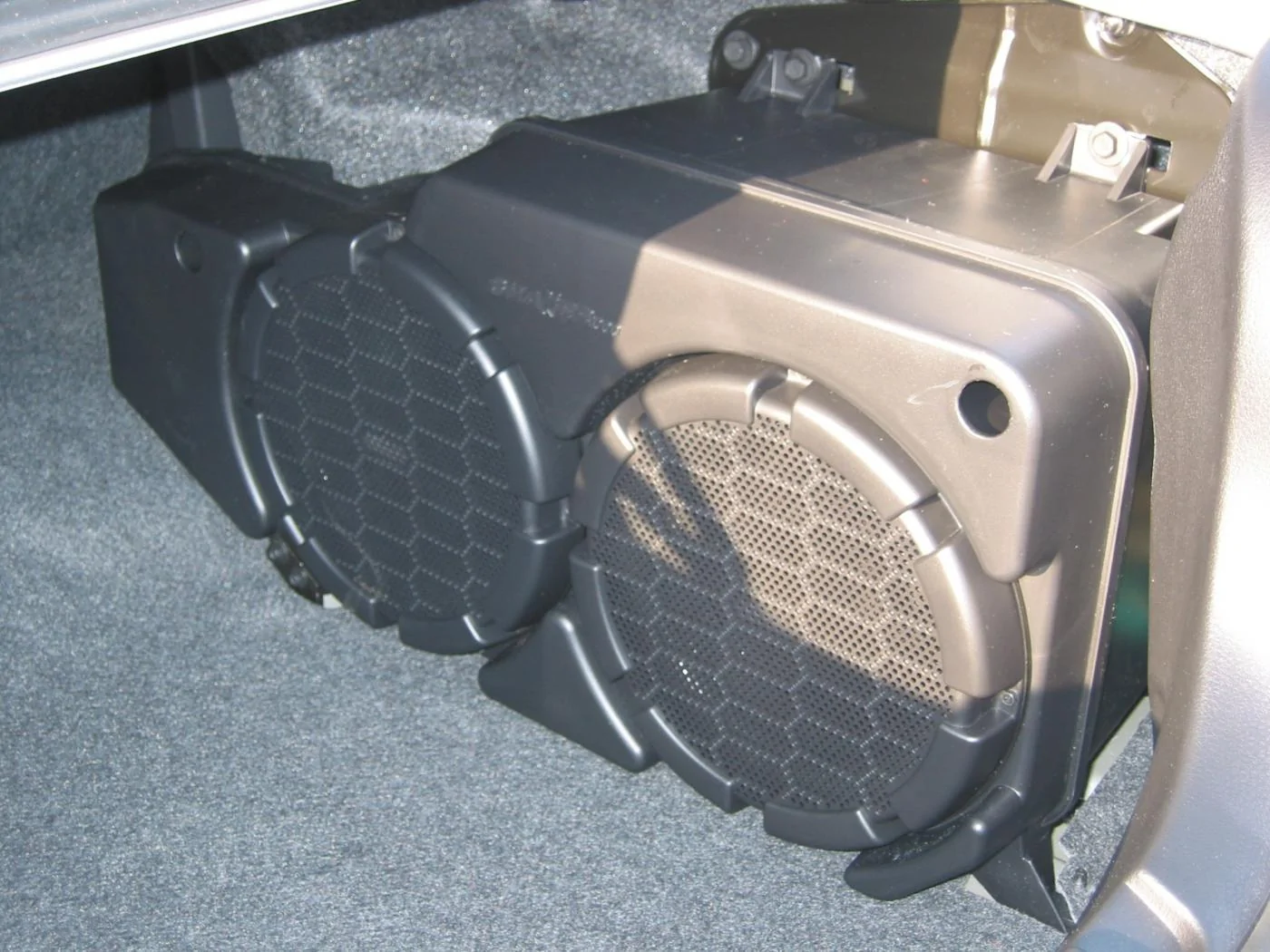

I did adjust the bass/treble/midrange and again, the sound is pretty good but the track I use to test any new system is (oddly enough) the Jurassic Park soundtrack overture.
It has a great range of trumpets and strings and deep bass... and the very end has a rolling bass that in the old shaker pro system produced a great deep rumble.
The newer/smaller subwoofer comes nowhere close. I don't want to be going down the road thumping but I do want that solid deep bass when it's supposed to be there. The new system simply doesn't provide it.
The attached pics are of the old shaker sub and the new one. Pretty obvious why there is a major difference! lol
