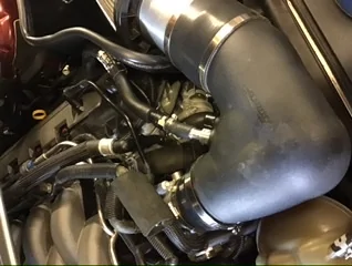

The JKL I’m using does not touch the hood at the tube to TB area, it’s the air box seal portion that’s seems to be up too high. I think I’ll try Wildhorses suggestion and change the seal type.
Before the JLT with the 18 intake and a PMAS CAI the tube closest to the hood was touching. You can see in this pic the rubbing area.
