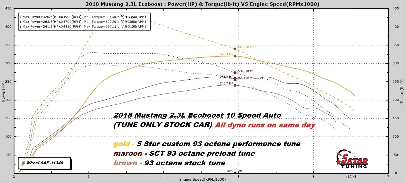

Yea not seeing a lot of info on the canned tunes, interesting. Guess I'll go it alone and report back...haha. The gains from the canned BDX seem pretty moderate compared to the gains claimed by 5Star tuning, so as long as I'm not pushing limits w/ the BDX I'm comfy proceeding for now unless 2.3L powertrain issues seem to develop between 30-50k mi. that I am not aware of.

Took the latest firmware, then pulled vehicle info and reconnected to laptop to pull the tune(s) down. Only seeing ability to adjust octane and shift/rev limits, as well as tire size and diff. ratio.
Once reconnected to the Stanger again, it applied the firmware and took forever to flash, but got through it. Should have dropped that trickle charger on!
Wifey took it out for a few errands and said it was a little "better" but nothing overwhelming. I then hopped in the car and immediately noticed the the throttle response in neutral. Now instead of lagging then holding RPM and slowly coming back down, it acts a lot more like it has an actual throttle cable vs. by-wire in that it revs and falls quickly.
Left the drive in Normal mode and didn't really feel any more firmness in the shifts. I went to cross the 2-lane and ended up blowing the tires off getting across. Still in Normal mode and think even had traction control on. I then had to turn right at a yield sign, so I was on the throttle, then coasting, then was able to get back on the throttle. Instead of it holding the higher gear and lugging on me, it grabbed a gear or already was in it and took off w/o hesitation.
After hopping on the highway and getting some heat in the motor, I switched to Sport mode and that was pretty awesome. Before, Sport mode was annoying when "not in use". Basically, drive aggressively or switch back to Normal or the car will fatigue you. Not anymore. I made my whole trip and back in Sport mode and Sport steering and it was very nice. I had to cross a 3-lane at one point and it caught me off guard and spun all the way across w/o any effort, I just didn't lift.
I don't drive this car very much, but I noticed these things immediately. After a few WOT runs in the fast lane, the car seems to pull like a MF. Will need some more time and better weather to get a better feel, but I'm sure all those times I would cuss at it for pulling power and fun at the worst possible time are a thing of the past. If not, I'll have to get AdvanceTrac out of my way and give that a go. I don't think I have ever used Sport+ or Track mode, so I should probably check those out as well. ;)
Unfortunately it didn't do anything to kill the fake engine sounds / noise cancellation. I may hit that with ForScan soon since I already have the BT module and have used it on my SuperDuty.
I'm sure SCT is really moderate with their power gains, but combined with the driveability improvements, it really is a nice change. If she ends up deleting the mufflers or maybe switching them out, I'll look into the 5Star tunes.
