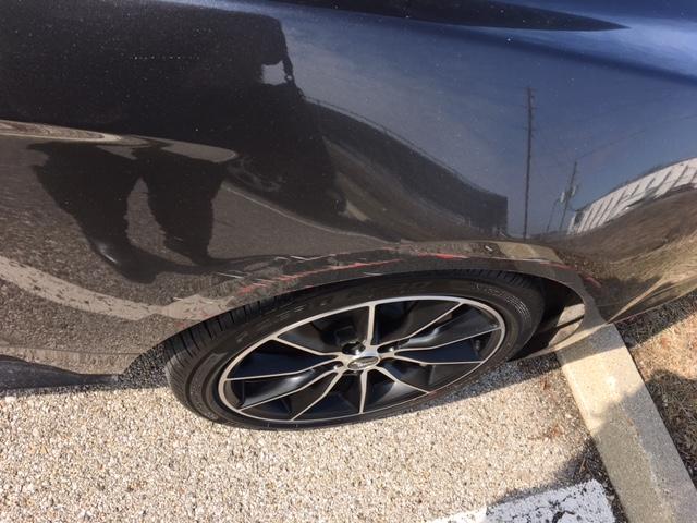

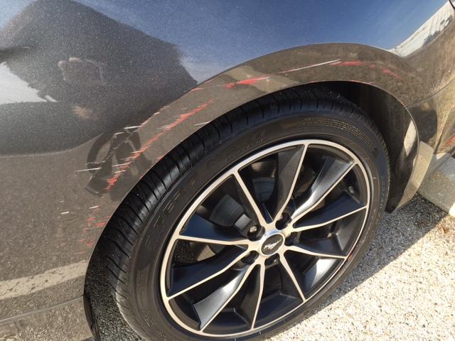

Got distracted in a drive thru, didn't see a low pole. :frusty: There is a shallow dent as well as the scratches. I can scrape the red off with my finger nail, I'm not positive about the white... Any idea how much this might cost? It's magnetic, does it need to go to the dealership? Worth going through insurance?

Depending on how deep the white scratches are, if you have an orbital buffer and some compound you will be able to buff out most if not all of them.
You can try it by hand as well but it won't be as effective as a buffer.
The red will come off as well. Then you can assesses how much damage a body shop will really need to do.

PDR should be able to pull the dent out.

I must be blind because I don't see a dent lol! A DA, Buffer, or orbital with some good compound should be able to take that right out. If you don't have any of those, buy an applicator (Circular pad that you would use to put wax on) and Meguiar's ScratchX 2.0 at AdvancedAuto/AutoZone. Apply it to the applicator and firmly press against the scratches in a circular motion. It may take a while but it should get most, if not all of it out.

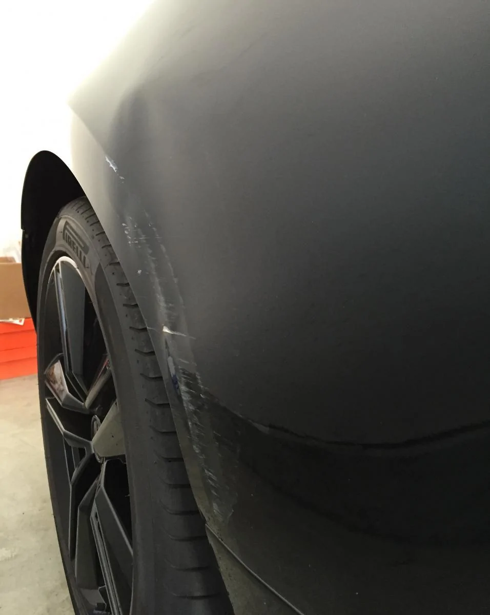

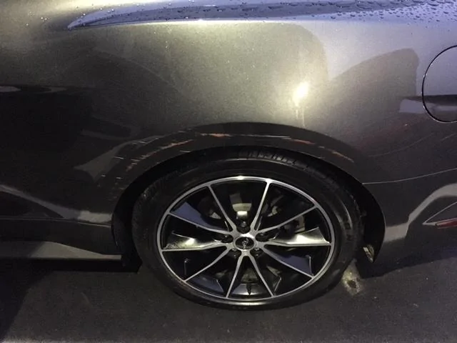

It depends where the dent is located. This happened to me last year. :doh: Collision shops and dealer charging me between 1300-1600 so i called my insurance and paid the deductible.

I'm pretty sure you'll be able to buff out the red - but looking at the pics, I have a feeling the "white" is the primer below the surface.
The factory paint jobs are very thin and there's not much between the painted layer and primer layer anymore like vehicles of the past that came with thicker factory paint.
Post up your cleaned up results. Dr.Colorchip may work as a solution to going over any visible signs that remain, but from what I have seen, DrC is only very good for small chips and not meant for larger tasks such as at length damages.

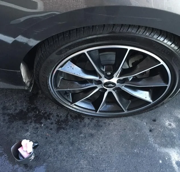

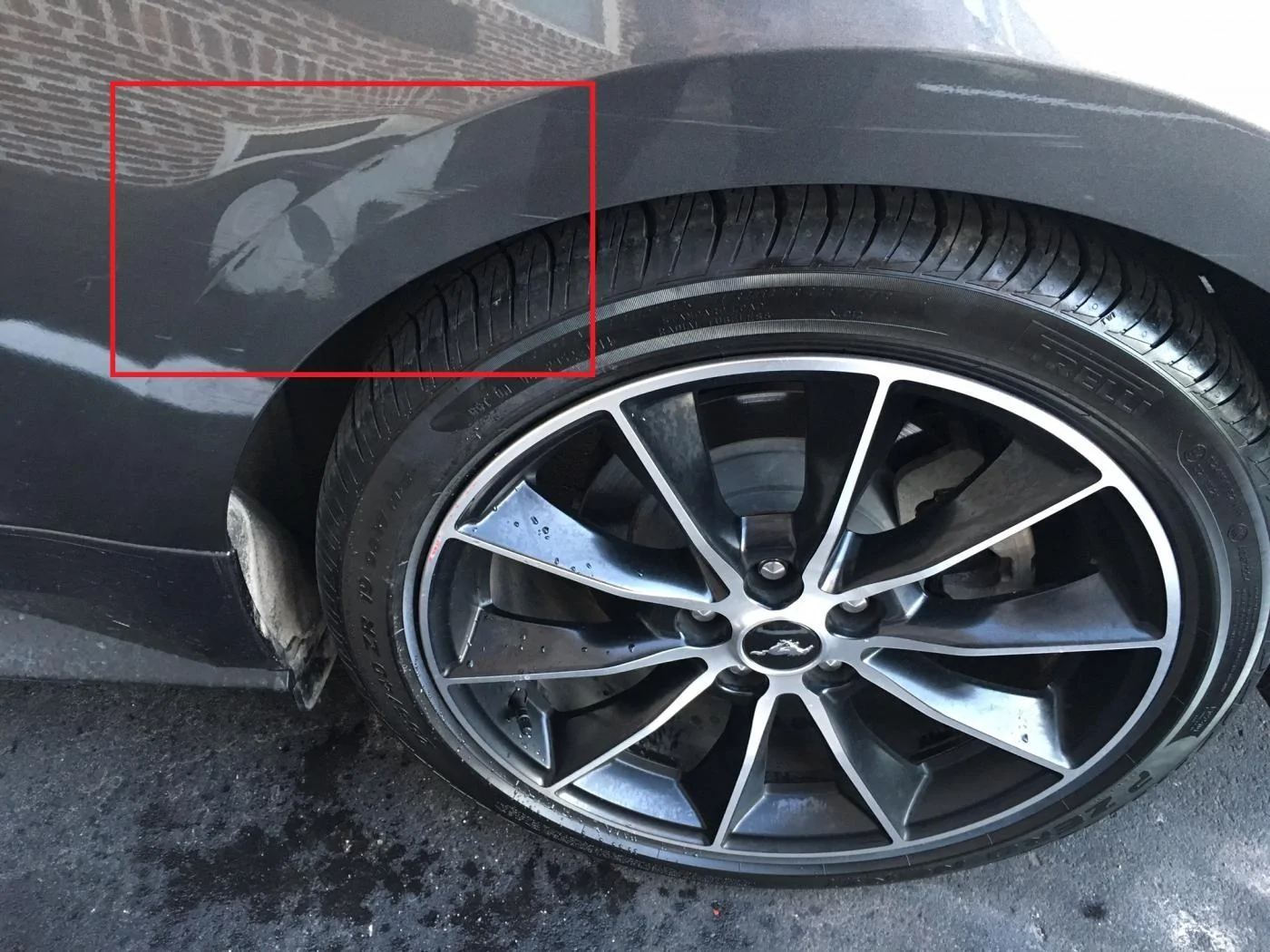

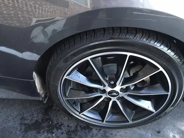

I got a tip to try a Mr. Clean magic eraser, which I tried since I already had one, and that took off the red and some of the white pretty easily. Here's what's left... Would PDR be able to take this out and then maybe have it buffed out somewhere else? I went to the website of a PDR place in my area and none of the examples were this close to the edge.

[MENTION=13979]Kudarat[/MENTION] Geez, looks a lot like mine.

I have used a great PDR guy in the past who had fair pricing and was able to get the worst of the worst out without any remnants of previous damage existing.
I would Google PDR businesses in your area and insert the word "review" after the business or persons name to see what other folks think of the work. Some even have pics of before/after of the vehicle - so you can judge how well the work was performed.
Damn - if all you used was a Mr. Clean Eraser initially, that seems to have worked well! If you have an orbital buffer, throw some Meguiars Ultimate Compound on it and go over the area and 3" beyond the area on all sides. That should remedy any remaining surface scratches in the clear coat. Then go over that same area with your favorite wax/polish.
I have used the MUC before / it is NOT abrasive like most other compounds on the market - it safe on all clear coated surfaces, works great and is very easy to apply/remove when in optimum temps. Try it out. I think you can get it from most local parts stores.
