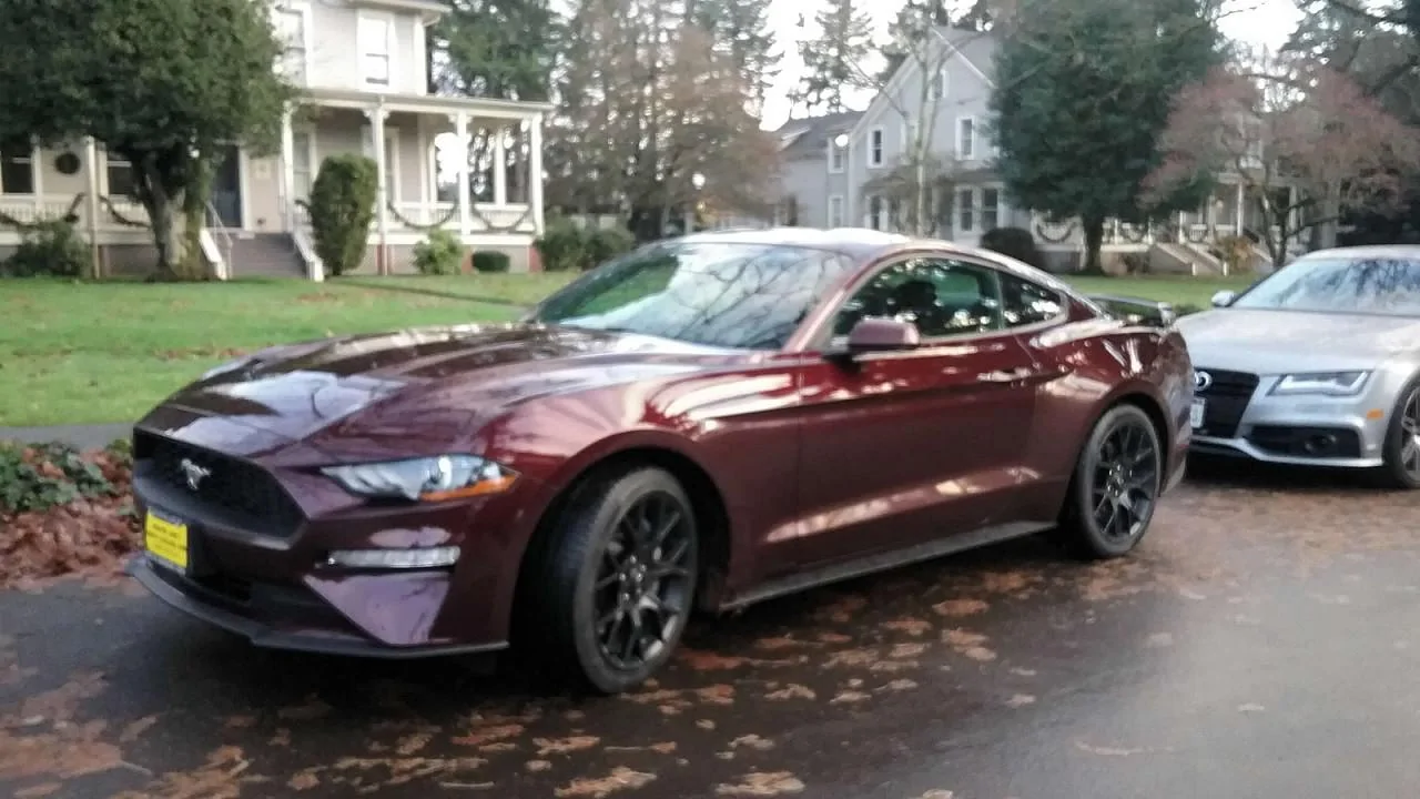

I can hardly wait to see how well the 10A behaves in regard to autocross relevant shifting control and speed. I'm particularly interested in whether this statement in the owner manual means what the words "seem" to say.
Dick, I have a 10A Ecoboost. The car holds gear fine as long as you're engaging with the paddles and the little number indicating gear is lit. If you're in D you can use the paddles but it resumes automatic up and downshifts after a few seconds. In S, it seems to be persistent as long as you use the paddle to select a gear right away (otherwise assumes you just overshot D on the shifter).

Yep, will prep it and see which wins. If EB is faster I won't let Mark near it.
Still have my Camaro down in Georgia, too, so covered either way!
No Magneride -- none on the ground in the NW, and with Konis so cheap it didn't seem worth it to wait.
As far as I can tell after a few hundred miles, it holds both second and third gears at redline without an upshift. Not sure of what issue you see in the owners manual text — that it won't?

Ah, I see what you mean. In Sport automatic mode, yes, the car does seem to hold the next gear at less than full throttle. Full test will have to wait for dry pavement (that is, April).
It also does terrific smooth little downshifts when you trail brake.
Mine's a no-options cheapie, just PP and auto.

Nice to see you post on here again, Des. Nice looking car!
