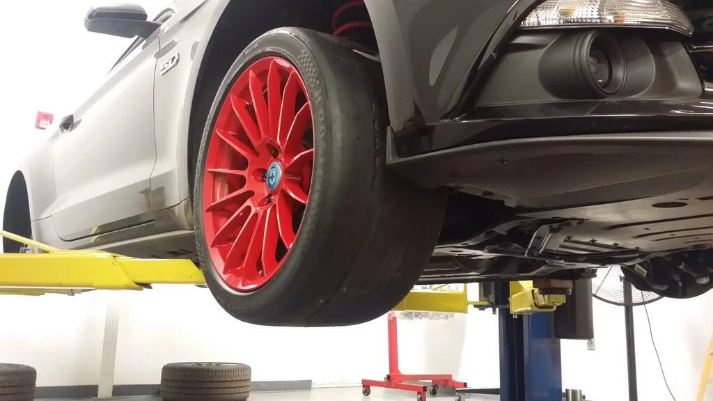

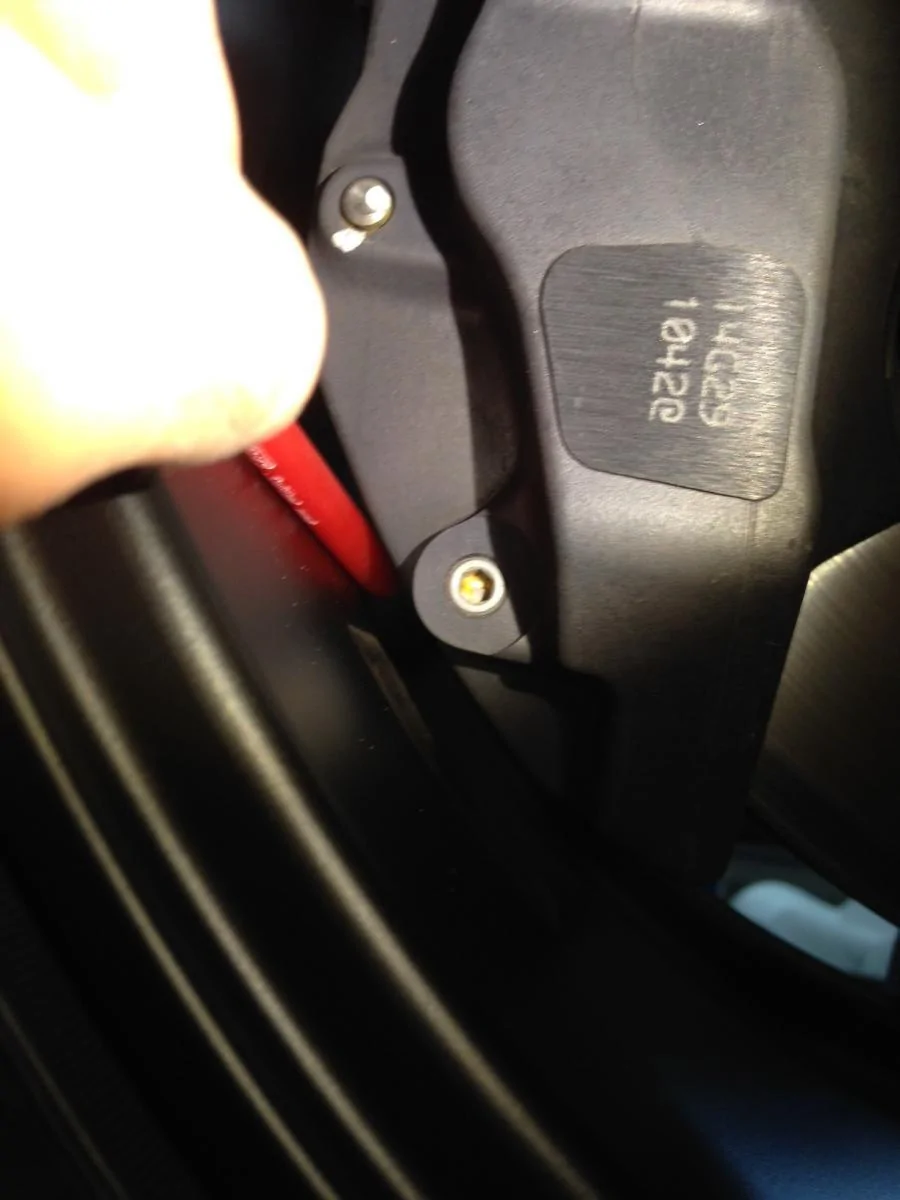

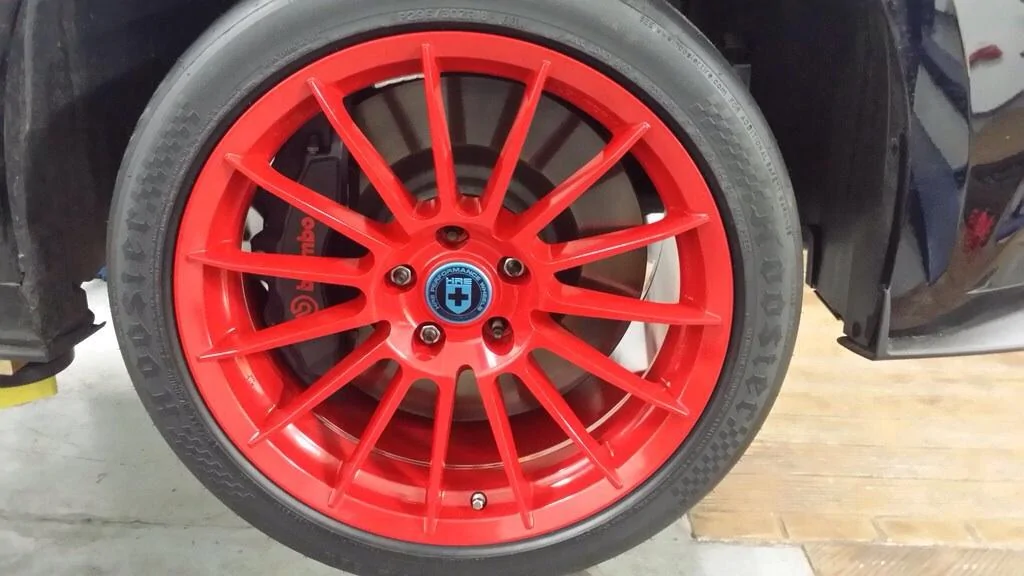

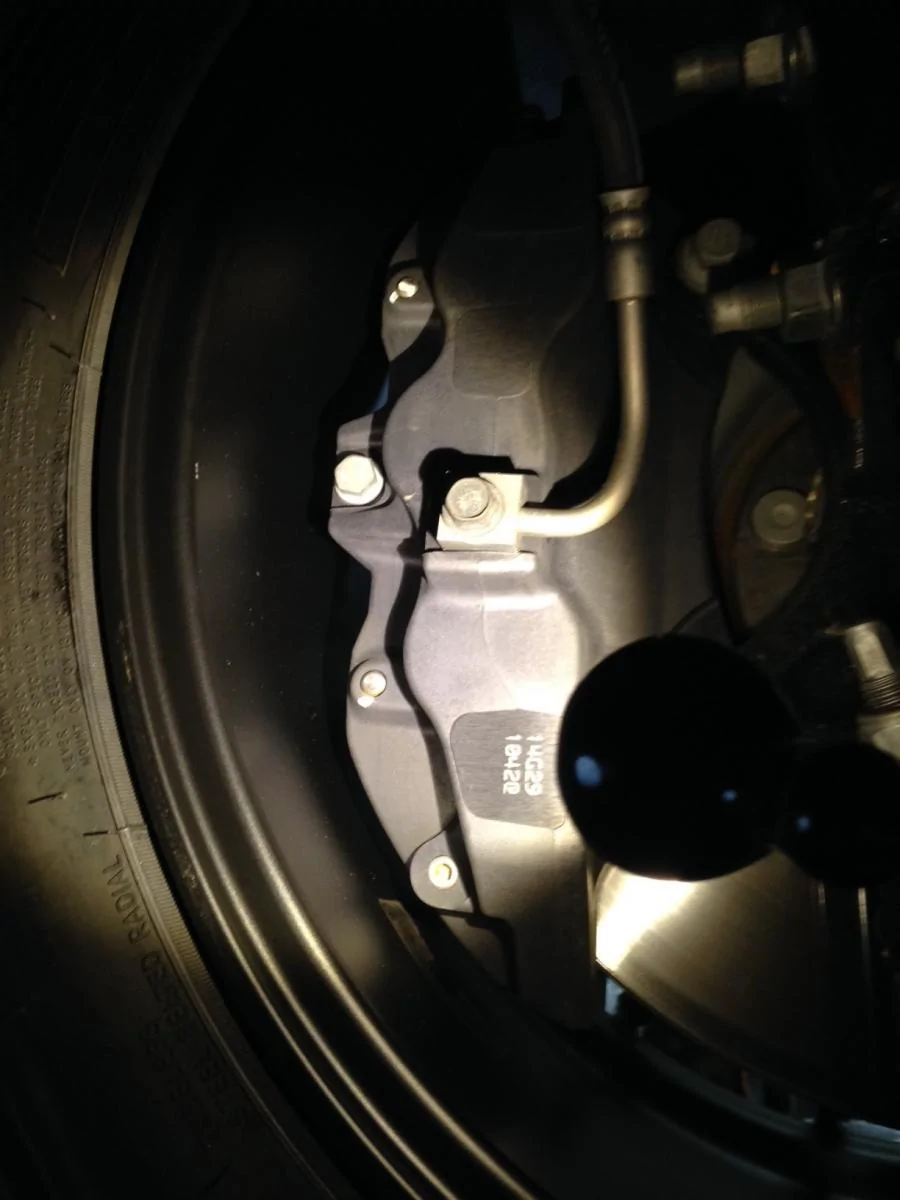

As far as wheels, you will see ours in a number of threads but I will re post here. We have 18" in our FF15 made specifically for the Mustang and made specifically to clear the GT PP 380mm 6POT Brembos. They are competitively priced with other top tier flow flormed wheels from Japan and Europe like BBS and Rays.
The 18x10 and 18x10.5 are only 21 lbs and 21.4 lbs.
You can see the clearance from a couple of these pics and I also included BMR's GT PP with the wheels on.
We also of course have 19" and 20" Mustang options as well.
