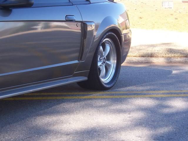

I would stick to the OEM size tire for the OEM wheel. If you want wider tires, get the proper size wheel. Don't be this guy:
