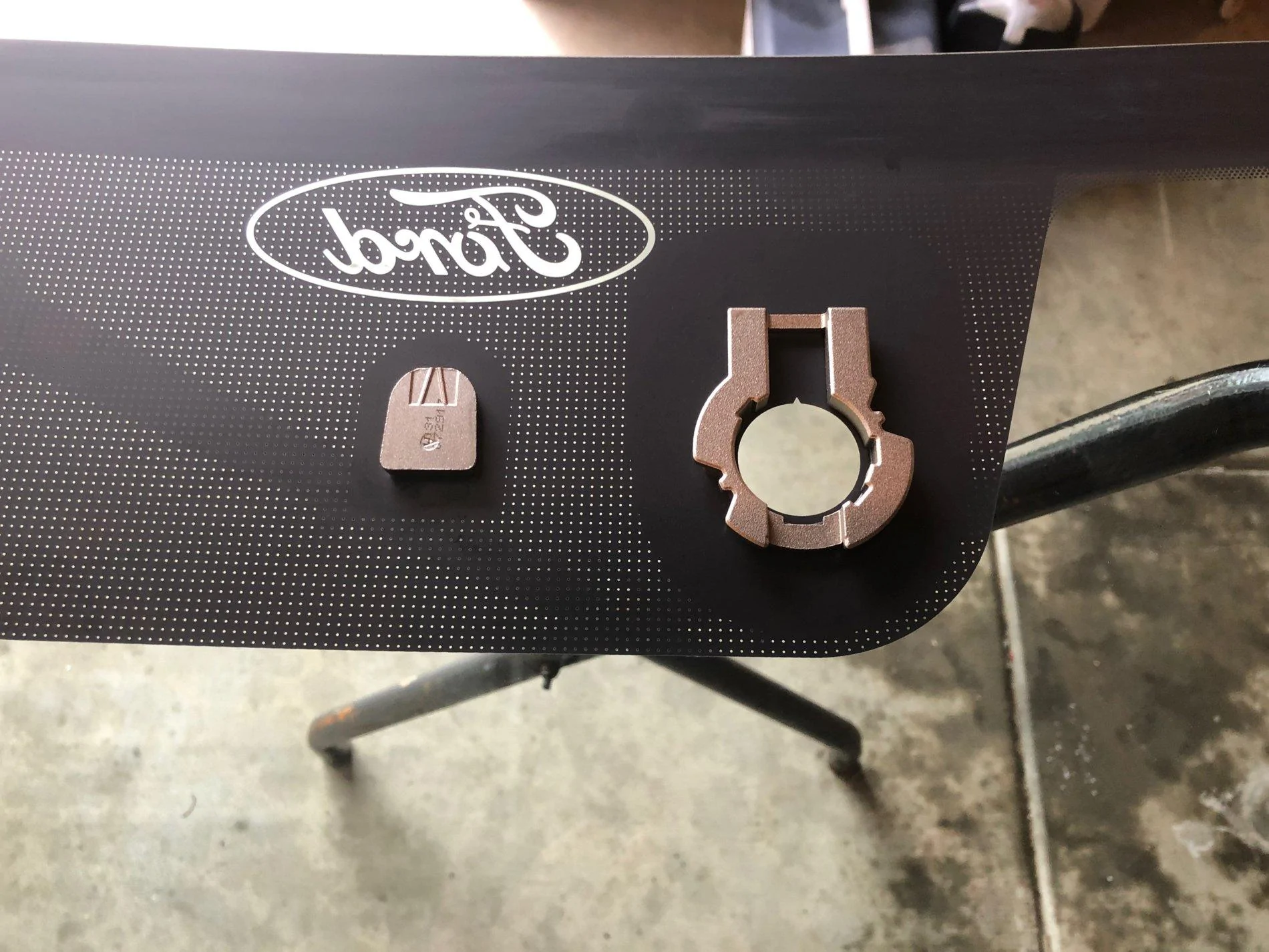

I don't have safe and smart but I do have the rain sensor. This is what the inside of the glass looks like from the new windshield. They will reuse your sensor and add a new gel pad unless you buy a new sensor.

Thanks. I wasn’t sure how it was all attached to the windshield. I assumed because of the price I’m paying for the glass over here it would have included the sensors. I’ll know more Thursday.
