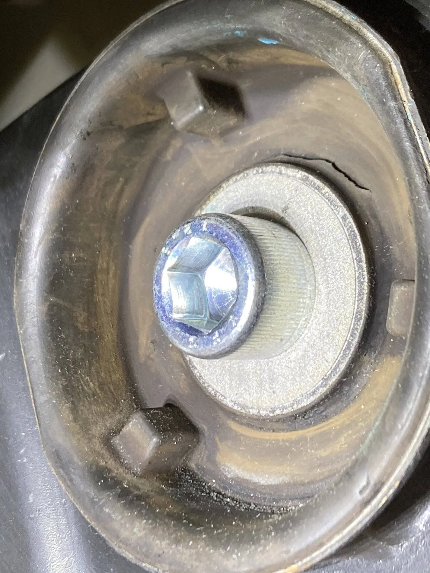

At least sleeve the bolts if you do nothing else.
I sleeved mine and used construction adhesive to fill the voids on the bushing. You can see one of the sleeves here.

I just looked at it again and the tear is bigger than I thought. It goes from the right side across the top of the metal sleeve in the bushing, but doesn't reach the outer shell (race?) of the bushing.
I'm out of warranty so I'll be doing most the work myself. I hear you on the inserts, that would definitely be easier, but I'd rather just do it once and be done with it. The suspension is already apart, so it would be easier to replace them with new bushings now rather than pulling it all apart again later.
The flip side is if I put inserts in and hate the NVH I can just pull them and sell them on here, and invest in a new subframe to get back to stock NVH levels.
Ford is really milking us by not offering a simple rubber bushing replacement. This car is my first and definitely last Ford product.
back to topic - that image, the bolt seen there - that’s not factory right? Could it be possible the tear is caused by the type of bolt being used? Meaning, the shank of the bolt may not be filling the shaft void, which allows more flexing than what is allowable for the bushing?
I just put the bolt in. It’s the lethal extreme diff bolt kit, with the sleeve insert that removes the factory void. I haven’t driven the car since putting that bolt in (been in the air on jack stands for a few weeks) and I don’t think it was caused by that.
