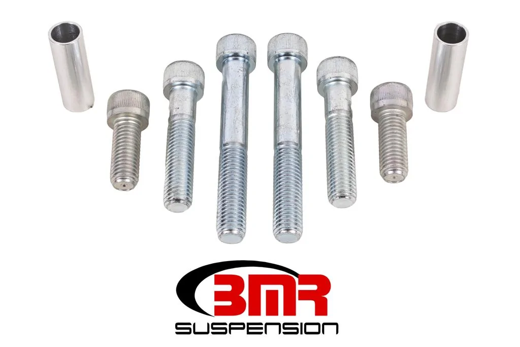

Here is our RH017 Differential Hardware Upgrade Kit.
This kit has zinc coated Grade 12.9 Hardware, as well as CNC Machined Billet Spacers to take up the slop in the bushing mounts.
This kit is aimed at being the best bolt upgrade for stock, BMR and other bushing inserts or lockout kits in high performance applications.

Here is the link for the upgraded hardware kit with billet rear bushing inserts.
You can use the code FS6KA to purchase them from this link ;)
http://www.bmrsuspension.com/?page=products&productid=1764&superpro=0
*This specific RH017 Kit works with the BMR BK051 diff insert kit, and should work with other available insert or lockout kits.
*RH018 for 100% stock bushings will be available shortly.

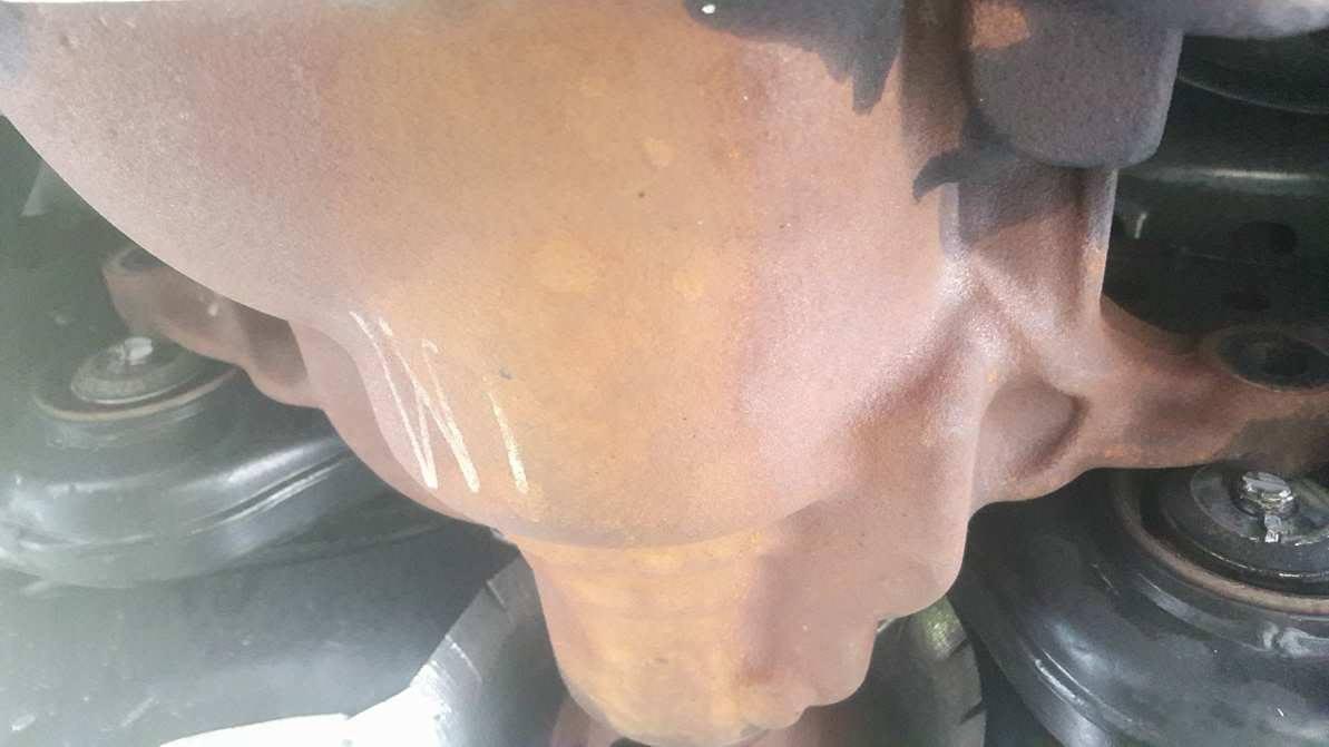

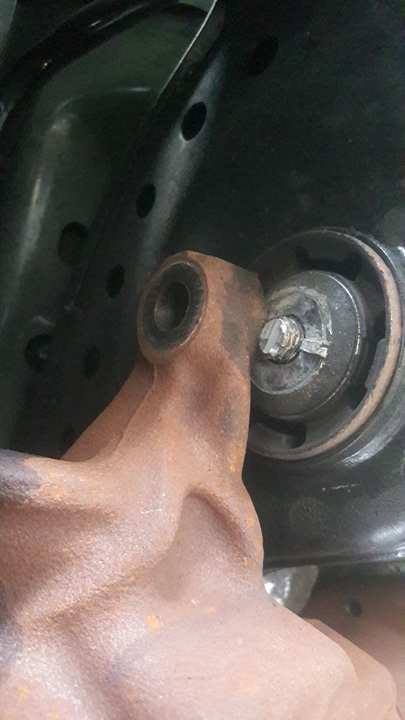

More diff bolts bite the dust. Local friend of mine had this happen on his Whipple S550. Luckily I was around, and had some goodies in my garage to get him on his way.
This was a non-BMR brand billet diff insert kit. The car does not have any BMR components on it. Yet anyways.

I got him setup with a set of OEM driveshaft bolts (F&R) last night so he can get the car back on the road while getting this all resolved. He's lucky to have friends like you and I ;)

Our RH017 Bolt Upgrade Kit has been installed in over 100 vehicles now and we have not seen a failure yet.
I would not say it is impossible to bend or break the RH017 kit, but I will say that people have replaced their broken parts for this kit and have experienced them (RH017) hold up to more abuse. ;)
http://www.bmrsuspension.com/siteart/install/RH017.pdf
Also, for those not using our kit - but are using another brand or your own DIY....please make sure to use Blue Loc Tite AND use the method below if using an allen key tool.
NOTE:
An Allen wrench (vs. Allen socket) may be necessary to clear the CV shaft. If using an Allen wrench, turn wrench 90 degrees (or ÂĽ turn) after the lock washer is flattened
