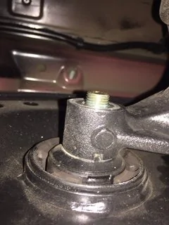

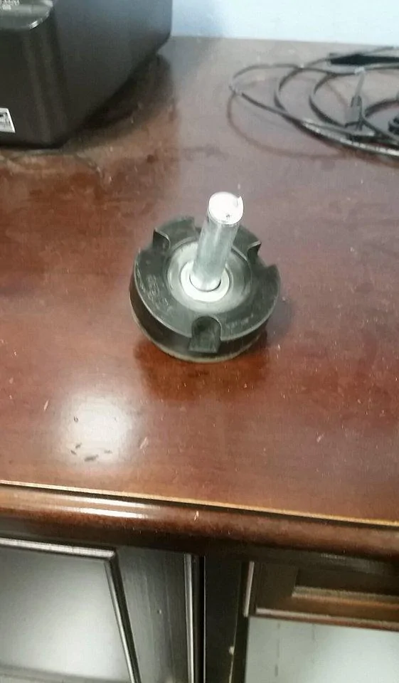

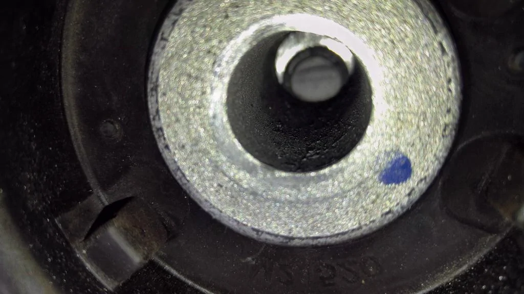

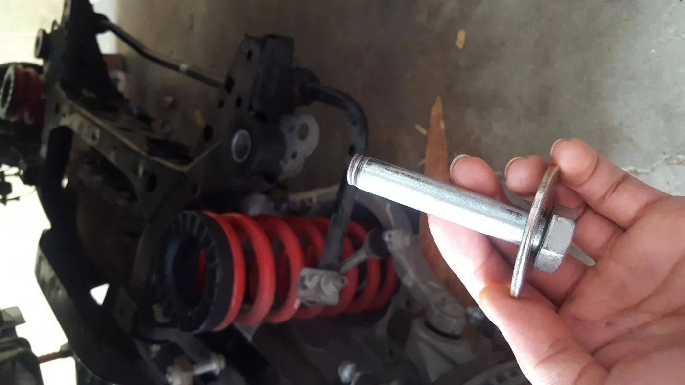

12.9 - 14mm and drilled and installed the 9/16-18 x 4.5 bolts.

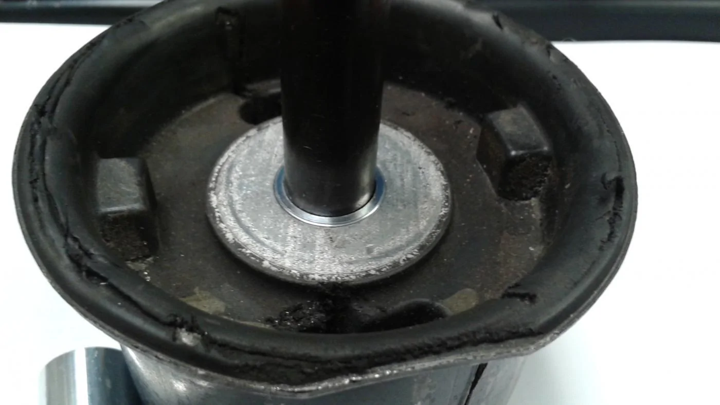

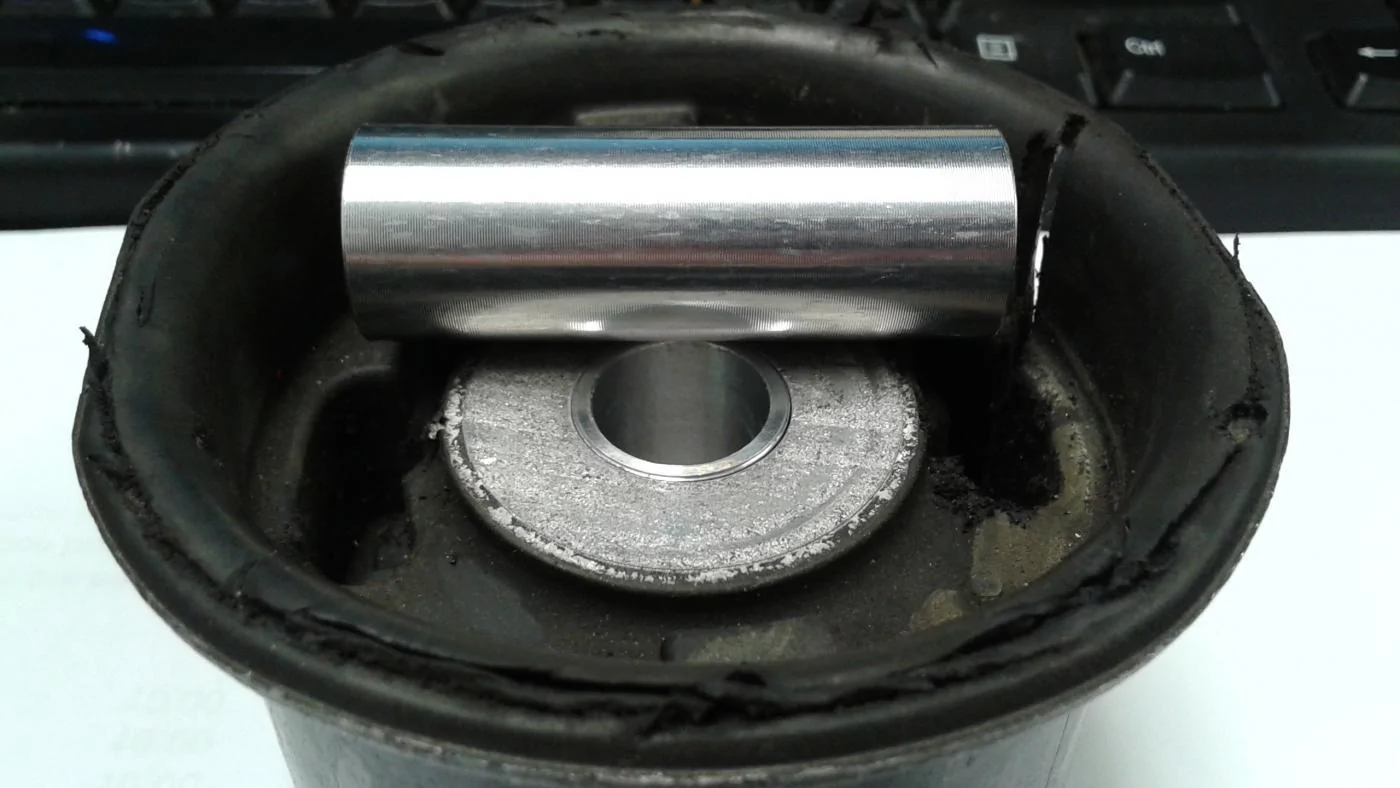

I have the Steeda inserts and the 4.5" bolt length on the 9/16, seems like it is not enough( probably the Steeda's inserts are thicker)
Ordered some 5" to replace the bolts.
Torqued to 130 (should it be higher?)
