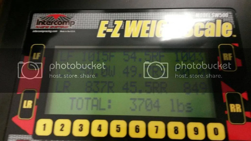

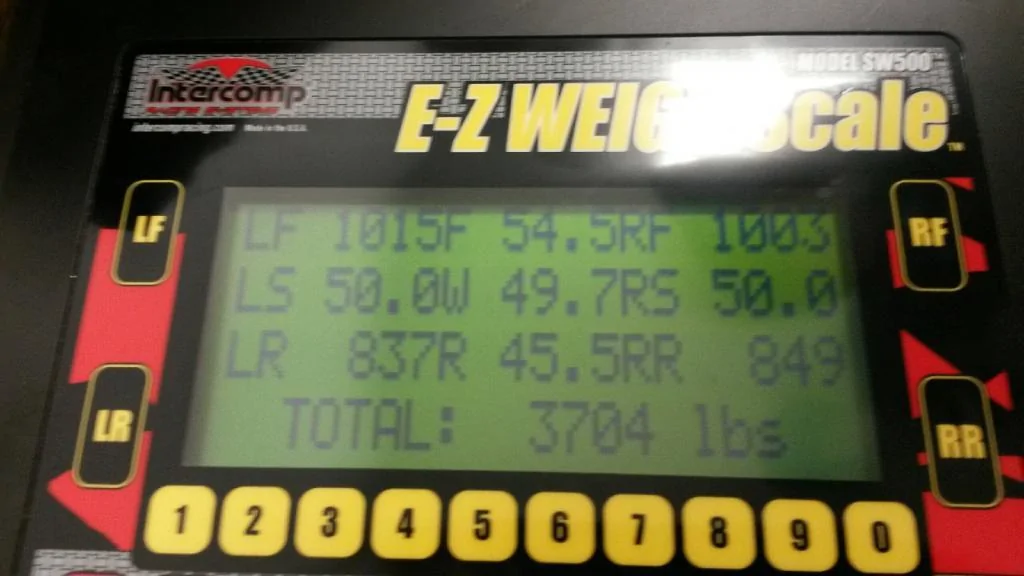

As you can imagine, this was the first thing we did when our cars were delivered. Anyone (company) touching the chassis/suspension....hopefully did/does the same.
Base Auto, with completely full tank, as it came from Ford:

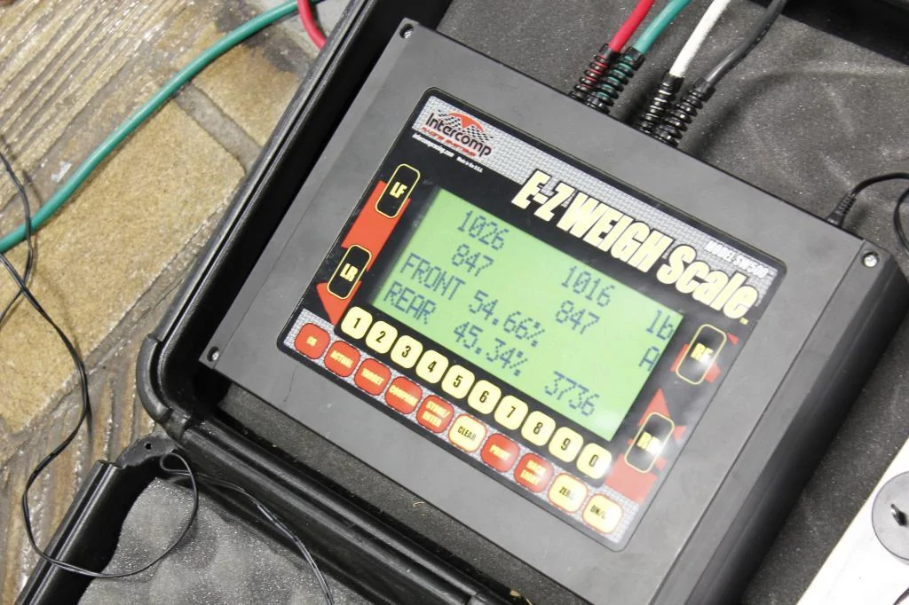

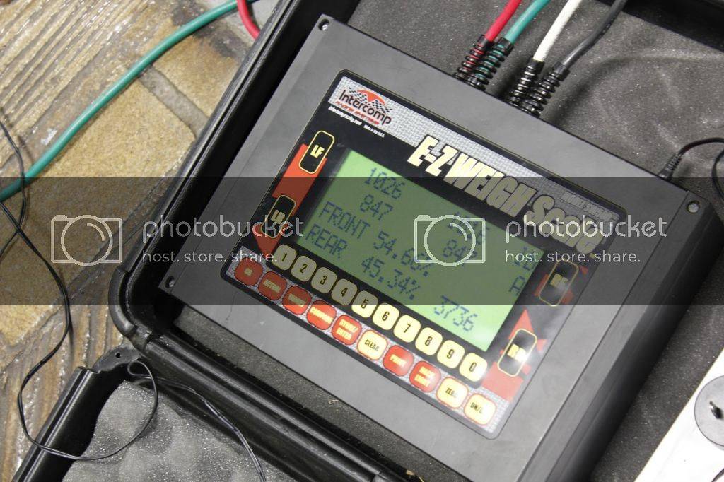

Performance Pack, full tank, as it came from Ford:
So - they average on the Manual, and Auto:
54.5% Front
45.5% Rear
54.5% Front
45.5% Rear
Reviving an old thread here...
were these specific weights of the car? If so, are these pictures located anywhere else since photo bucket is dead? Also, have you guys done the same for a 2018 yet? [MENTION=9985]BMR Tech[/MENTION]

[MENTION=24829]jake_zx2[/MENTION] here you go

Very frustrating.
Its hard to understand why they didnt reduce front overhang and move wheels forward to get better weight distibution.
PAE car attempted this.

[MENTION=28654]Nagare[/MENTION] what models and options were those 2?
Says in BMR's post, top is base auto, bottom is PP
Same as what Jake just said, I just saved the photos that were already showing for me (I use an extension) and uploaded with the forum uploader.
